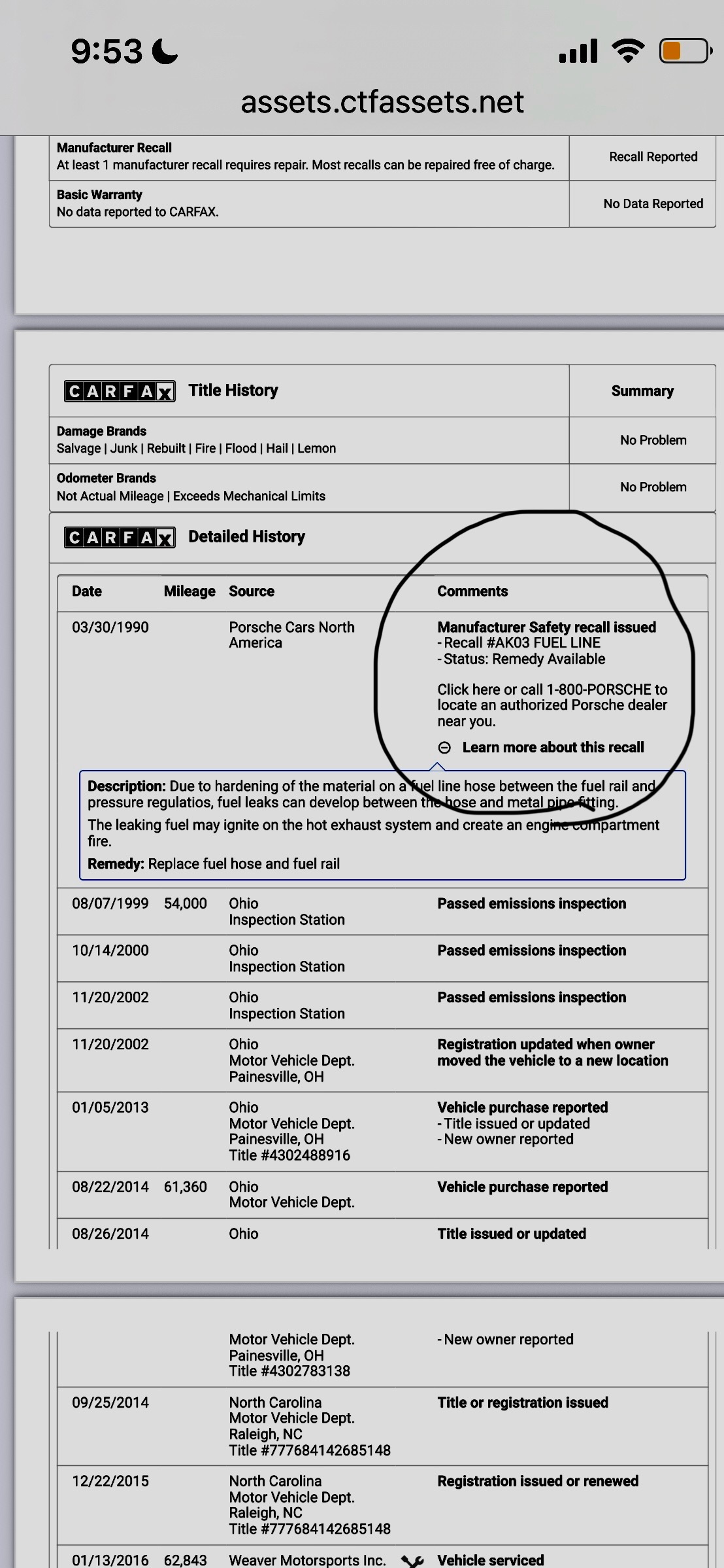

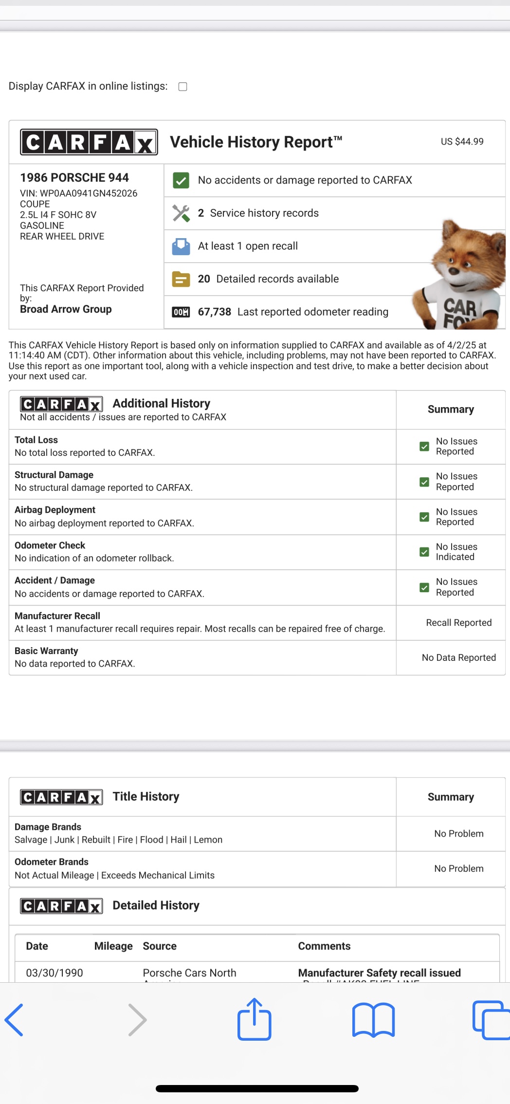

I saw this on a FB forum and looks legit. The Carfax report is dated 4/25.

Doing a limited bit of "googlefu" it appears that's from the early 90's.
I'd be really curious if it's still active. It'd be great if it was.
Edit...
My apologies, I didn't see your last picture. It seems it just my be.

Safety recalls do not expire... You can check your car with the NHTSA website...
https://www.nhtsa.gov/recalls?vymm=wp0zzz95zgn101907

gb951 wrote: Fri Nov 28, 2025 11:40 am Safety recalls do not expire... You can check your car with the NHTSA website...
Zero open recalls for my 89 turbo in the US.
