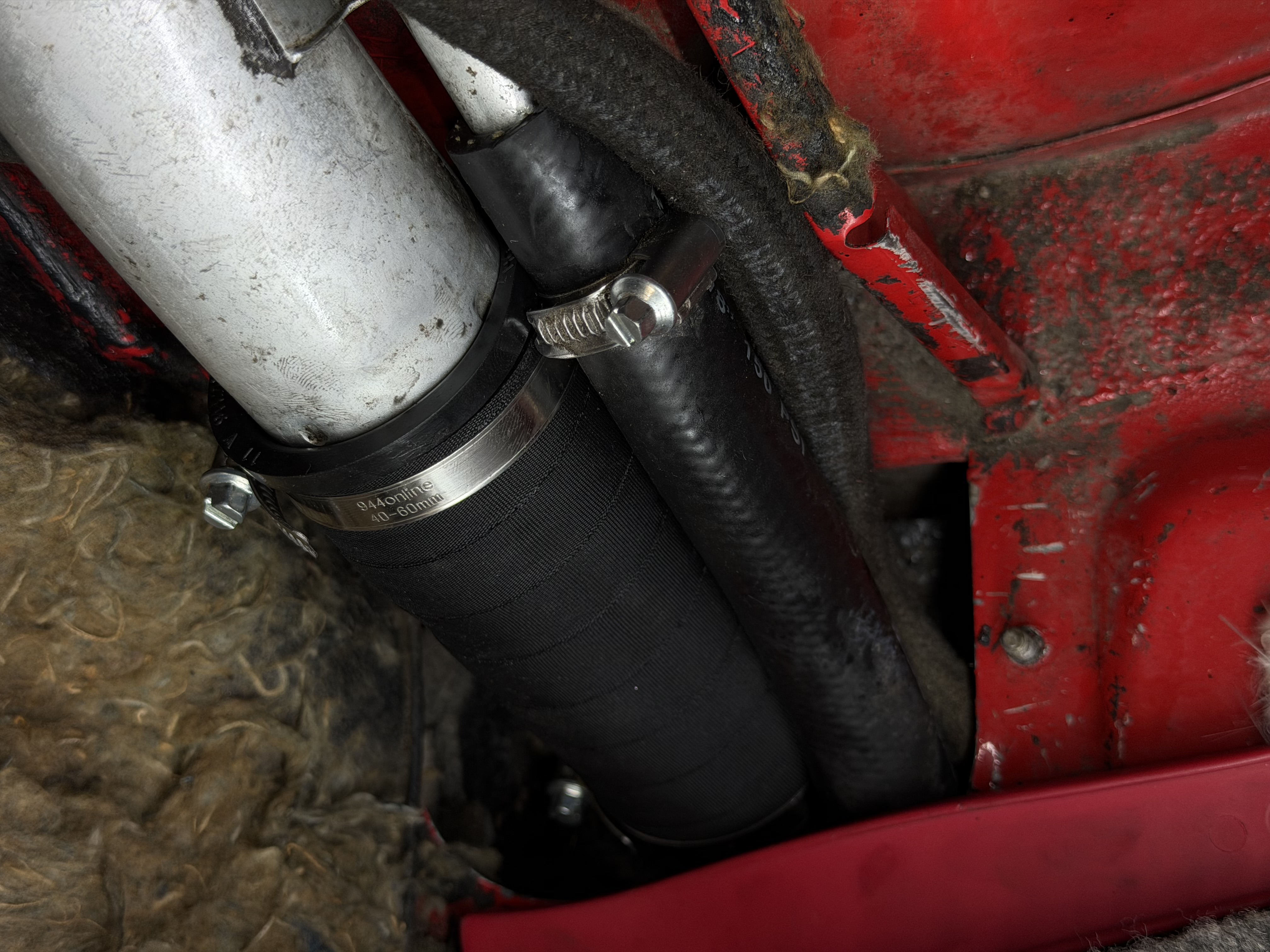

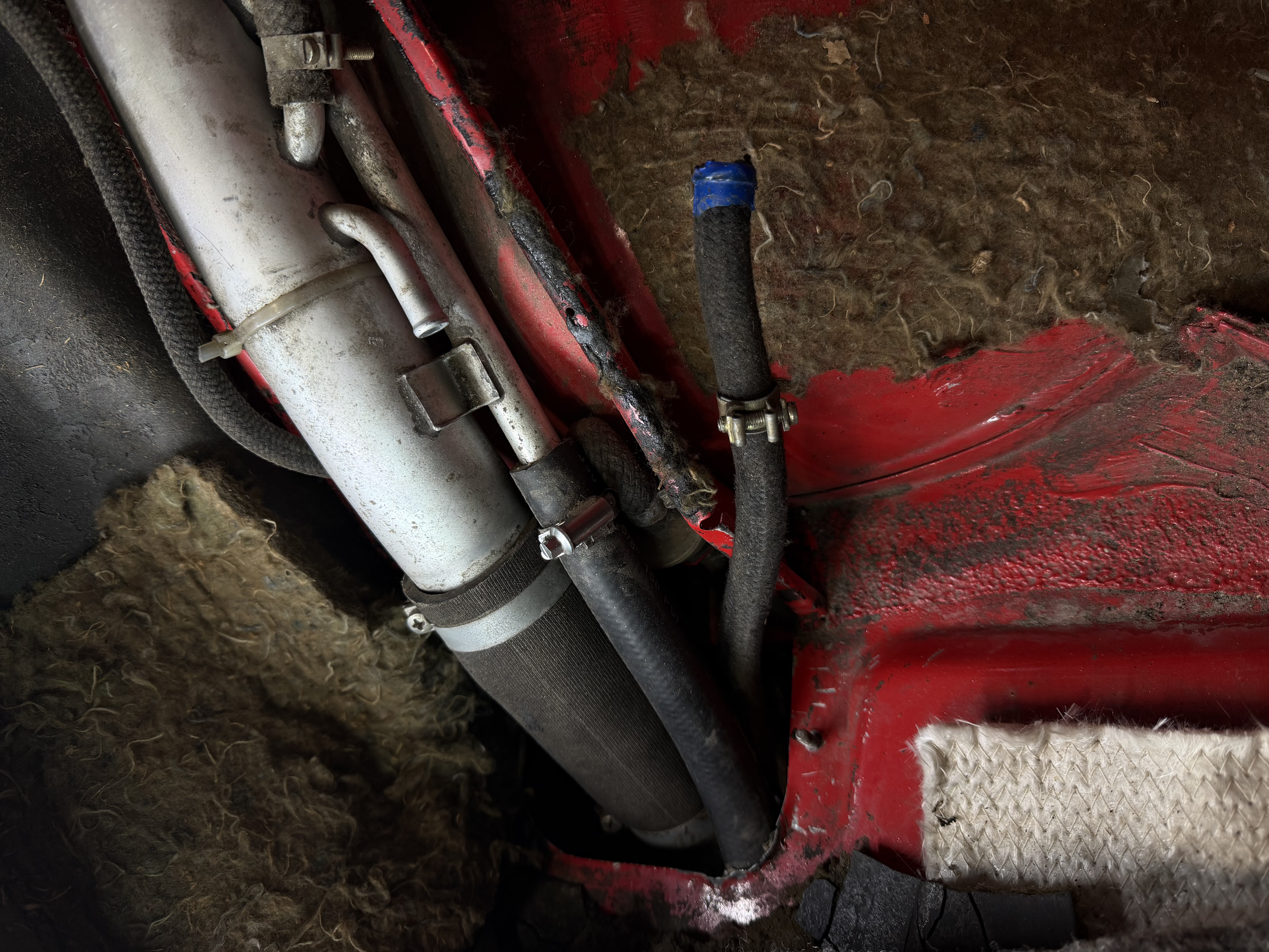

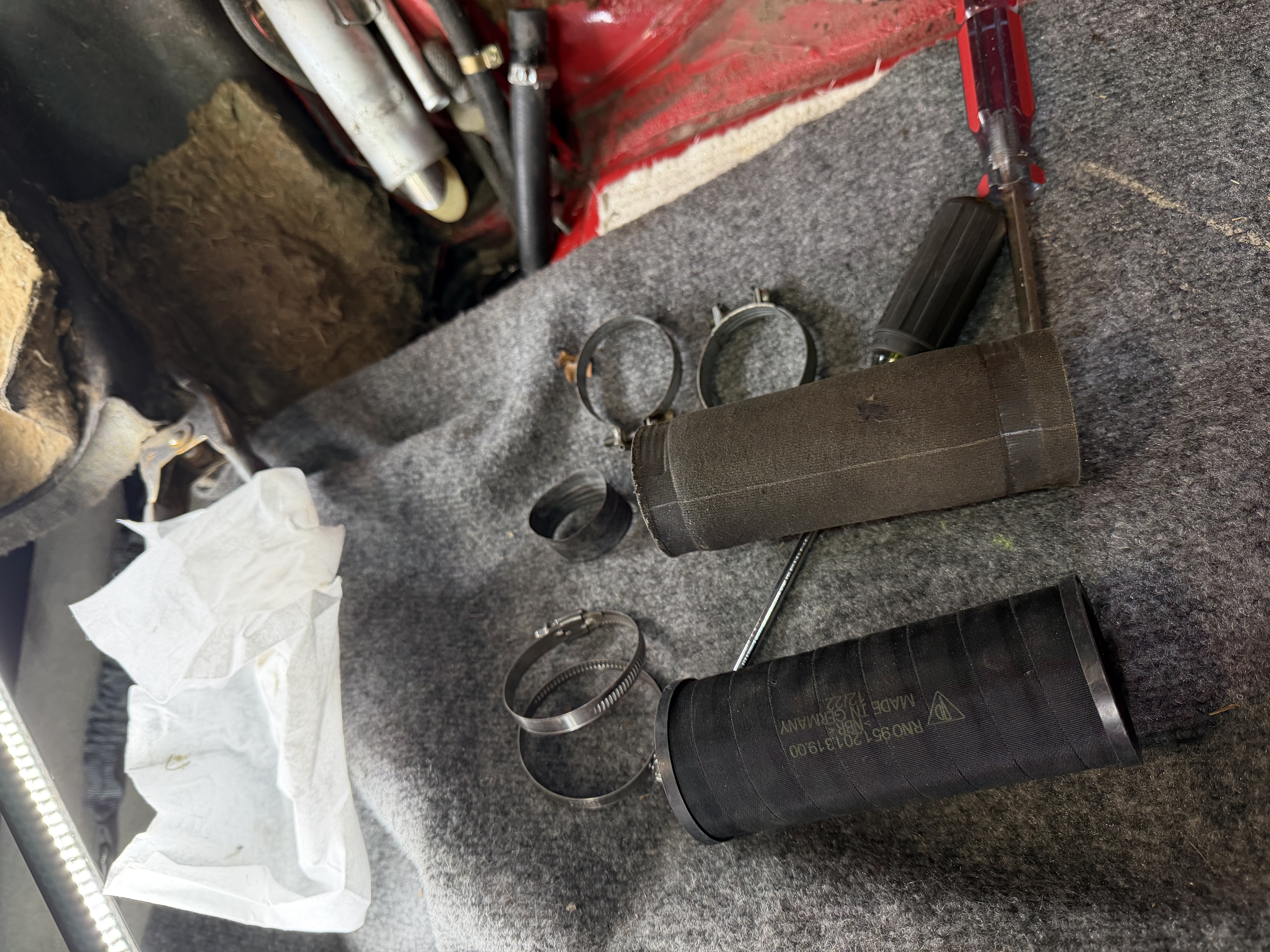

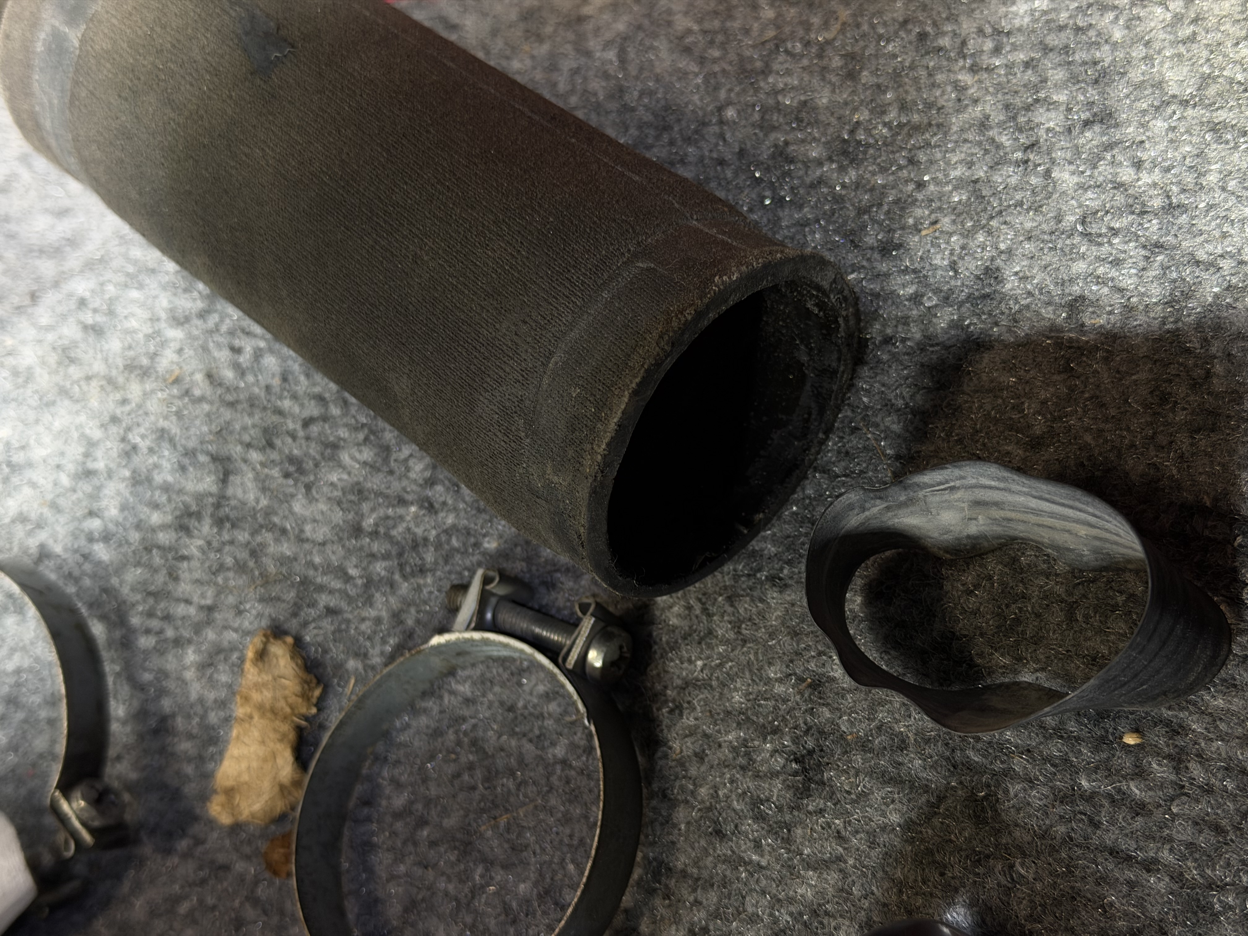

I had the issue where I would smell gas as well from the rear. It didn't actually spill over under the car until I finally filled up the tank full when going through the mountains in GA/NC.. at a stop in the top of the mountain there was a steady trickle of gas.
I think it was from the fuel filler hose bottom rubber sleeve ( there are two ) being totally absent. I replaced it but really haven't put it through all the tests. I did have the tank out previously and at the time didn't know it was missing.. But I did see the leak in the area where the fuel filler hose met the tank (where NC944er mentions) ... and the old top sleeve was pretty useless per the picture.
It does sound similar in that it didn't smell very bad until I filled the tank more full than 3/4...
hope it helps..
