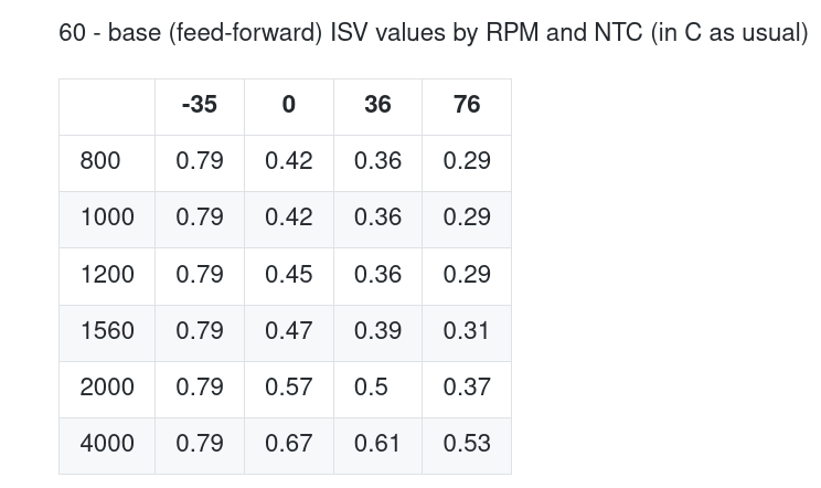

Its approximately 87HzTom wrote: Tue Nov 11, 2025 8:40 pmDo you happen to know the frequency of the PWM -- I'm tempted to check how open/closed the valve actually is at 30%...johnb wrote: Tue Nov 11, 2025 8:33 pm It should be close to 30% when up to temp, since that's the duty cycle when closed loop control is disabled.
Where to look next? Feedback/advice?
Some more info...here's the open loop PWM map. Weirdly there does appear to be different versions of this in different bin files but I'm not sure why. Anyway the map I showed at the end of this[1] is the more sensible looking one:johnb wrote: Tue Nov 11, 2025 8:42 pmIts approximately 87HzTom wrote: Tue Nov 11, 2025 8:40 pmDo you happen to know the frequency of the PWM -- I'm tempted to check how open/closed the valve actually is at 30%...johnb wrote: Tue Nov 11, 2025 8:33 pm It should be close to 30% when up to temp, since that's the duty cycle when closed loop control is disabled.
When not at idle, this map fully determines the duty cycle. When at idle, this is the base value that gets modified by the closed loop logic to try to keep the idle at the target rpm.
[1] https://jhnbyrn.github.io/951-KLR-PAGES ... utine.html

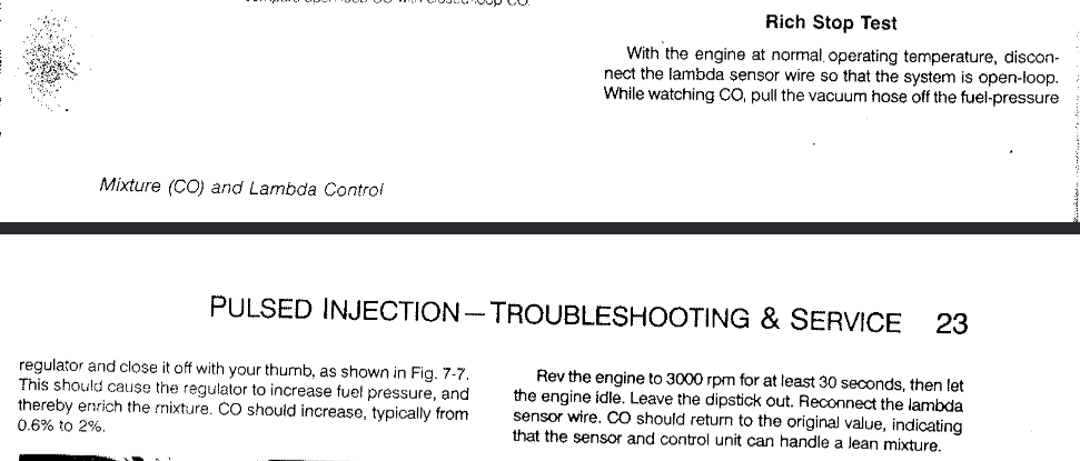

It was this post in the thread maybe, where I mentioned a higher idle, 1800 with TPS disconnected and "surging", which must have been "bouncing off the cut off"?spacecad3t wrote: Sun Nov 09, 2025 5:28 pm Updates...
- Disconnected TPS, idle goes higher, 1800.
- Disconnected ICV, no change.
- Open the bypass screw, eventually causes the car to surge very badly. This never happened before actually... I could open the bypass alot and it would just rev.
- I pulled the TB again... Seal does not look pinched, no bolts were loose. (photo)
- I swapped to another TPS that I have. No change, 1400 idle.
- Put a vac gauge on it... 18-19
Somehow I introduced a-lot air since changing my o-ring.
Also, I was reading this interesting book... and noticed in the troubleshooting section it mentions increasing fuel pressure by blocking the FPR vacuum port.
What I meant was that if the engine is running above the fuel cutoff rpm threshold, and the throttle is closed, but fuel is not being cut, then the TPS is not working. 1200rpm is the point where the fuel is turned back on after the cut, but it might be necessary to go higher than that to activate it. It sounds like it doesn't matter though, if you are able to get it to idle correctly without the ISV. Sorry if I miss stuff you covered - it's hard to keep track of everything.spacecad3t wrote: Fri Nov 14, 2025 6:19 amIt was this post in the thread maybe, where I mentioned a higher idle, 1800 with TPS disconnected and "surging", which must have been "bouncing off the cut off"?spacecad3t wrote: Sun Nov 09, 2025 5:28 pm Updates...

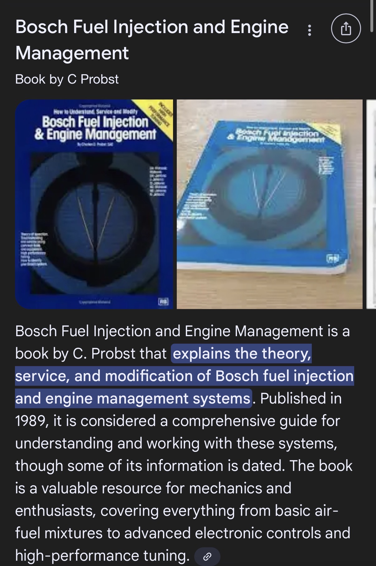

That's a really interesting book though. Do you know the title/author? The pdf seems to go straight to the contents but I would love to track down a hard copy. I didn't know books like that existed.
spacecad3t
- Posts: 290
- Joined: Tue Oct 14, 2025 4:54 am
- Has thanked: 86 times
- Been thanked: 71 times
I think it's the PDF of this book. I just googled this book +pdf and found that link.
