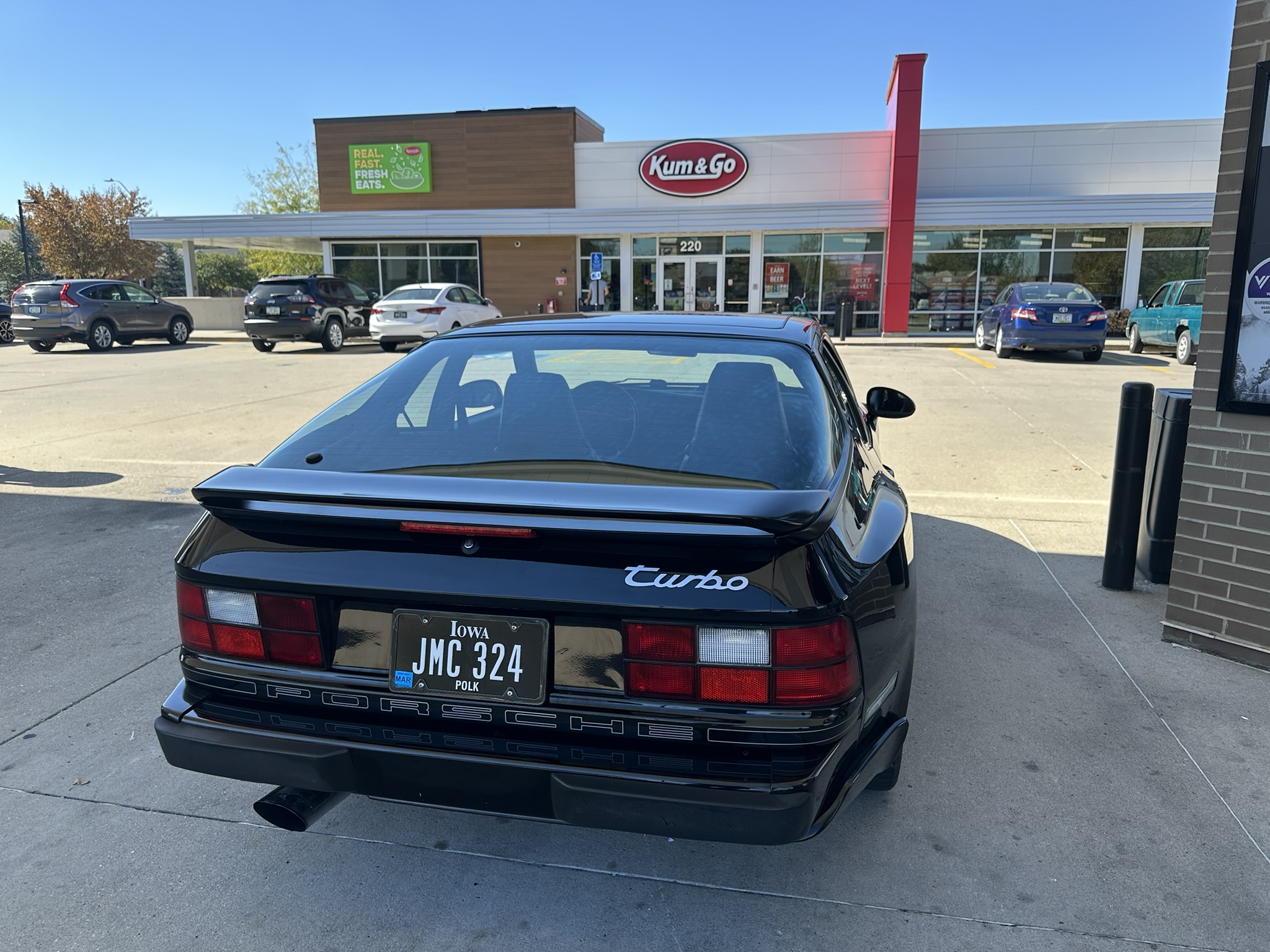

After 3+ years I finally got the car on the road again. I purchased it in summer of 2020 and blew the head gasket the next year. And in the middle of a home remodel, it didn't get touched for a while then work was slow.

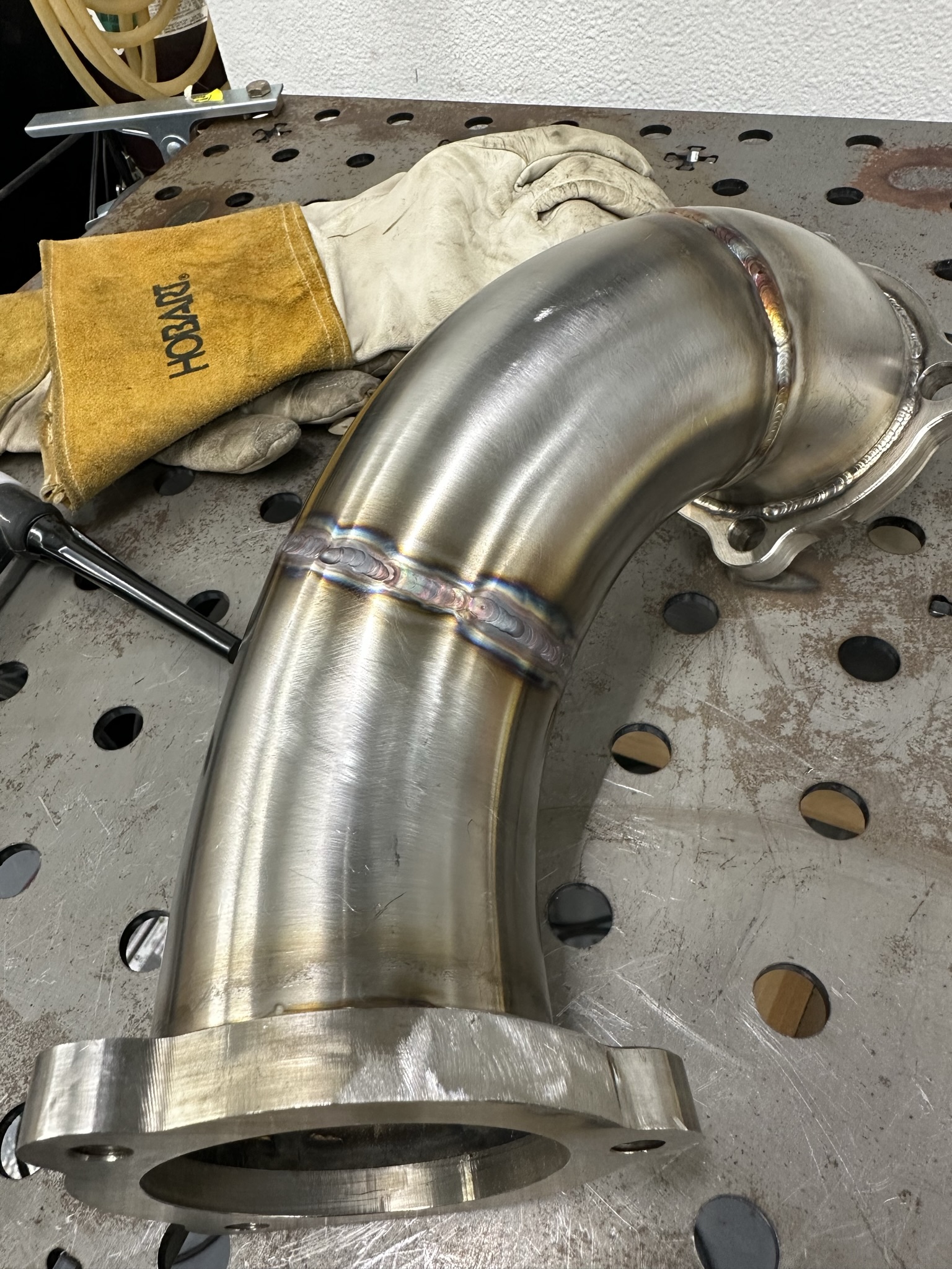

Welded up a new 3" downpipe

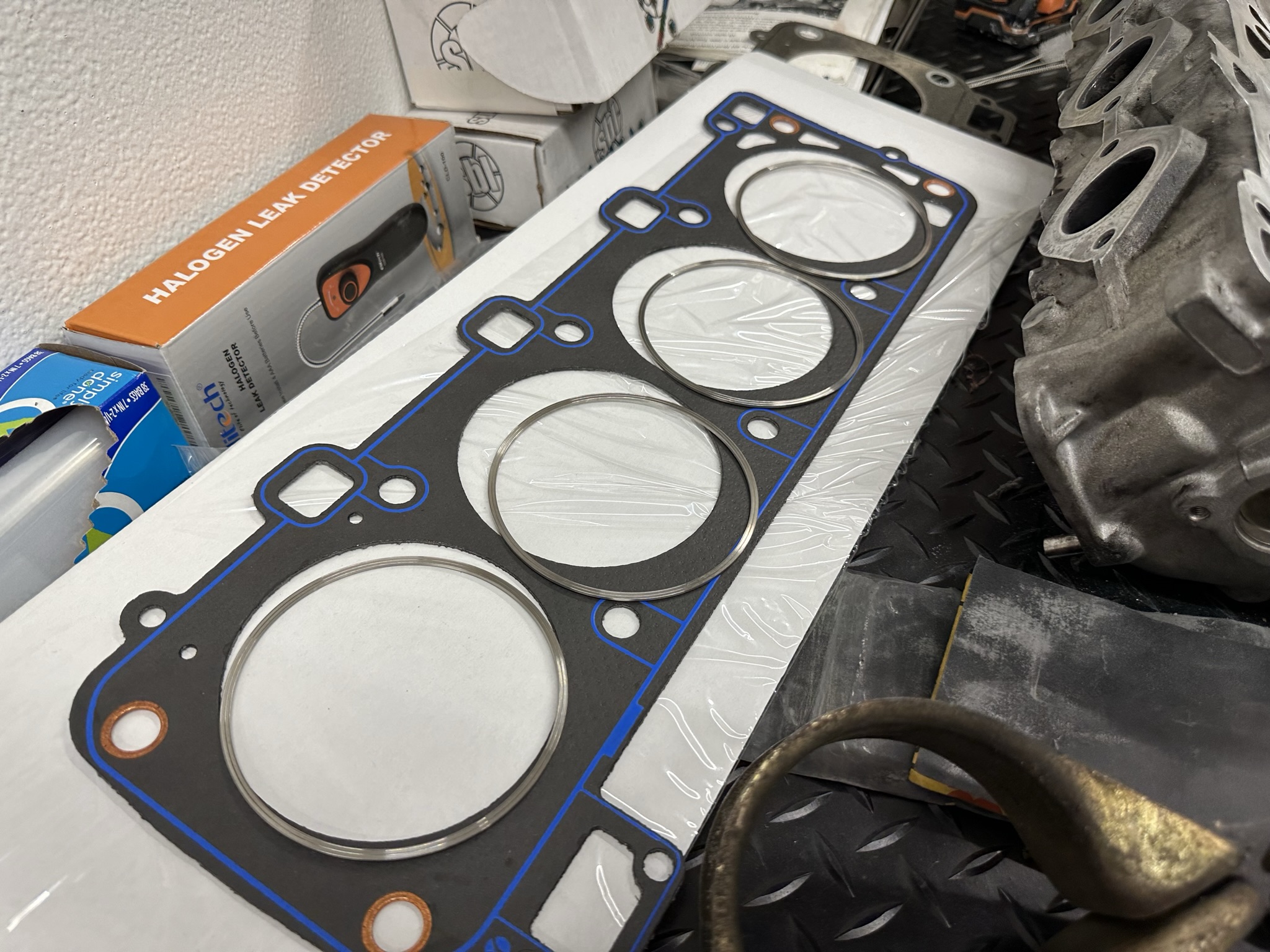

Installed a new SCE gasket

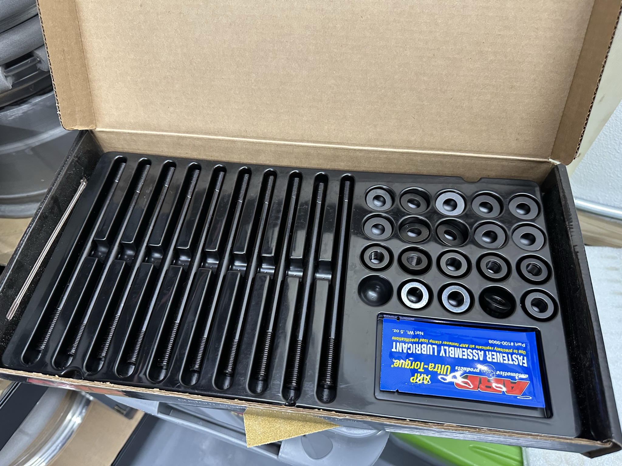

Installed some ARP studs

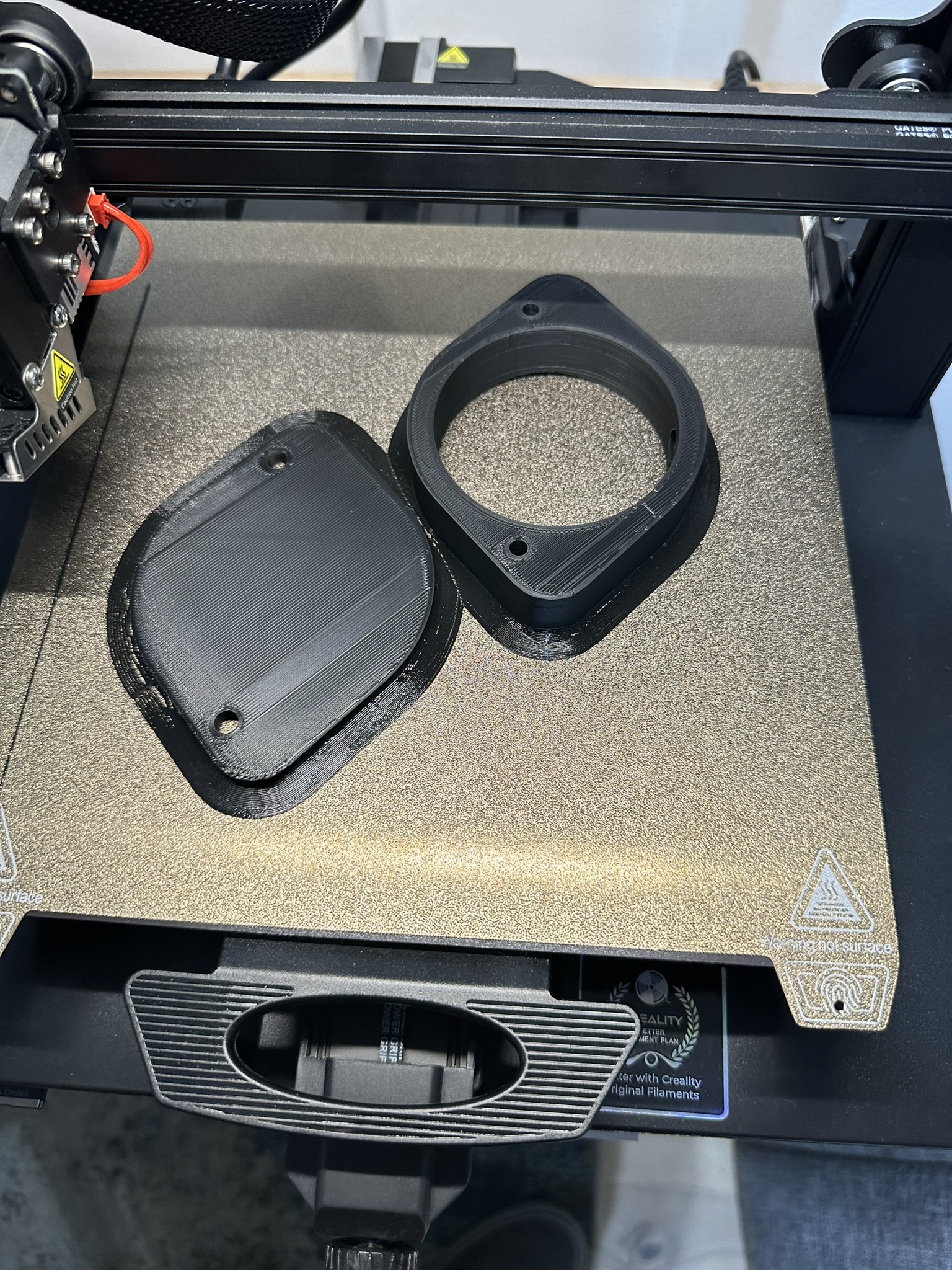

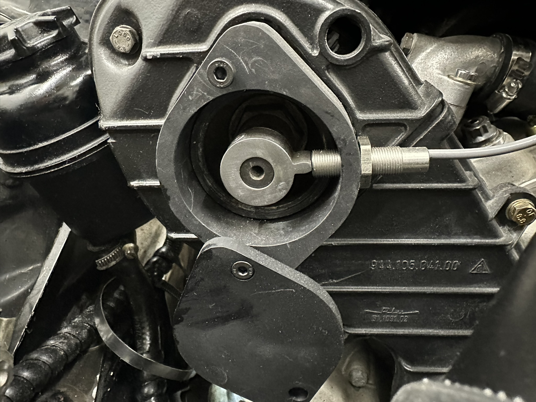

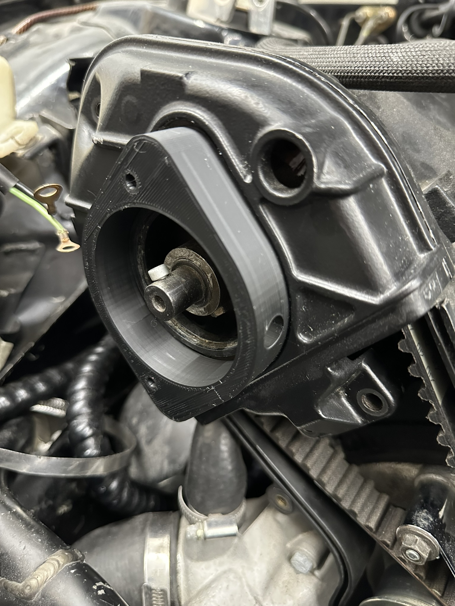

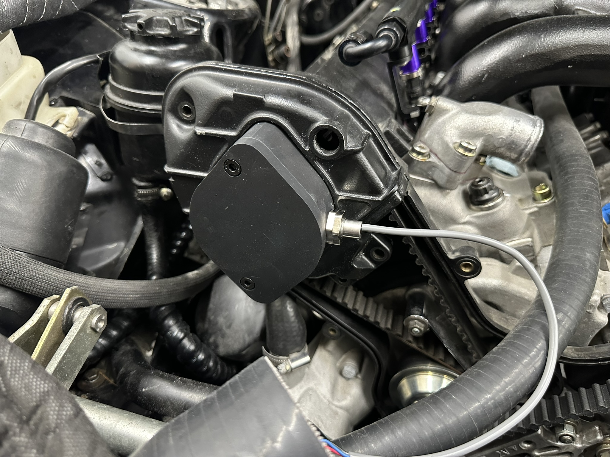

Designed my own cam sync housing, 3D print to test, finished is Anodized 6061

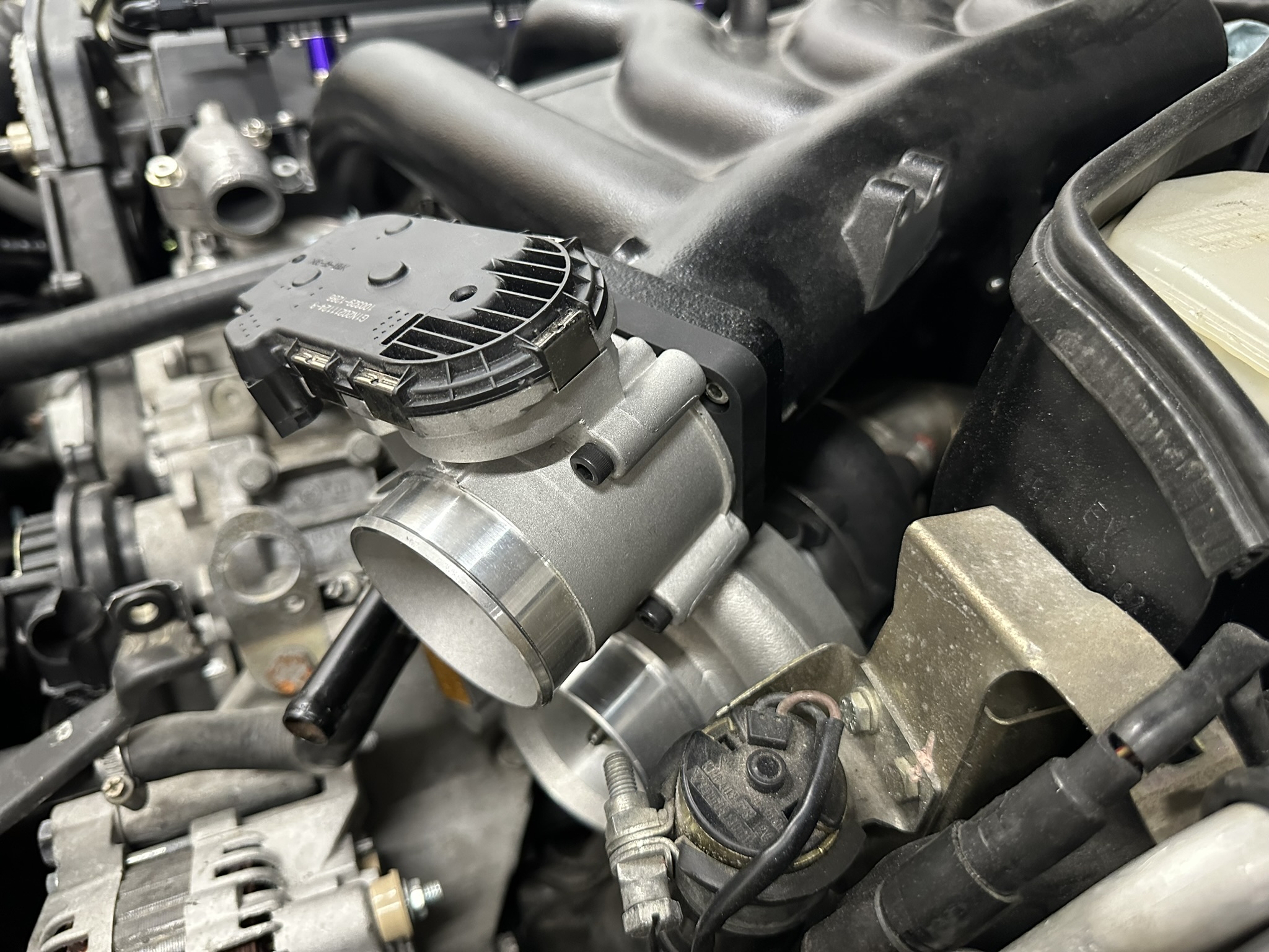

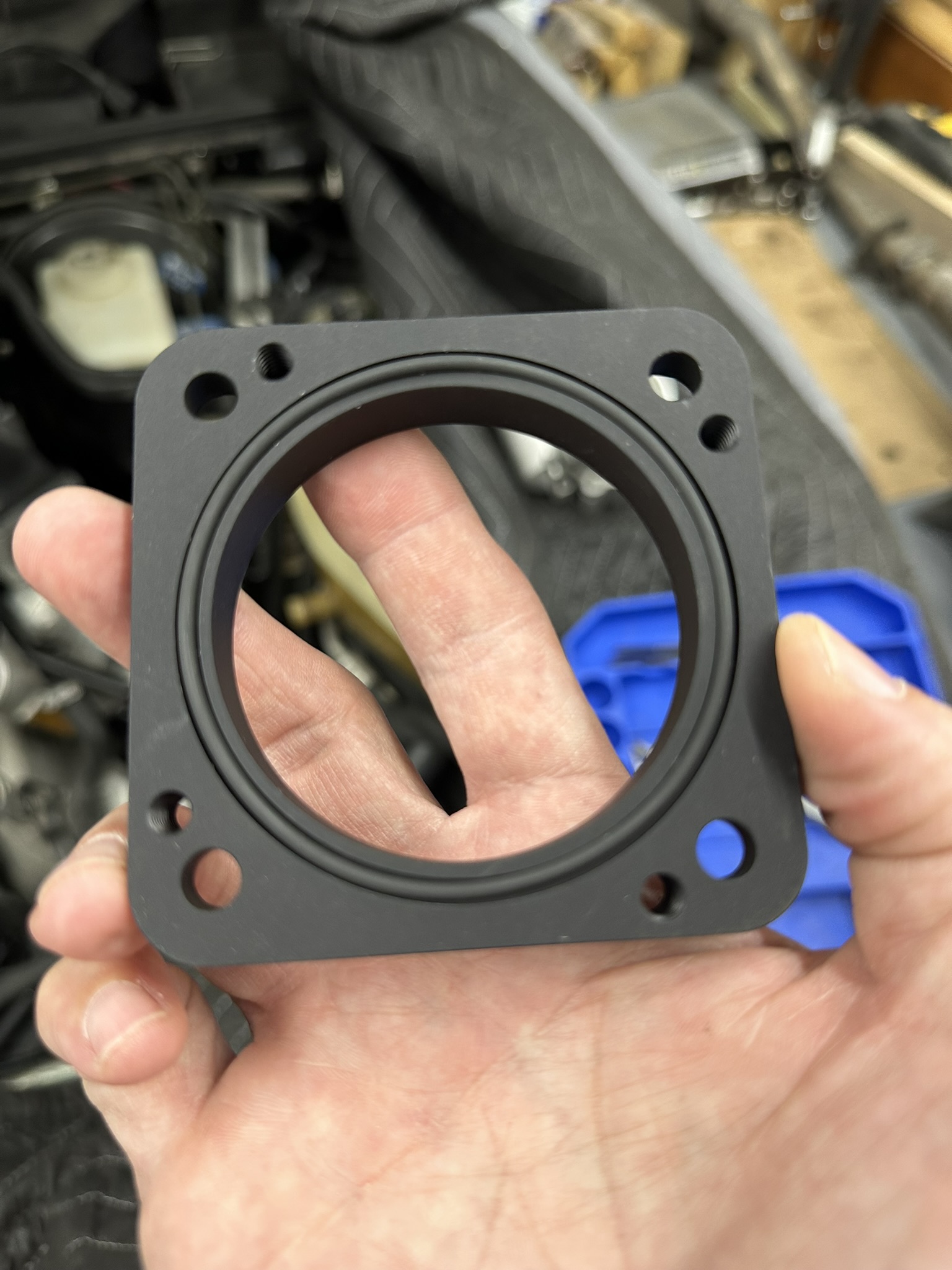

Designed my own DBW throttle body adapter again in 6061 anodized

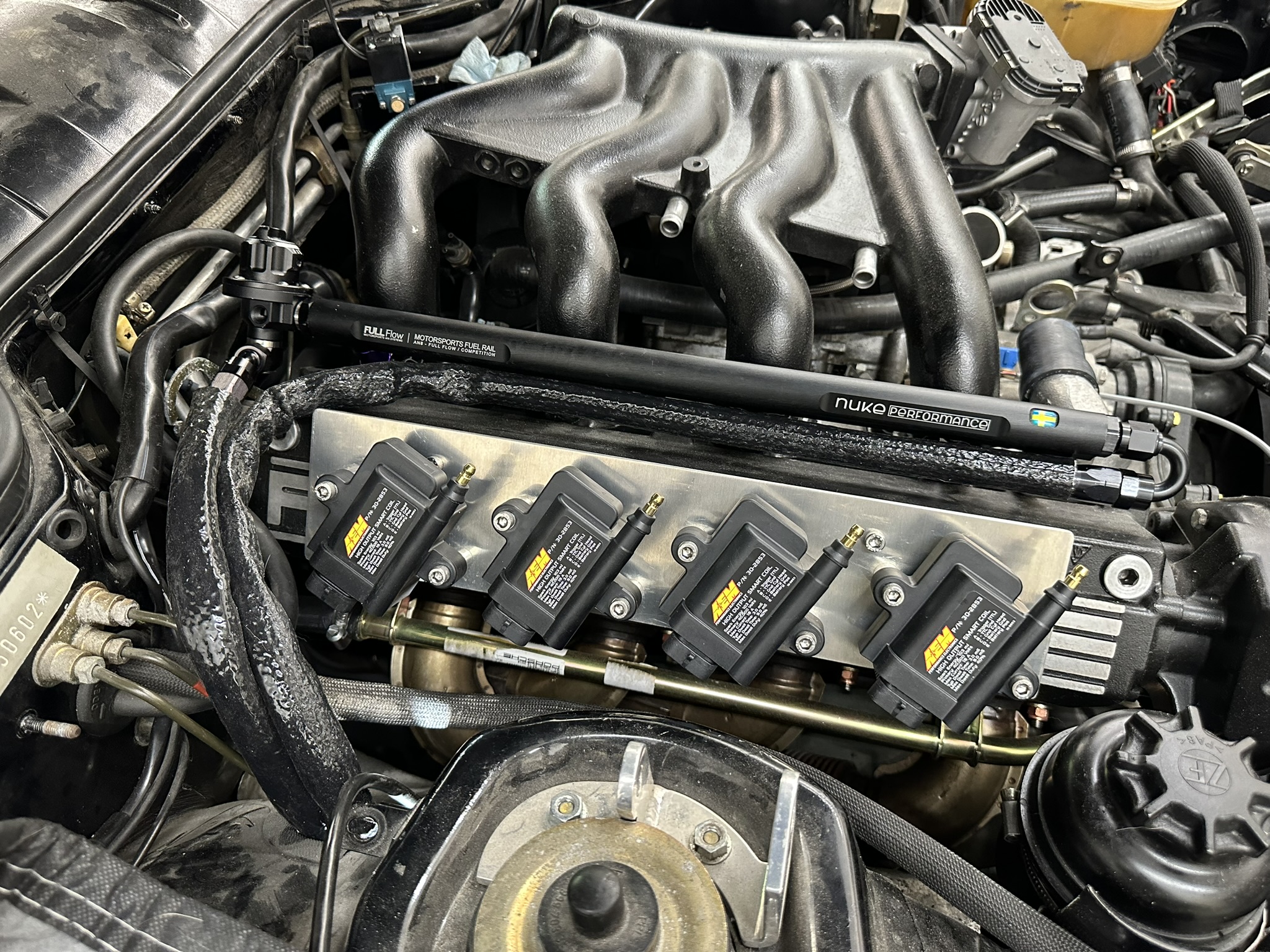

Mounted the coils on the cam box, installed new insulated fuel lines from BAT, Nuke fuel rail and Radium FPR with Honeywell MIP sensor for Maxx

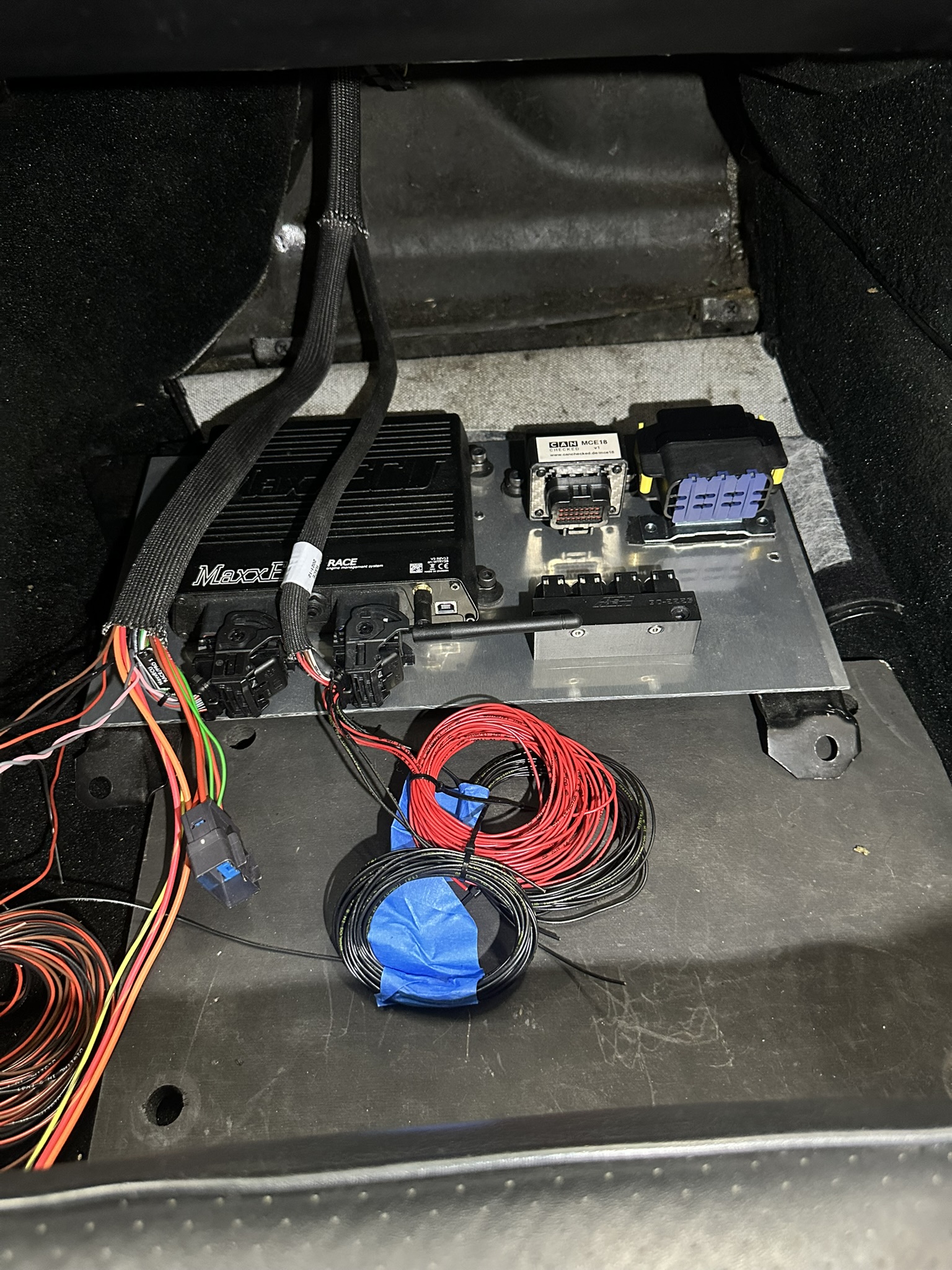

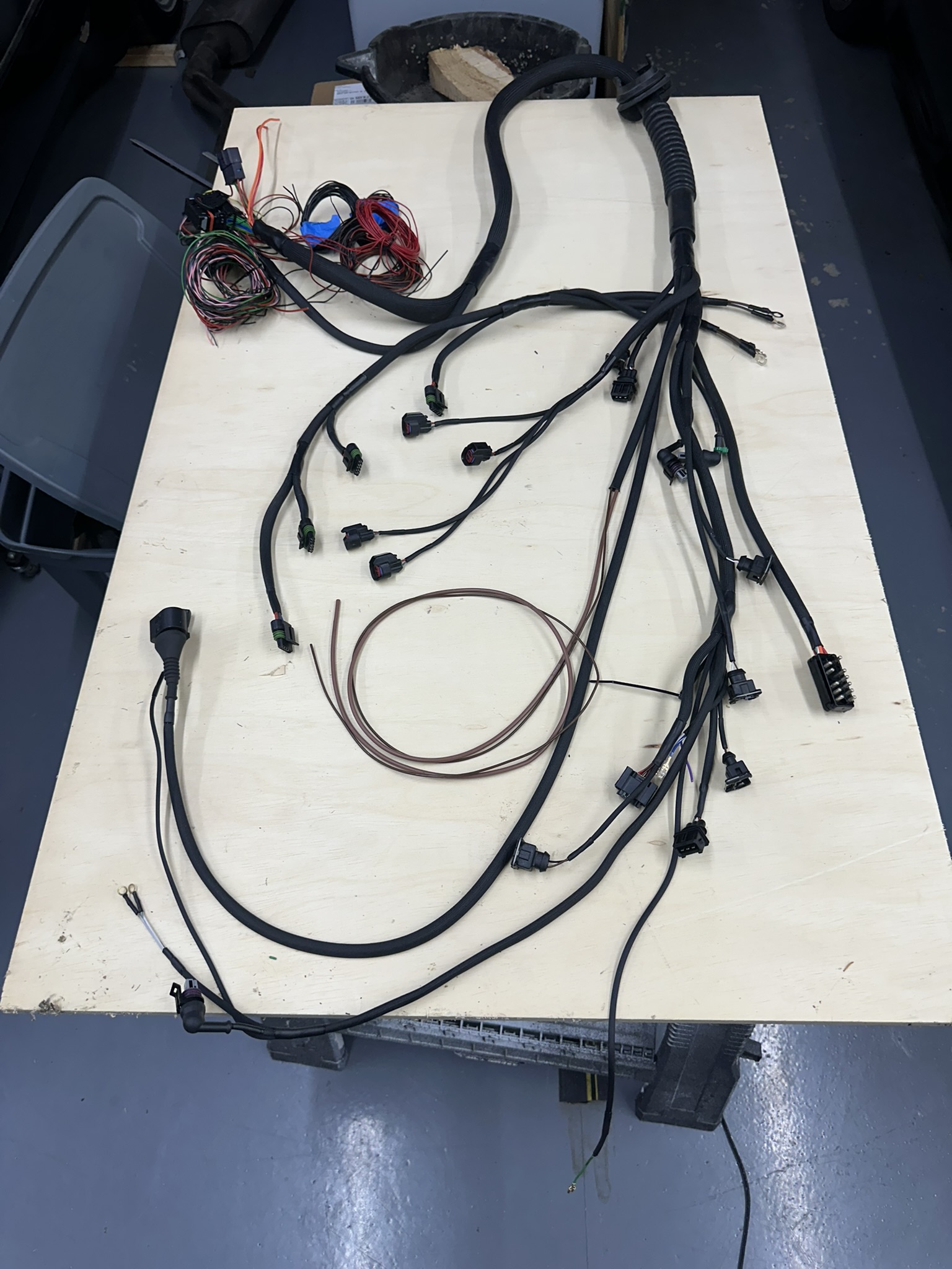

Built my own wire harness for the MaxxECU
Currently learning Maxx and a friend is helping me get it going. The car is drivable. But more to be tuned.

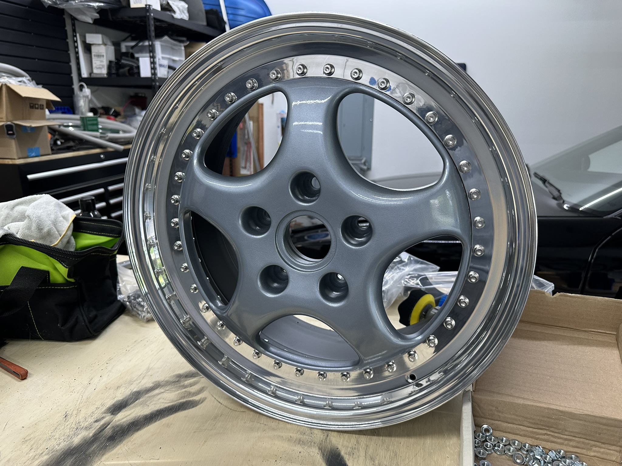

finish wheel rebuild

Awesome work on so many fronts! Every picture deserves a thread of its own! Congrats on getting it going. Very interested to hear how that head gasket does over time!
p.s., is that an actual store name in Iowa?? :wtf:

Tom wrote: Thu Oct 23, 2025 2:11 pm Awesome work on so many fronts! Every picture deserves a thread of its own! Congrats on getting it going. Very interested to hear how that head gasket does over time!
Yes, it was. They were acquired by Maverick out of Utah recently and are changing the name.
I helped develop this HG with SCE/Athena a few years ago. The initial group buy was ~50. I have not heard of a single person having any issues with these. I went through 2 Cometics before installing 1 in one of my 89’s.

I installed that same HG in May 2024 and so far so good. I have gone as high as 19 psi of boost.
