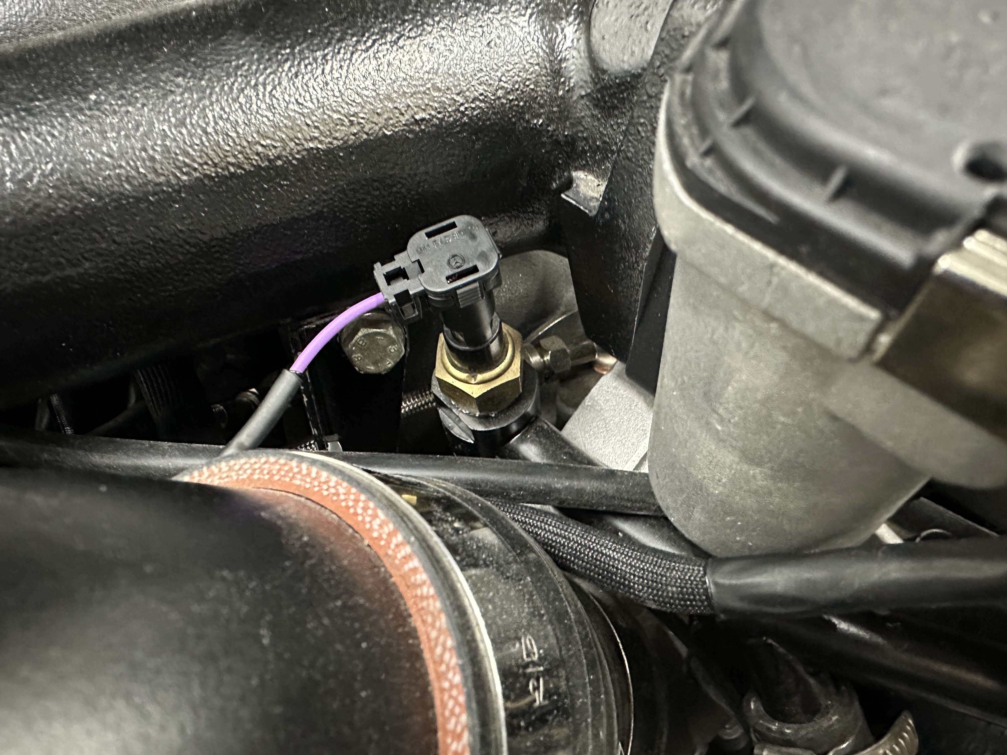

Do you have a crappy barrel terminal on this connection? Are you building a new wire harness for stand-alone ?
These Benz parts fit perfectly and clean it up proper. This sleeve terminal also will fit the oil level sensor.
Aux water pump terminal
I just placed an order as well. Way better than the other Porsche solutions from 2 different vendors I’ve been able to find (one vendor, and way, way cheaper).
Right now I always pop the hood after a spirited drive to make sure it’s connected and the pump is pumpin. Will be happy to stop that.
