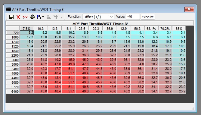

What do you make of these header numbers? I rescaled the RPM and Load axis many years ago when I was tuning my hybrid stroker. The goal was to make it more linear and intuitive.
37 0E 05 06 07 08 09 0A 0A 0C 0D 0C 0F 10 11 5F
49 0C 07 07 0D 0D 0F 11 12 13 14 1F 26 26
Posted crossed, but see my post just now. Pretty sure I have the XDF pointing correctly at the entire table now, with the right column and row header values.
Dave W. wrote: I just edited my post for clarity. I posted my changes to the header info on the part throttle fuel and timing maps. IMHO the breakpoints on the stock RPM axis were very uneven. Perhaps the Porsche/Bosch engineers were following a best-fit curve?
AHA! There it is! I couldn't find the button to attach a screenshot.
This is my modified Timing map. You can see how I changed the header values to expand the Load range and make the RPM breakpoints more linear, with good resolution at low rpm. I'm also relying on interpolation at high rpm and higher loads. I edited several other sections of code to integrate the WOT maps into the Part Throttle maps and skip the WOT portion of the original code.
Timing Map.jpg (121.36 KiB) Viewed 542 times

Wow, you are in a league of your own Dave! Did you change the actual programming code in the lower ROM area?
