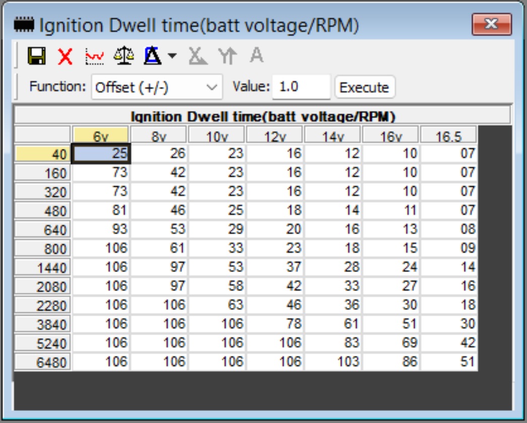

Got it! Only machine language engineers could come up with that. :lol:
For the humans in the room, and to test (and document for posterity) my understanding, the BIN values in decimals reversed to read from left to right:
94, 31, 35, 39, 5, 16, 16, 4, 4, 4, 4, 3
And then if each entry were the sum of itself and all values to the left:
94, 125, 160, 199, 204, 220, 236, 240, 244, 248, 252, 255
And then if you subtracted those from 256, i.e., the first overflow value:
162, 131, 96, 57, 52, 36, 20, 16, 12, 8, 4, 1
Then that times 40 gives the table values:
6480, 5240, 3840, 2280, 2080, 1440, 800, 640, 480, 320, 160, 40
And based on the logic, that would mean a column is used if the rpms are at or above that column's number and below the next. In other words, the first column (shown as 40) is really for rpms from 40 to 159; and the 2280 column is really for RPMs from 2280 to 3839. I imagine the DME reports any meaningful movement as a 1, meaning 40 rpms, such that the first column applies to just about any movement up to 159 rpm? And the upper end must be 6480 up to 10,200 (255*40)?
If that's all correct (?), I'm trying to back into the voltages shown in those same xdf maps -- i.e., 6, 8, 10, 12, 14, 16, 16.4 using the same logic. The 7 entries in BIN order in dec are 29, 30, 29, 30, 29, 7, 14. The rightmost entry is 14 (0Eh), which would suggest the 255-14=241 equates to 16.4 volts. 16.4/241 = ~.06805 volts per count. But if you map the voltages used in that table (assuming they are correct) you don't get a slope of .06805, it's more like .0674 plus a fixed .0164... All of which makes me wonder if the same logic is applied to the volts...

Yeah that's it. Generally the DME doesn't directly use the value from the matching column - it calculates how far between the 2 columns the actual input value was, and then calculates the best possible in-between value, i.e. interpolation. For the endpoints, it works exactly as you said, i.e. all values up to the lowest one are treated the same and likewise for all values higher than the highest one.
There are a few maps that don't work this way but most do. This is partly why the overflow technique (weird as it is) is handy - the overflowed value is a measure of how far past the matching column the input was.
The voltage axis works the same way but maybe I made a mistake with the 0,0686 thing...that seemed to give me the right numbers but I'll double check later.

I hadn't seen your edit when I posted above. If the dme dvides by 3.5, then that would suggest an upper voltage of 5*3.5 of 17.5 and .0686 per step as you say. If the values are indeed .0686 and the actual voltage cut off are not clean as shown in the XDF. By my math, they'd be 5.97, 7.96, 10.02, 14.07, 16.06, 16.54 ??
That would make the XDF a fairly accurate rounding, expect for the last 16.4 entry.

Tom wrote: Wed Sep 10, 2025 4:42 pm I hadn't seen your edit when I posted above. If the dme dvides by 3.5, then that would suggest an upper voltage of 5*3.5 of 17.5 and .0686 per step as you say. If the values are indeed .0686 and the actual voltage cut off are not clean as shown in the XDF. By my math, they'd be 5.97, 7.96, 10.02, 14.07, 16.06, 16.54 ??
That looks right to me except you're missing something around 12v. With resistor tolerances and everything I doubt that the number I came up with is the right nominal value but anyway those look to be a near perfect match for the pic I posted earlier.

Ok, thanks to your help, I think I have the dwell map sorted in the XDF. The one posted in the TunerPro database was off on multiples fronts. It had the RPMS and volts wrong, and was missing the first row of the table (it was 7 x 11). Here's the corrected version (I believe), showing the entire map (7 x 12) starting at 0x3F3. Looks like Dave W had figured this out already based on the map he posted previously, but I'll be sure to include this version in the XDF I plan to post once done. @FTECH9 had asked on RL about the dwell map posted in the TunerPro database in connection with his wasted spark project, and never got an answer in that thread, so I'm tagging him here in the event he's still looking for this info. When he tried to adjust the idle dwell times, using the idle rpm ranges shown in that XDF, he was really changing the dwell in the 160 to 320 rpm range, so no surprise it didn't work.
