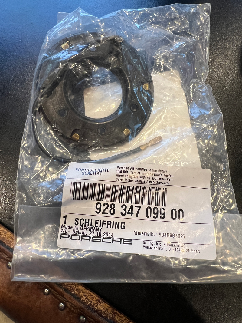

On another note, my horn slip ring and contact are trashed! I see these items are available for the non airbag 944.1. Looks like the same part as my 86 though?

Looks like the steering wheel side is still available.
https://944online.com/horn-contact-ring ... 5-2-to-91/
If memory serves, the column side comes as with the blinker/stalk assembly, which is spendy. I'm not sure if you can buy the right part separately? My guess is you could cut a strip of copper and get creative with a pop rivet gun, if you have the pioneering spirit.

O i have plenty of the pioneering spirit! Have already thought of creative ways to fix the stalk side. No way I'm spending that kind of money just for a horn contact! Seems I may be forced to on the wheel side though. Or I just find a decent used wheel when I head down to Elliot at 944Barn.Tom wrote: Sun Aug 17, 2025 11:25 am Looks like the steering wheel side is still available.
If memory serves, the column side comes as with the blinker/stalk assembly, which is spendy. I'm not sure if you can buy the right part separately? My guess is you could cut a strip of copper and get creative with a pop rivet gun, if you have the pioneering spirit.![]()

I once bought a right-hand drive steering wheel ring by accident and probably still have it somewhere in the dark corners of my garage. I'm wondering if you could do something with that?

Well... good news and bad news. The bad news is I cannot find that right-hand drive ring contact for the steering wheel. The good news is I have a brand new, still in Porsche baggie, left-hand drive version, part # 928.347.099.00 No idea how I ended up with this in my garage, but am thinking maybe I exchanged the wrong one after already sourcing the right one for my car. I dunno... At any rate, if you pledge your never-ending allegiance to Carpokes, get everyone you've ever met to join, and name a warm-blooded pet or favorite houseplant after me, I'll send you this one gratis.
