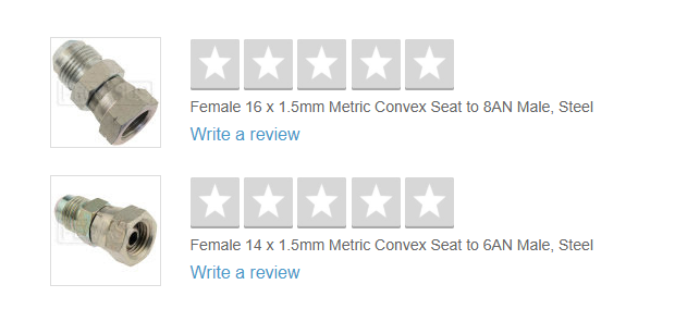

Batinc sell the correct Metric flare adapters for the hardlines that come from the wheel well but theyre not always in stock. If not they have metric compression fittings and you have to cut the hard lines.
Pegasus racing sell the adpaters for the fuel rail
