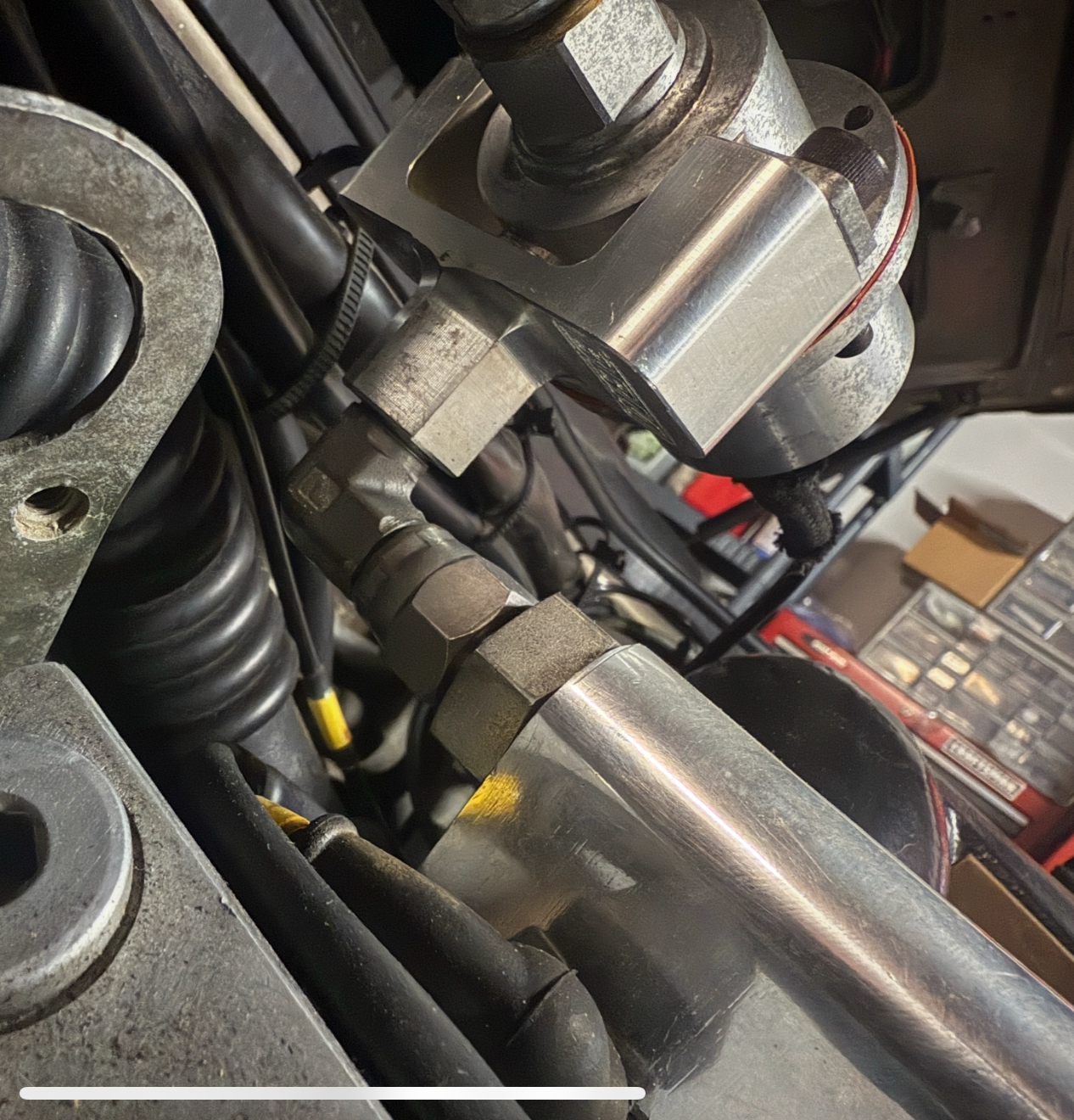

Gaspowered is correct. If you plan to direct mount the reg you'll need to make sure the rail has a -8 ORB port.
Radium PN is 20-1623-00
Upgraded my FPR so now I have a BBM adapter and AFPR available to anyone that needs one

Maybe you already mentioned this but what was the issue with the FPR you were using? I have been using the LR one without issue but now that CW is doing my 3L turbo build, I am debating switching to something like the 1 you are using.

My old setup had the FPR+adapter supported only by a 90deg elbow. Originally it was an aluminum piece but I switched to steel. Ultimately I just wasn’t happy with the fit and potential for fatigue failure so I started searching for a different solution.Fejjj951 wrote: Thu Apr 03, 2025 7:57 pm @Darwin

I’ll be changing the return line fitting to a 90 so I can get rid of the elbow and the gauge will only be on to set pressure.

I asked about the fuel rail because I went through 3 stock rails, all leaked, so I gave up and put on a Lindsey rail. I'm really trying to maintain a stock appearance, but I'd rather have an LR than have the car burn to the ground.
@Fejjj951 , I believe this may be the regulator Darwin is using.
I apologize if this isn't correct.
https://www.radiumauto.com/DMR-RA-Direc ... P2752.aspx
