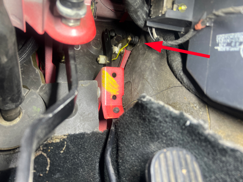

Above: I ended up taking the driver seat out so I could lay on my back and get better access to the cable. It's still awful access that wants to dislocate your shoulder, but I never could have done it with the seat in place. The arrow points to the end of the cruise control cable. It attaches to the linkage with a rubber plug that is pushed over a pin on the linkage. There are no fasteners, just a very tight rubber grip on the pin. Step one is to get the bushing off the pin. Some claim they can pull it off by hand, but unless you have pneumatic fingers, that was a virtual impossibility on my car.

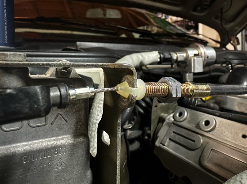

@Tom Can you take a picture of the cable where it attaches to the bracket at the cruse control motor?

For context IDK how to get around this. The cone on the end will NOT come off...I don't want to damage my brand new cable...Thinking I need to modify the bracket.

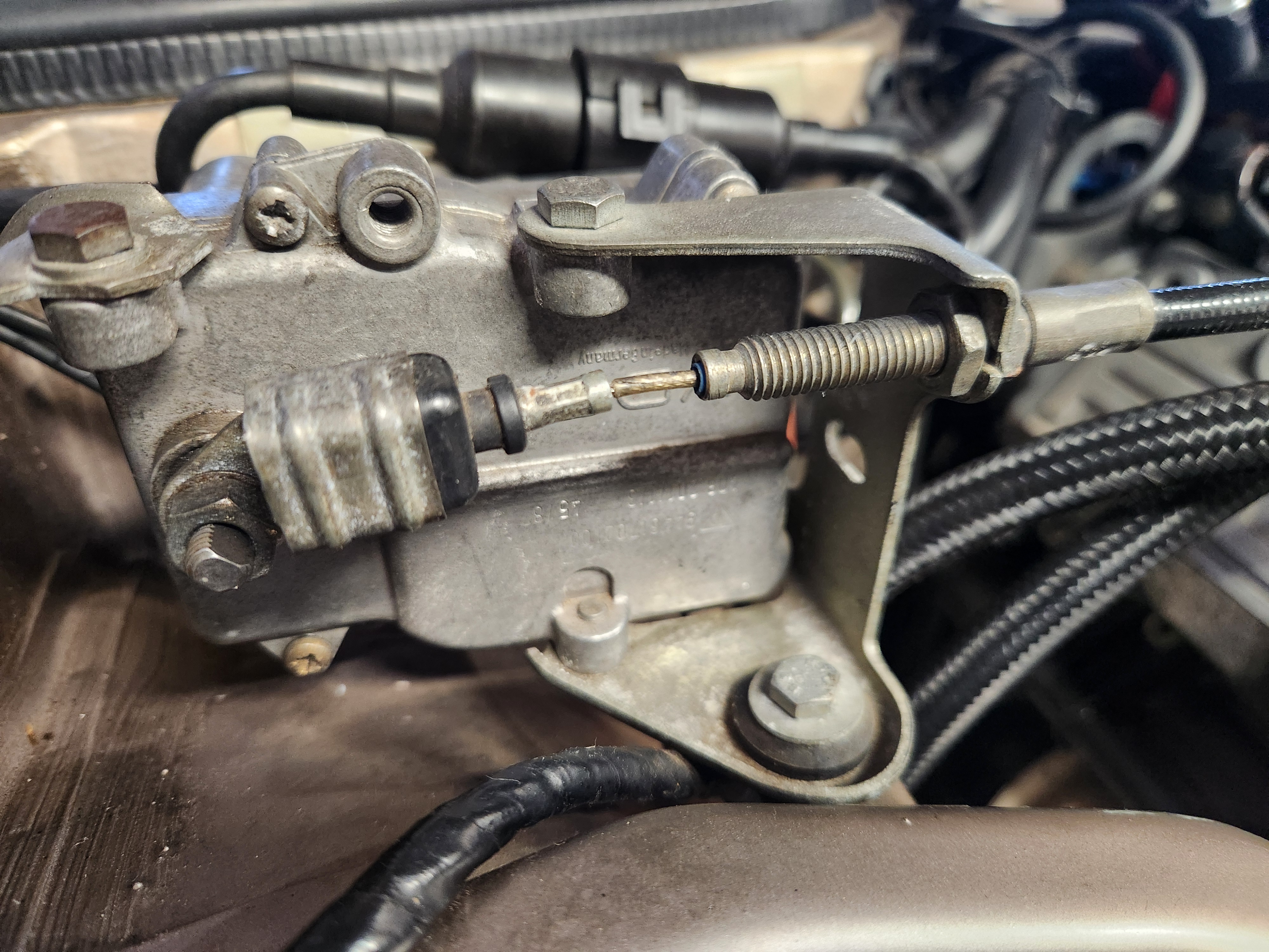

Mine doesn't have that cone piece.
I'd take a rotary tool (Dremel) with a cutting disc and carefully remove the cone.

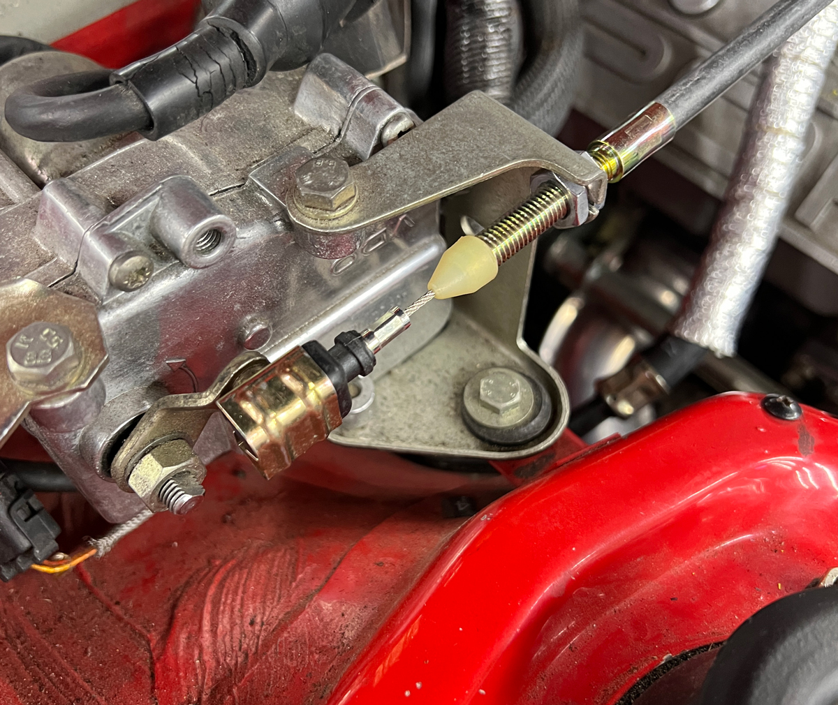

So here is mine. I did have to take the cone off and put it back on. It's super tight as you know, but is made out of a nylon that flexes enough to pull it off with enough strength/leverage. It just pushes on and off, no threads, but has has to stretch/expand to snap on and off. If memory serves, I just used plyers to pry it off and put it back on. Also looks like you might be able to create a make shift press with the nut to force it off the end. Or the nut can be used to brace a trim removal tool like the one below. However, you do it, no bracket modification is needed....

Yours is the original design with the nylon lining inside the end. The nylon prevents the cable from rubbing on the metal and fraying. I'd have to check, but seem to recall the cone replaces (or at least supplements) the internal nylon lining, to keep the cable centered and not rubbing on anything but nylon.
