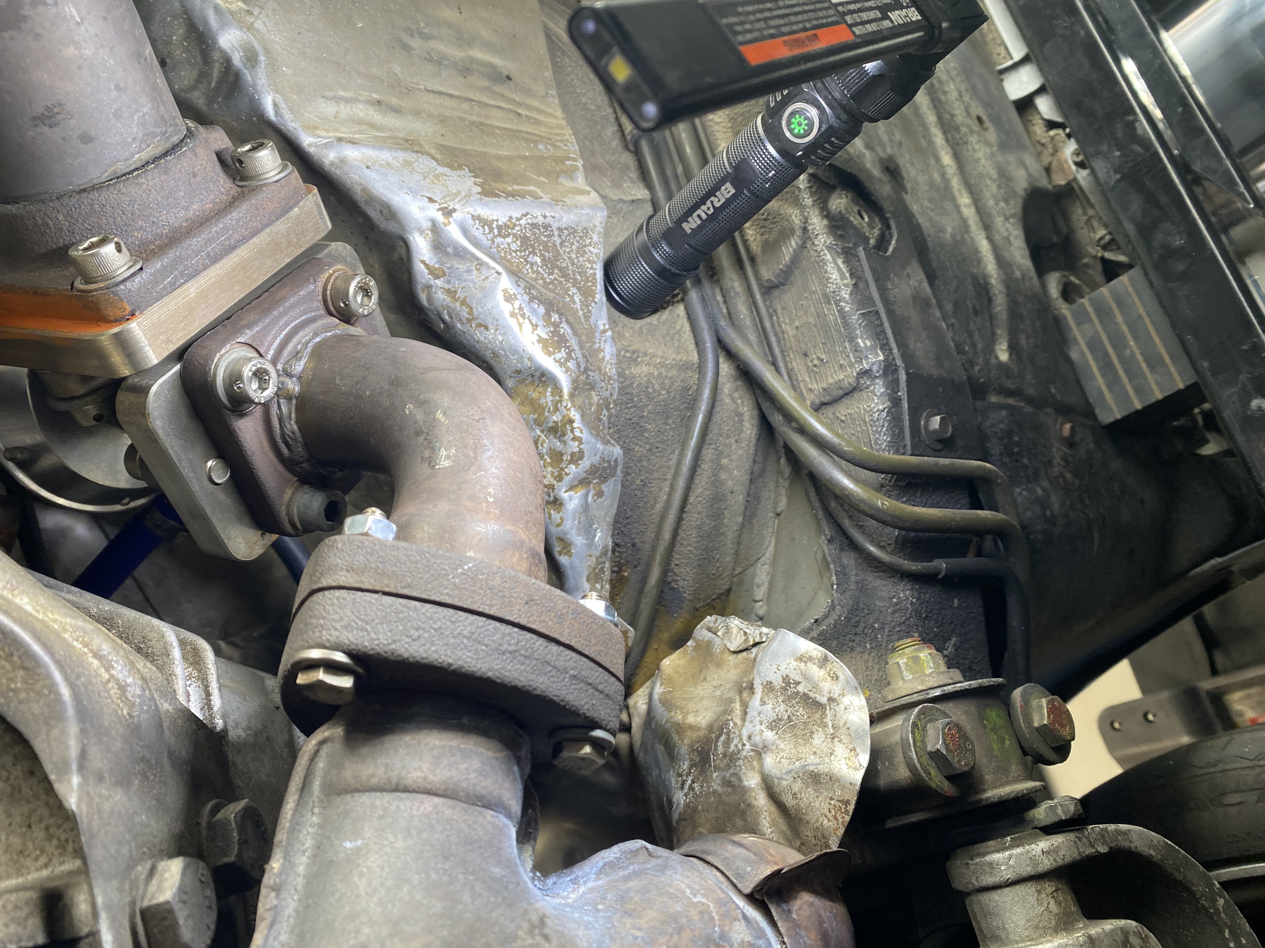

Just an update on my “slow to spool” situation. I found my culprit to the flange that connects 90* elbow pipe to the wastegate was not tightened all of the way; I was able to unscrew the three nuts/bolts with my hand! So, I put lock washers on both ends and tightened them, and problem solved!

Nice work, and a lesson to all with a similar spooling issue. Check all the simple things first!
