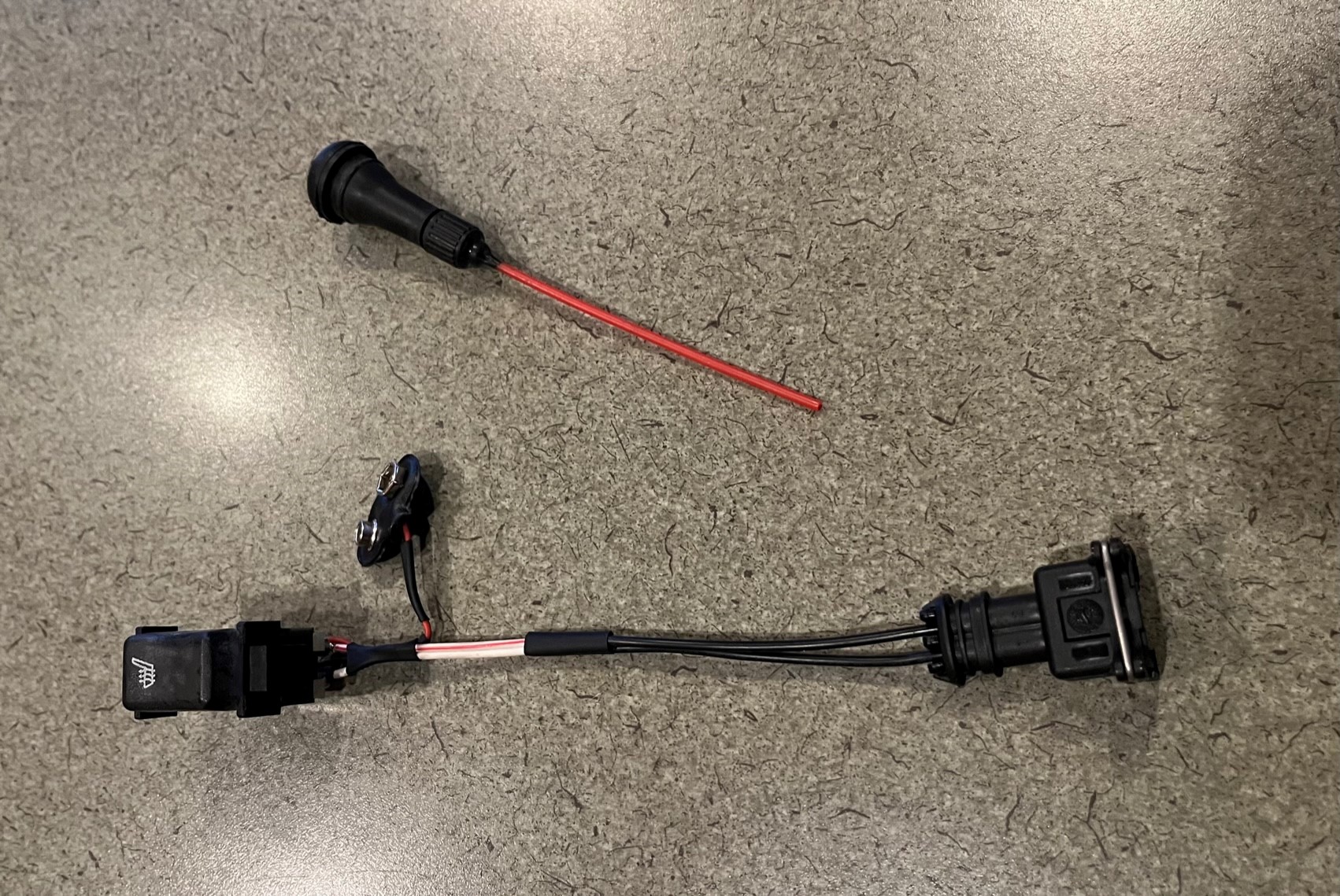

I don't know if you want to try to clean your injectors - or if this would even help with a leaky one, but I used this setup with good success on my injectors (I just used a 9v battery and a momentary switch - that used to be a seat heater button on a volvo) :
injector cleaner.jpg (633.11 KiB) Viewed 794 times
