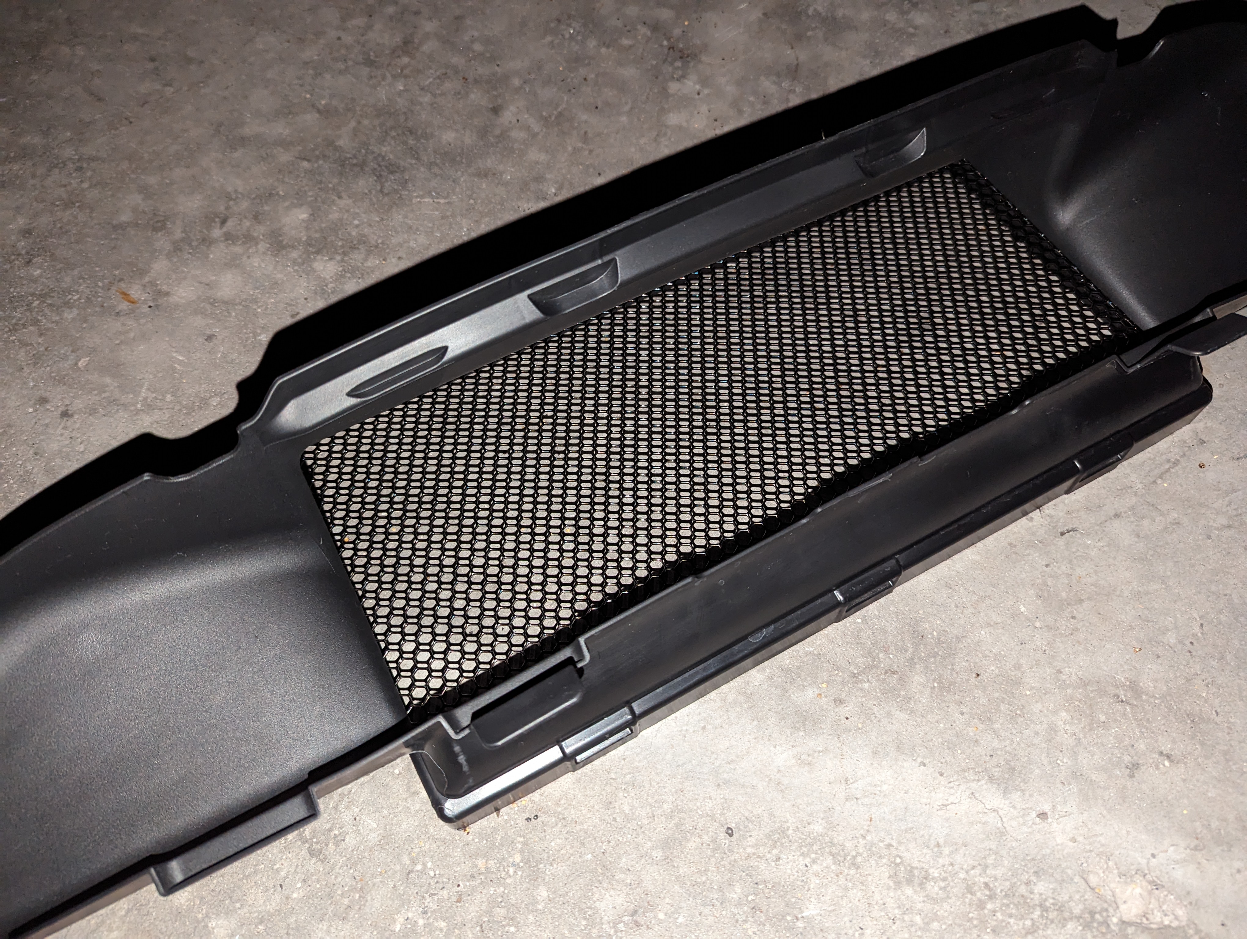

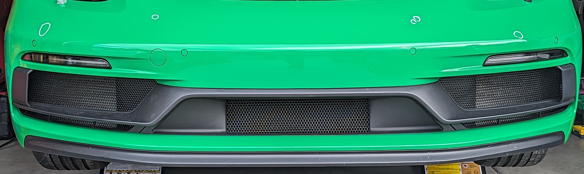

I came home this weekend after a short drive and since my Cayman GTS is in the dreaded 2000 mile break in period and I figured I might check the side vents just out of curiosity. I had already decided get screens after chatting with someone my Great Plains Region PCA friends since every single Trackrat with a Cayman or Boxster had screens, but I was shocked to find leaves wedged in the side vents and a couple Godzilla grasshoppers plastered inside the left front vent. Bingo, another item to go on my Christmas list. That was enough to completely convince me that the little Chalk Croc will not see an asphalt road course without some grill work!

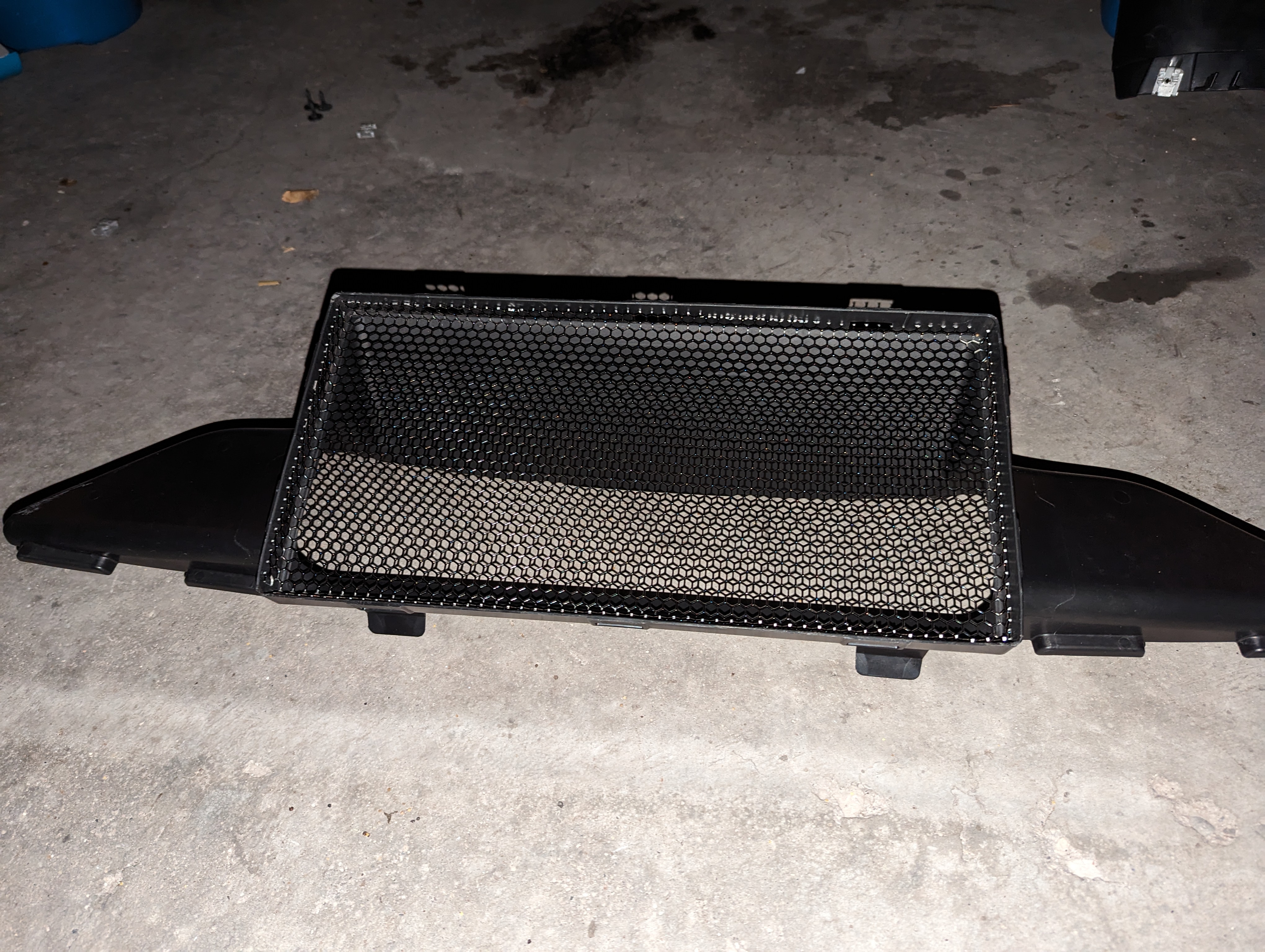

Following the lead of some other 718 owners, I decided to make my own grilles. I pulled the front bumper off to determine the grille shapes and locations as well as to install them. The side grilles were relatively straightforward. For the center grille, I noticed that the black plastic surround forms a box section. I was able to insert the grille into this box section, then install the surround and bumper back into the car.
Final result:
Advantages: I can still access the outer face of the plastic surround, for cleaning and detailing. The smaller dimensions of the grille means it is stiffer.
Disadvantages: The center grille doesn't appear to be on the same plane as the outer grilles, which I think looks a little better than my solution. The plastic surround is fully exposed, like stock, giving it no additional protection.
If you want to make one it is easy. On your chosen grille material mark out a rectangle 15.25" wide and 7.25" tall. On all sides, add a 1/2" strip extending outwards. Cut the grille out and bend the 1/2" strip 90 degrees inwards on all four sides. Insert the grille into the box of the plastic surround and reassemble.
