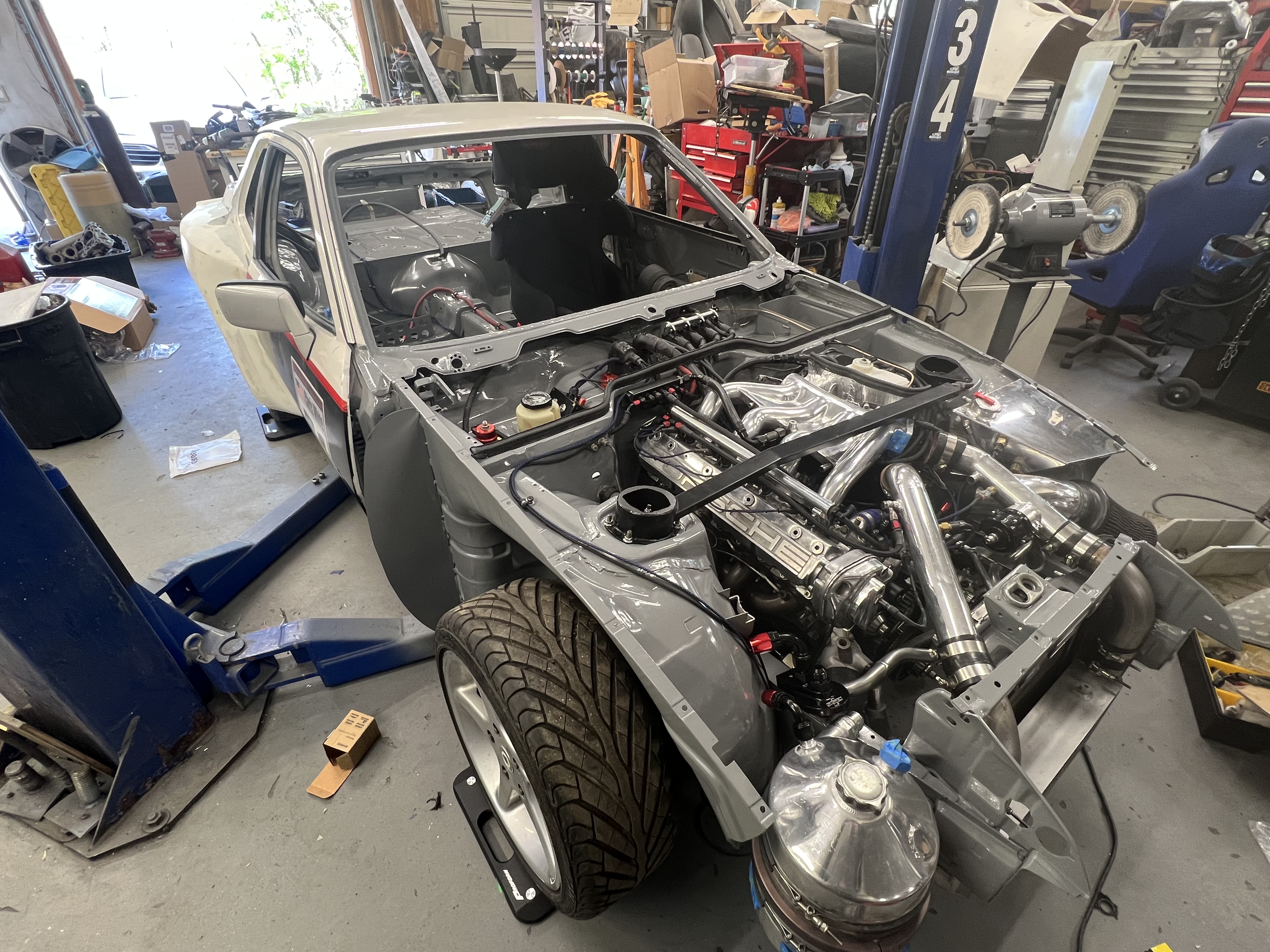

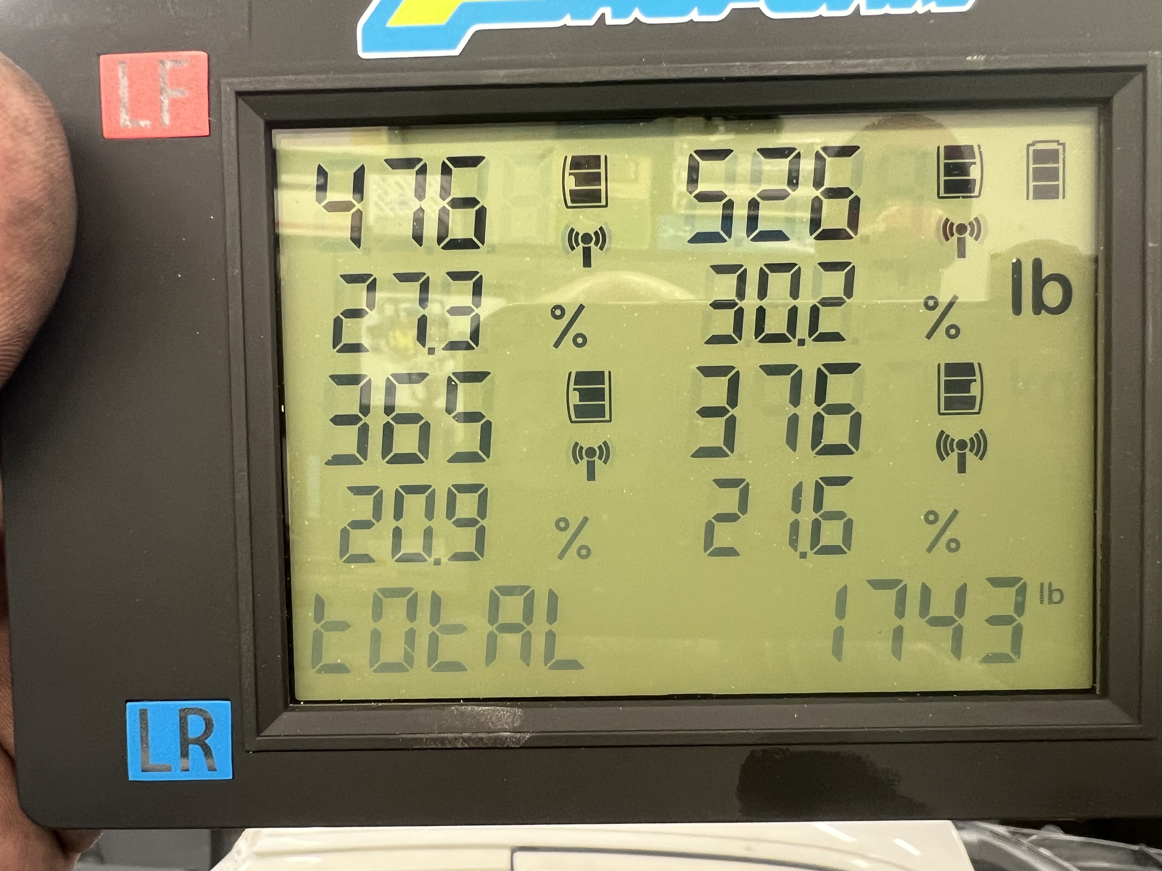

The track car is heading out for cage work so I thought I would weight it just for fun.
Need to add cage, transmission, front clip (fiberglass), windshield and Kenan hatch and wing. Also exhaust system(cat back).
I’m liking the result of stripping weight!!!
Weight watchers project

So, I like going out on limbs - another (edit) 450 to 500 lbs without fuel? (Probably way off but I tried!)chris white wrote: Fri May 12, 2023 11:56 am The track car is heading out for cage work so I thought I would weight it just for fun.
Will you have to add weight to corner balance once it's complete?

I was thinking 400-450 more weight, biased toward the rear (transmission).blueline wrote: Fri May 12, 2023 12:28 pmSo, I like going out on limbs - another (edit) 450 to 500 lbs without fuel? (Probably way off but I tried!)chris white wrote: Fri May 12, 2023 11:56 am The track car is heading out for cage work so I thought I would weight it just for fun.
corner balancing doesn't mean the same front/rear - just the same side to side with the driver on board. changing the spring seat height will get that done.
2200 lbs with 500rwhp will do just fine!
