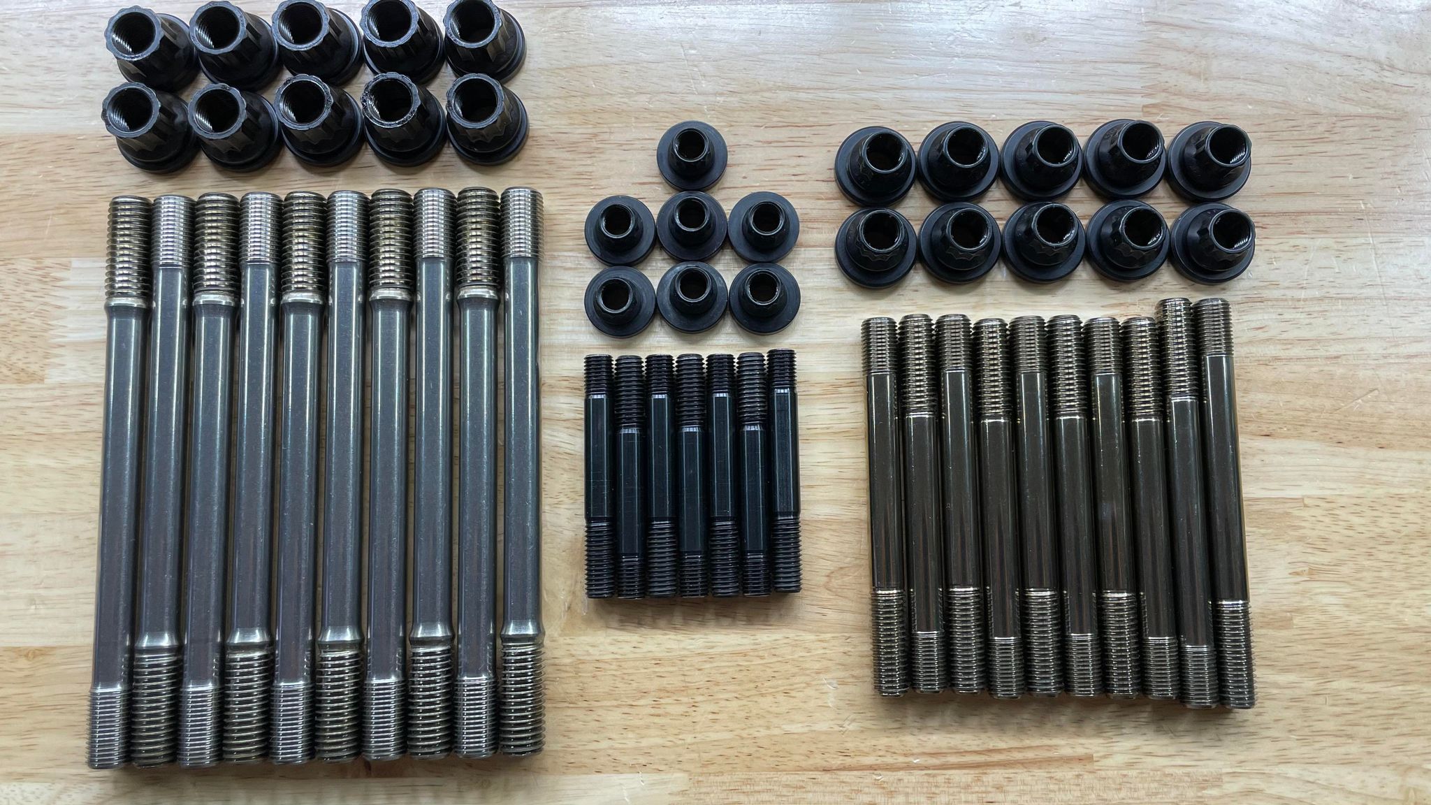

I also sourced some high quality studs for the motor. These have been torqued down to 135ft/lbs without any distortion to the MiD sleeves. That's impressive!

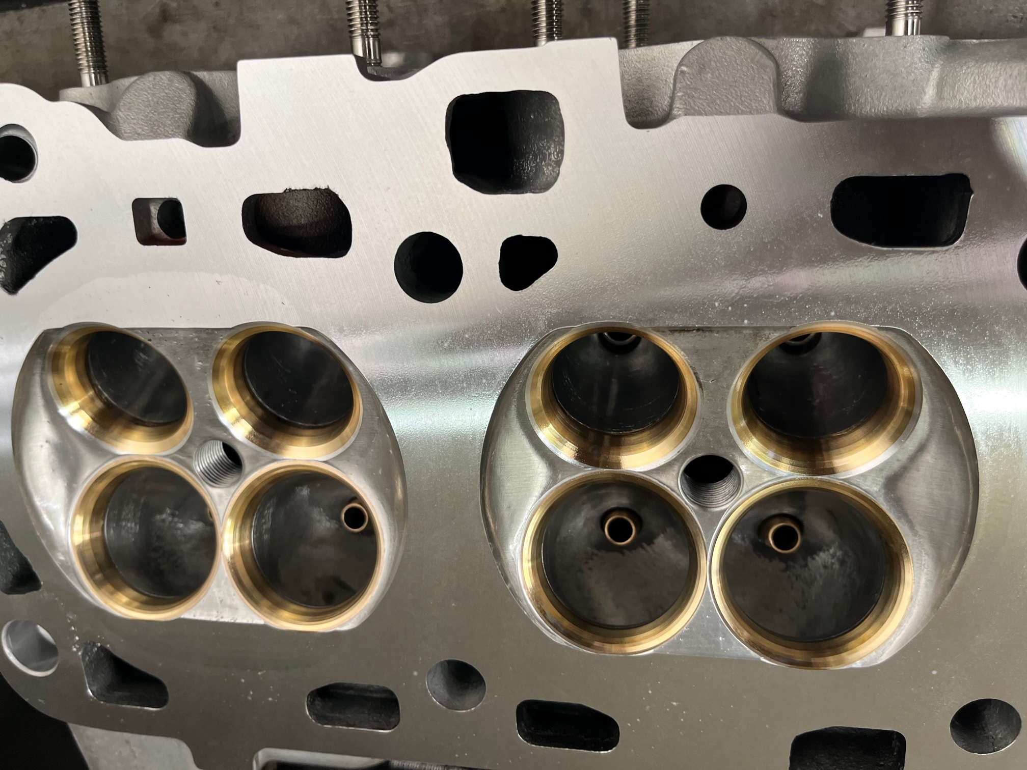

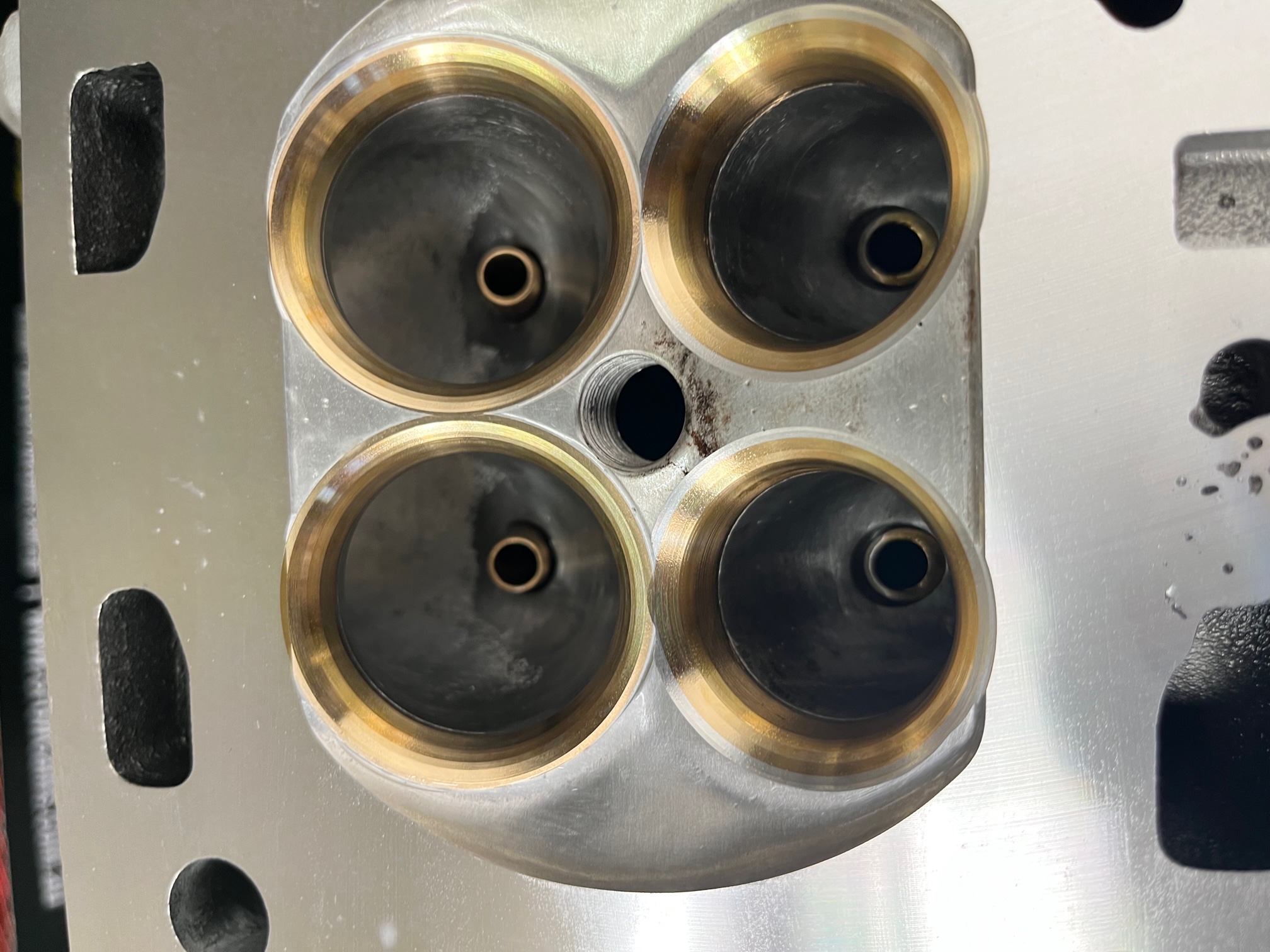

The new engine builder/machinist did discover some other issues with the parts that we'd sent him:
- The Valve Seats were not concentric to the valve guides (not seating without springs)
- Cam buckets were worn and concaved.
- Valve Stem Seals were bigger than the locator causing the inner valve spring to pull the valve stem seals off.

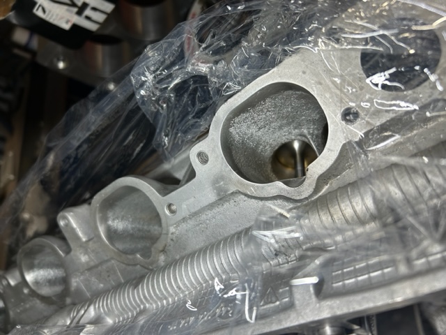

- The intake ports were too smooth and required texturing.

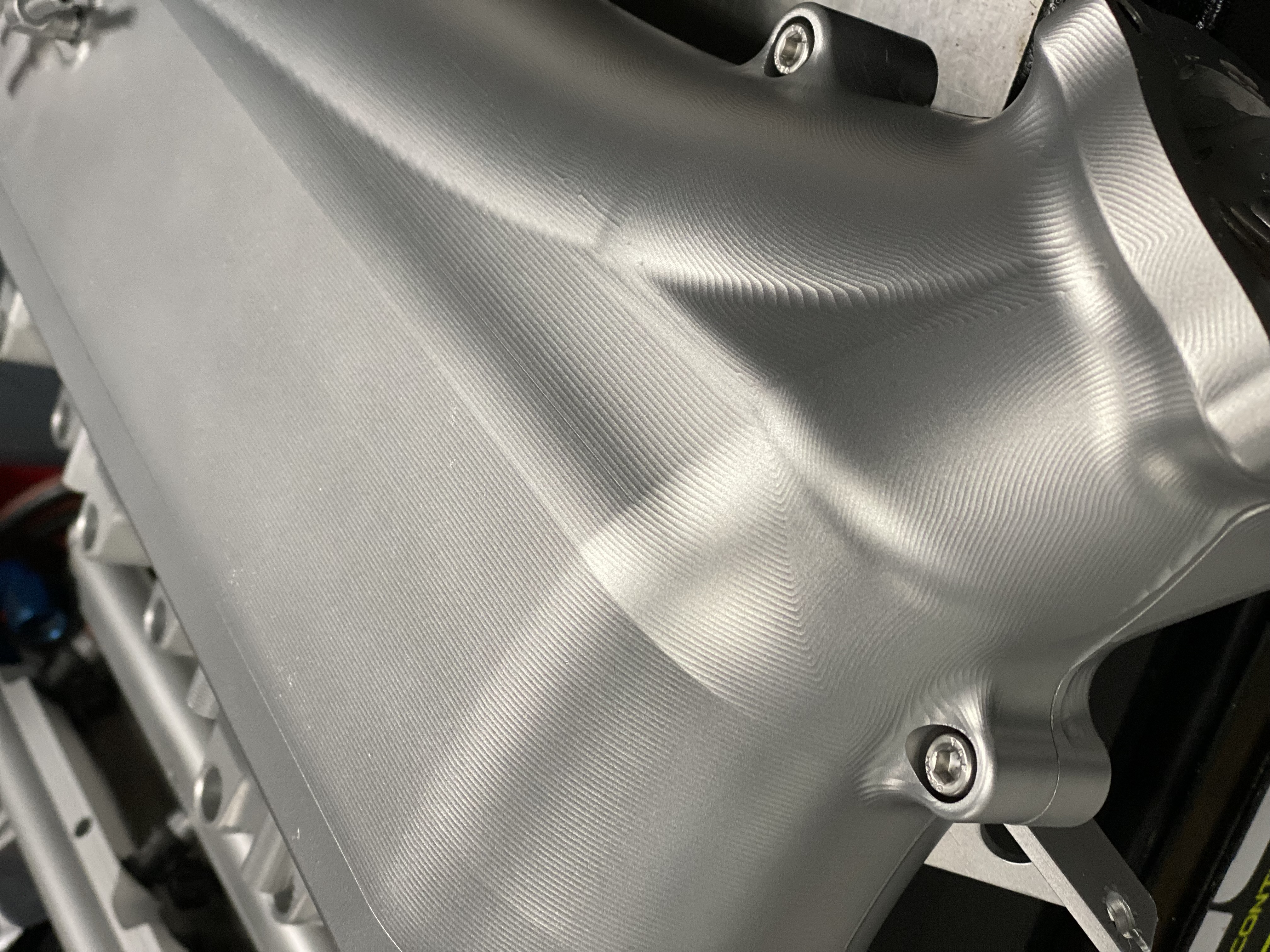

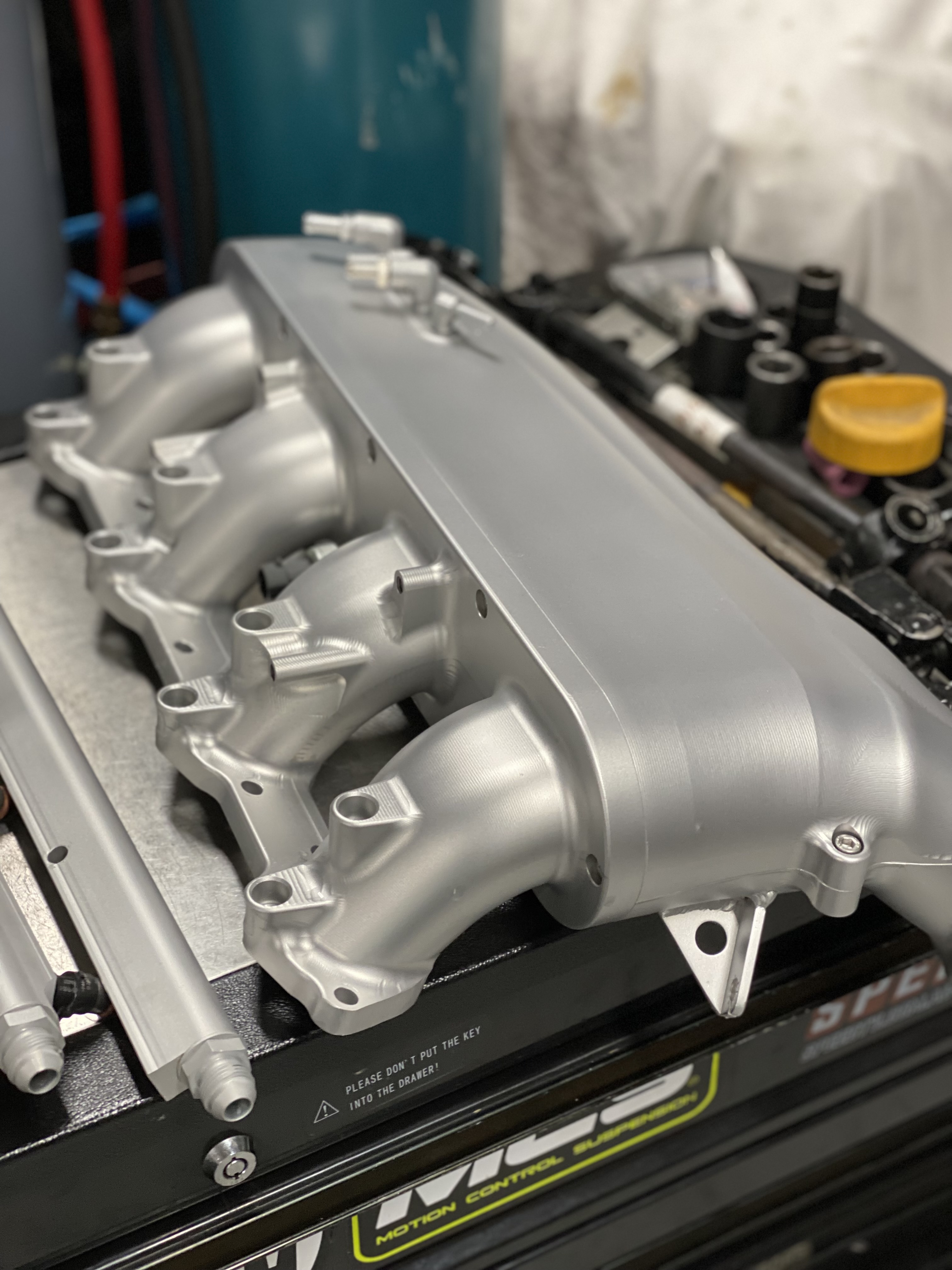

Few more pics. Due to the fire retardant it badly affected the nice finish to the intake manifold. So Sean Buchanan put it through their glass bead machine. Came back with a satin finish which I think makes it look more factory.
- IMG_1638.jpg (3.26 MiB) Viewed 3795 times
- IMG_1636.jpg (1.56 MiB) Viewed 3795 times

The intake looks fantastic.
