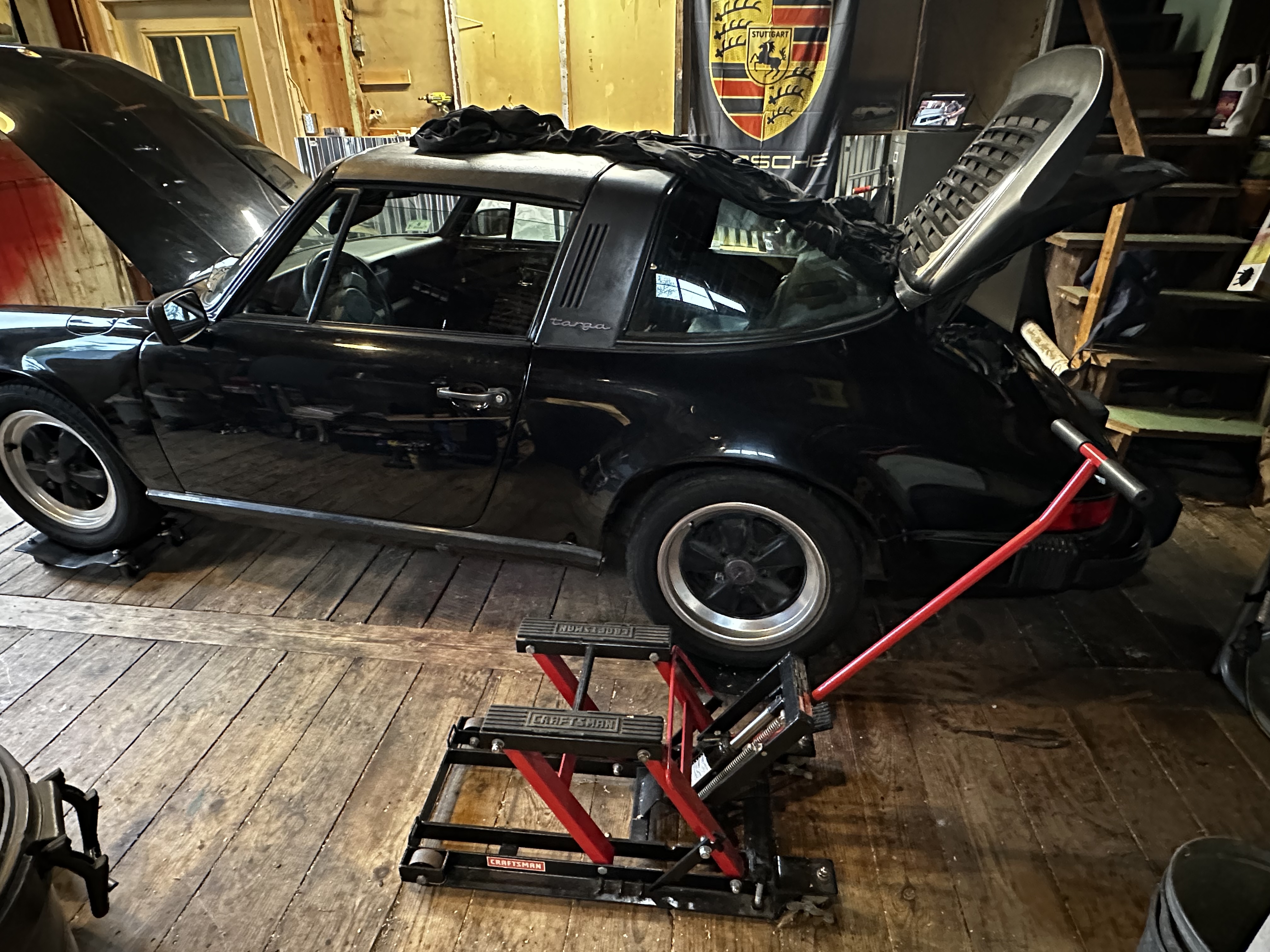

Well I bought a Motorcycle Lift. Started working on disconnecting a few things each night after work. Will drop out the engine maybe by the ends of the month if I get a chunk of time available and an extra pair of hands from my son. Then also have to get an engine stand and yoke.
- 5A9445FE-FD6F-4F45-B4EB-1B6F9E41B137.jpeg (2.64 MiB) Viewed 1721 times

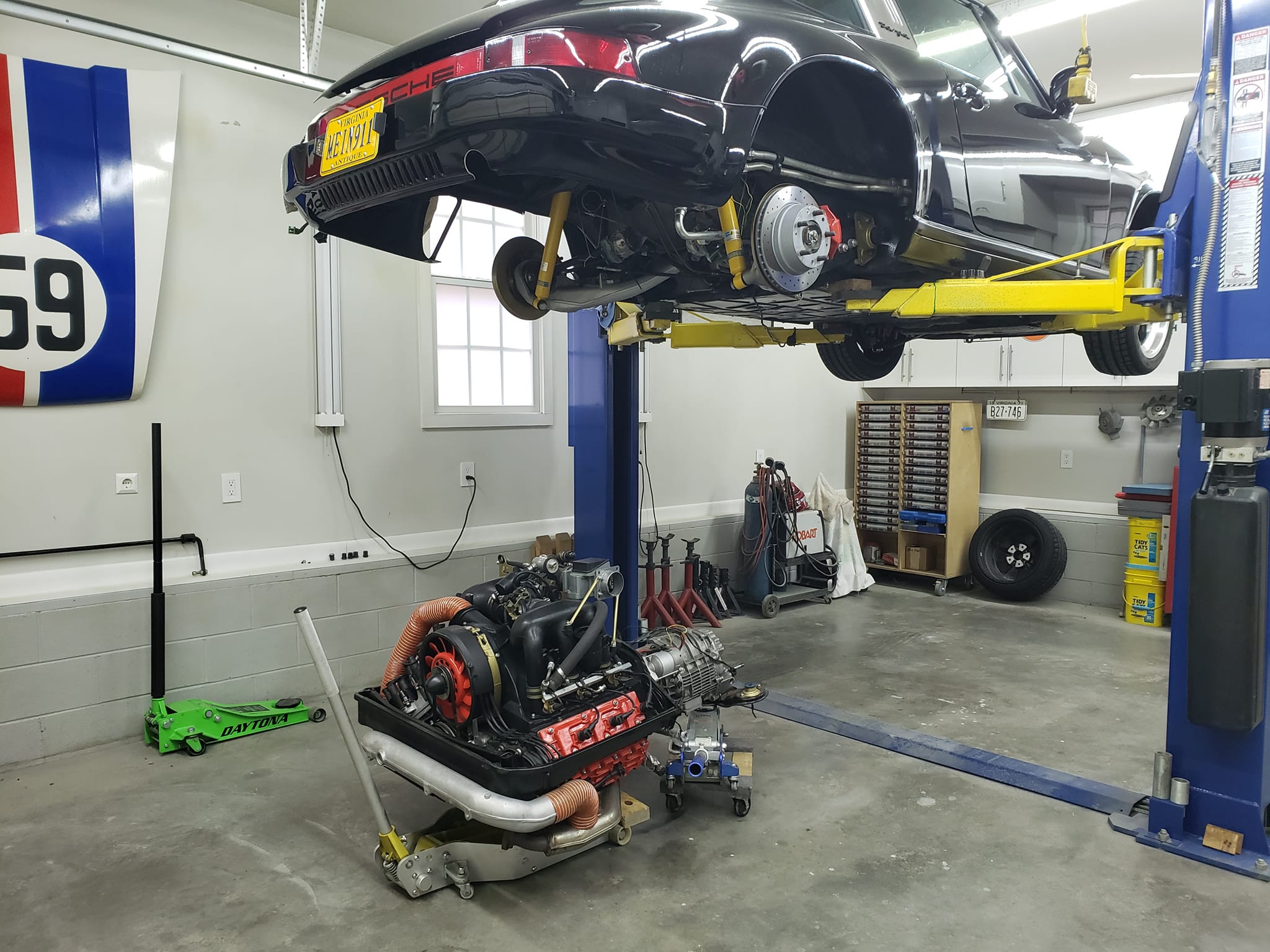

I use also a motorcycle jack. I use it under the engine, and in addition I use a small car jack on a furniture dolly, so it can roll in any direction, under the transmission. This way the engine and transmission can be tilted up and down as needed.
Here is a picture after it is down on the floor. Of course, it can be used also with the car just jacked up at the rear.

Carmagic wrote: Mon May 08, 2023 5:20 am I use also a motorcycle jack. I use it under the engine, and in addition I use a small car jack on a furniture dolly, so it can roll in any direction, under the transmission. This way the engine and transmission can be tilted up and down as needed.
Love that setup !!!
