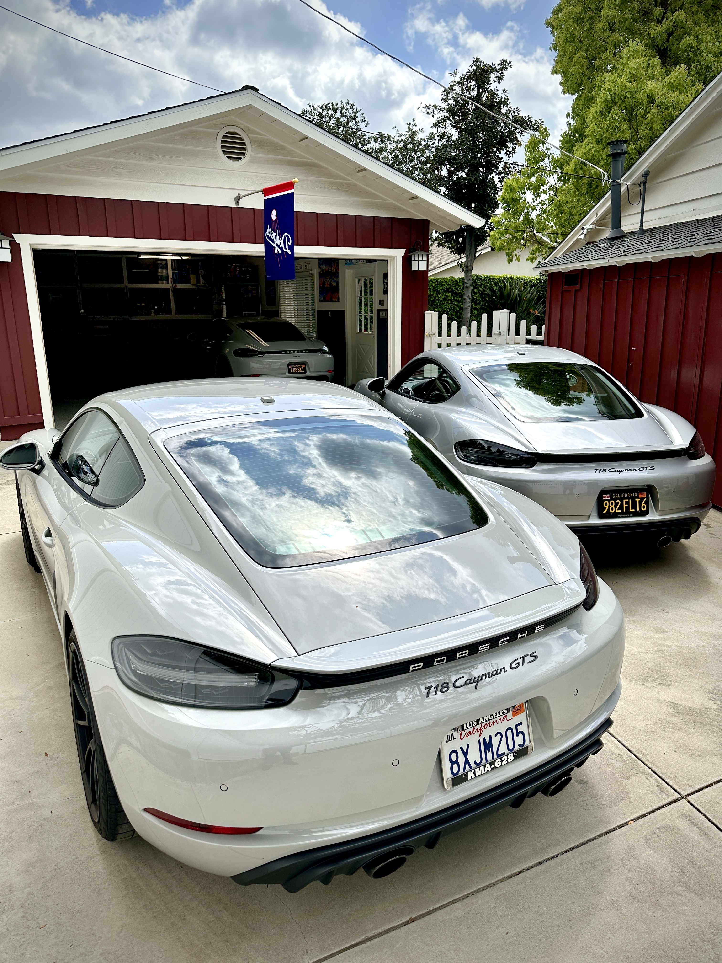

A big thanks to Phil @718socal for several PIWIS coding changes today. Phil drove out to fellow Carpoker John’s @Leader house to do some cool coding for our 718 GTS 4.0 cars. Phil was very careful and thorough. He hooked up a battery charger, ran a scan to check for any existing engine codes and then proceeded to change as many parameters as we wanted. For my car, Phil changed the lane changing blinkers from 3 to 4 blinks, remapped the coolant temp gauge for accuracy, coded the auto-start stop to remember the last setting, and coded the doors to not unlock when opening the Frunk or rear lid.
Fortunately for John and me, Phil is local and drove out to us but coding functions can also be done remotely over the internet. Phil can even activate Navigation for those who chose not to purchase this expensive factory option.
Please send Phil a PM at @718socal or respond to this post if you’re interested in any coding changes to your car.

Three (!) GTSs in the wild.
