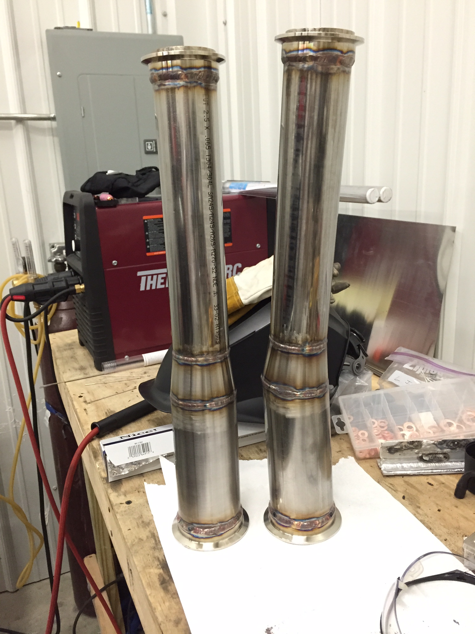

Yes. I have a thermal arc 186. Now ESAB. I had to tig my own exhaust pipes for my Audi engine swap. And was going to build my own 944 down pipe, but life has gotten in the way the last couple years. I went as far as doing CAD for my own turbo flange to matchup to my voodoo turbo as it was a 2.75 outlet and I could not find anyone at the time making a flange larger than 2.5. And there were not good options for a full 3” down pipe 3 years ago when I started this. I actually sold extra flanges along with copper baskets I had made as I had to make a min production run. Emanuel bought some in the beginning and then took off with that and started having them CNC instead of water jet cut.

If you are doing a simple rebuild of the stock turbo then I get the desire for a 'drop in' turbo. Once you decide that you want a significant upgrade then why not upgrade the 'system'. worrying about who has the best bolt on down pipe seems a little off base to me. with the amount of time a effort to remove a stock turbo and replace it with an upgraded turbo along with a better down pipe seems like it would make sense used the best available stuff. an off the shelf GTX30 or 35 with the very nice Tial hot side can be installed with some DIY effort for the oil/water connections - and not cost much more than the high end 'drop in' turbo and down pipe.
BTW1 - the ease of clocking the down pipe is worth every cent of the v band solution. once you get in to all the variables of test pipe fabricators and subtle difference in everything the agility to realign the down pipe saves a lot of headaches. in fact its way easier to bolt the downpipe to the test pipe and then install the assembly as one piece....if you have the v band connection on the hot side!
BTW2 - if you want to get into modifying 944 turbo's as a cheap hobby....well, you made a mistake!
Its kinda getting off topic from the post about downpipe reviews but why would I wanna custom fit, cut and grind my car to fit an older generation turbo like the GTX30 when compared to a better turbo that drops in such as the voodoo that I'm using? Sounds like a lot of work and not much gain just because its "off the shelf".
I guess its more of a, I'm looking for and trying to target for other consumers a as close to bolt in options for myself and others that gives the best bang for the buck and best quality, then a guy like yourself who owns a performance shop and can basically custom build whatever you need. Again this review was about currently available aftermarket pipes from venders. Not who can build it better in their shop. Unless you offer a downpipe as a vender and I just didn't know I'd be happy to include it in the review if you'd be willing to loan me one. Otherwise by all means, build whatever you'd like for yourself and current engine builds.
I also agree, it is silly talking about budgets and then showing stainless crossovers but the decision about the downpipe doesnt really have a ton to do with the crossover as its function wouldn't change nor would the assembly/disassembly. I happened to get a deal on that one, since its a prototype that the new current generation will be based off of (minor flange changes/improvements), being a prototype id rather not discuss price but I was able to snag it on the cheaper side of what you might think.
