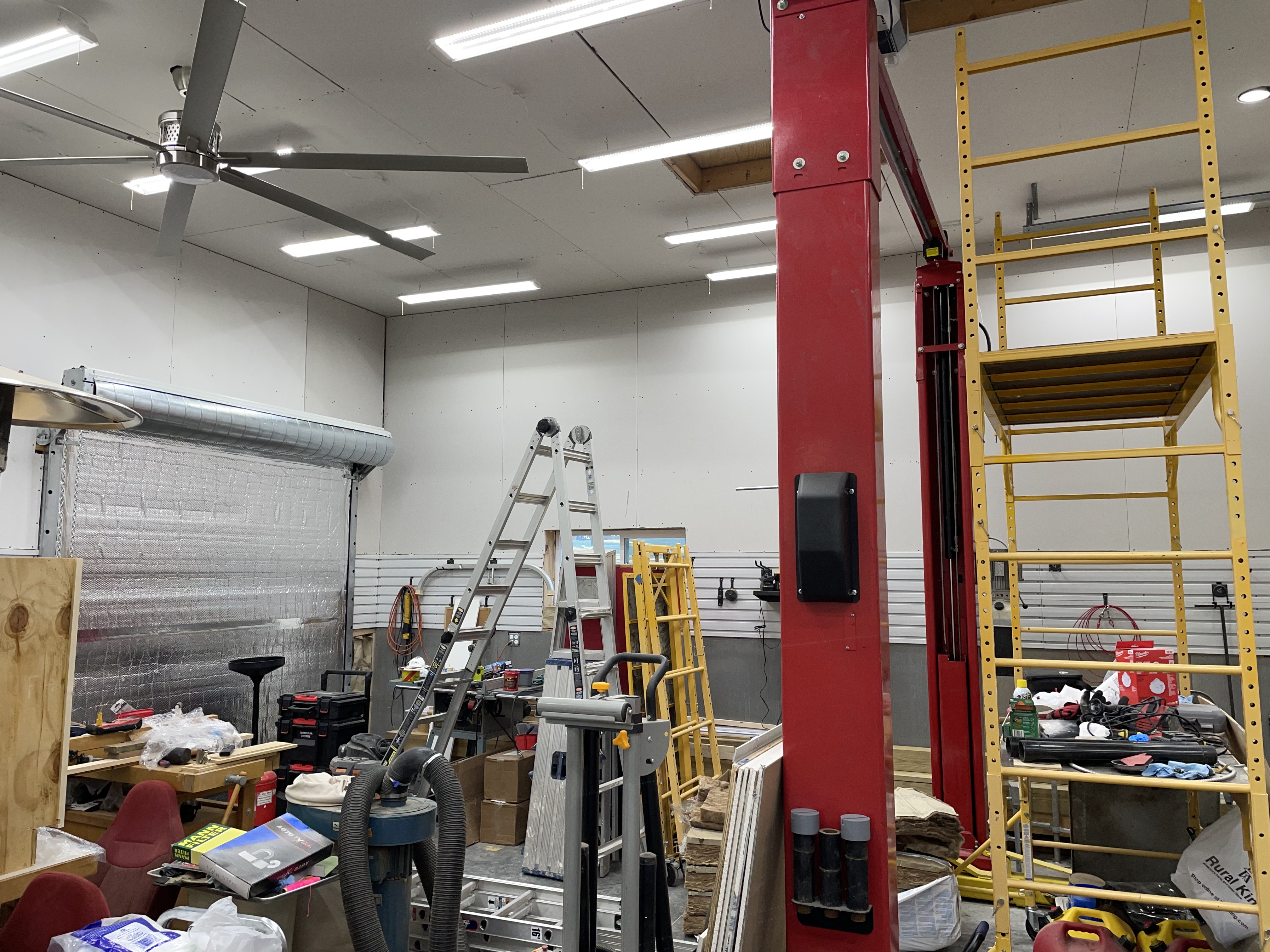

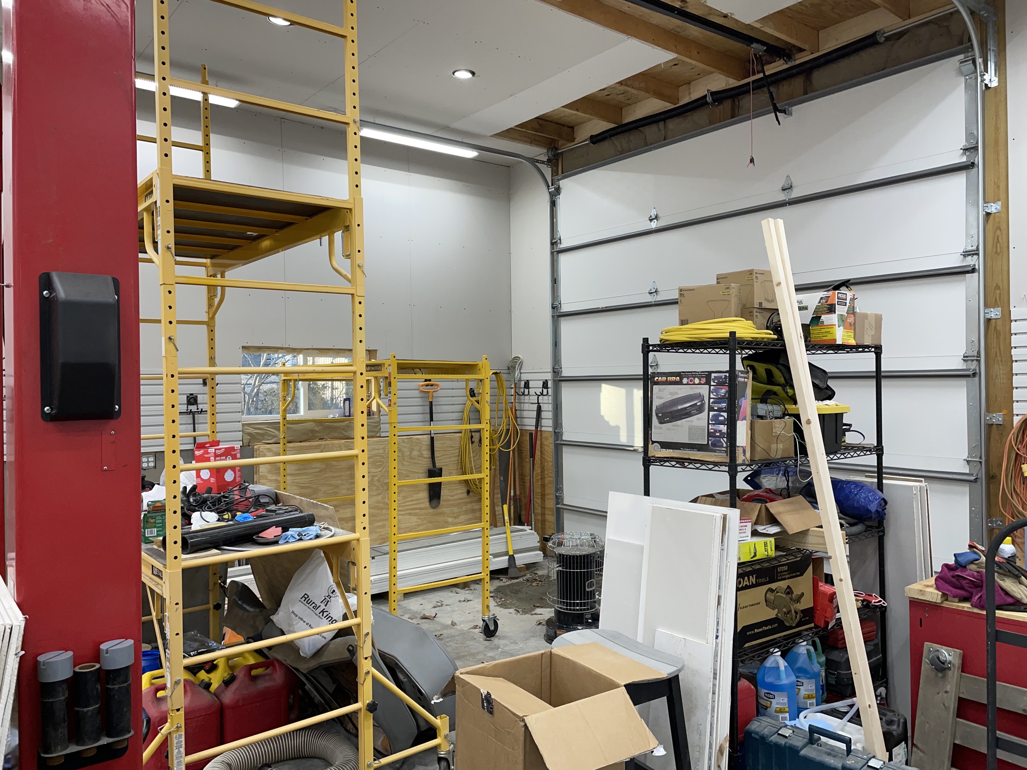

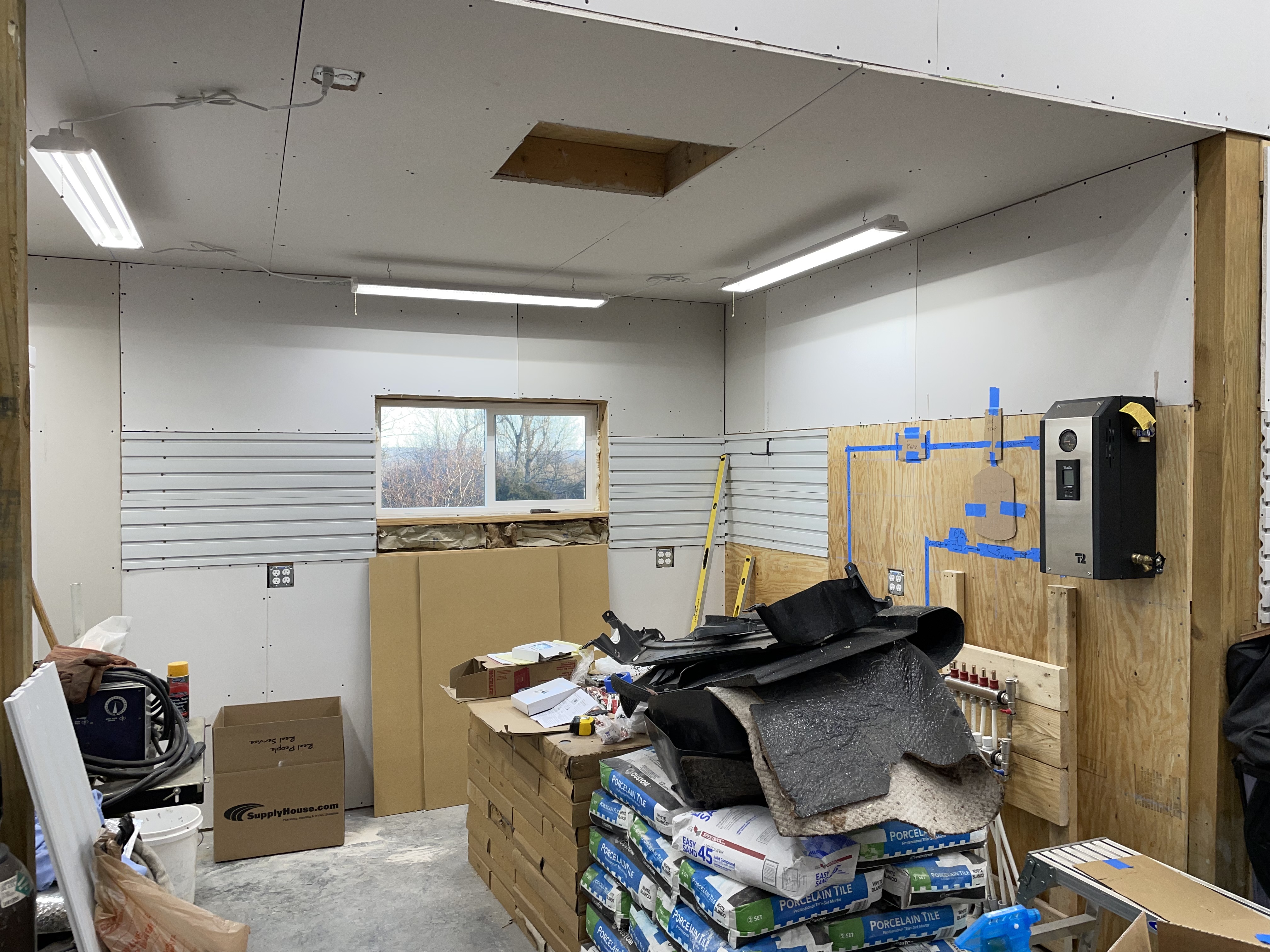

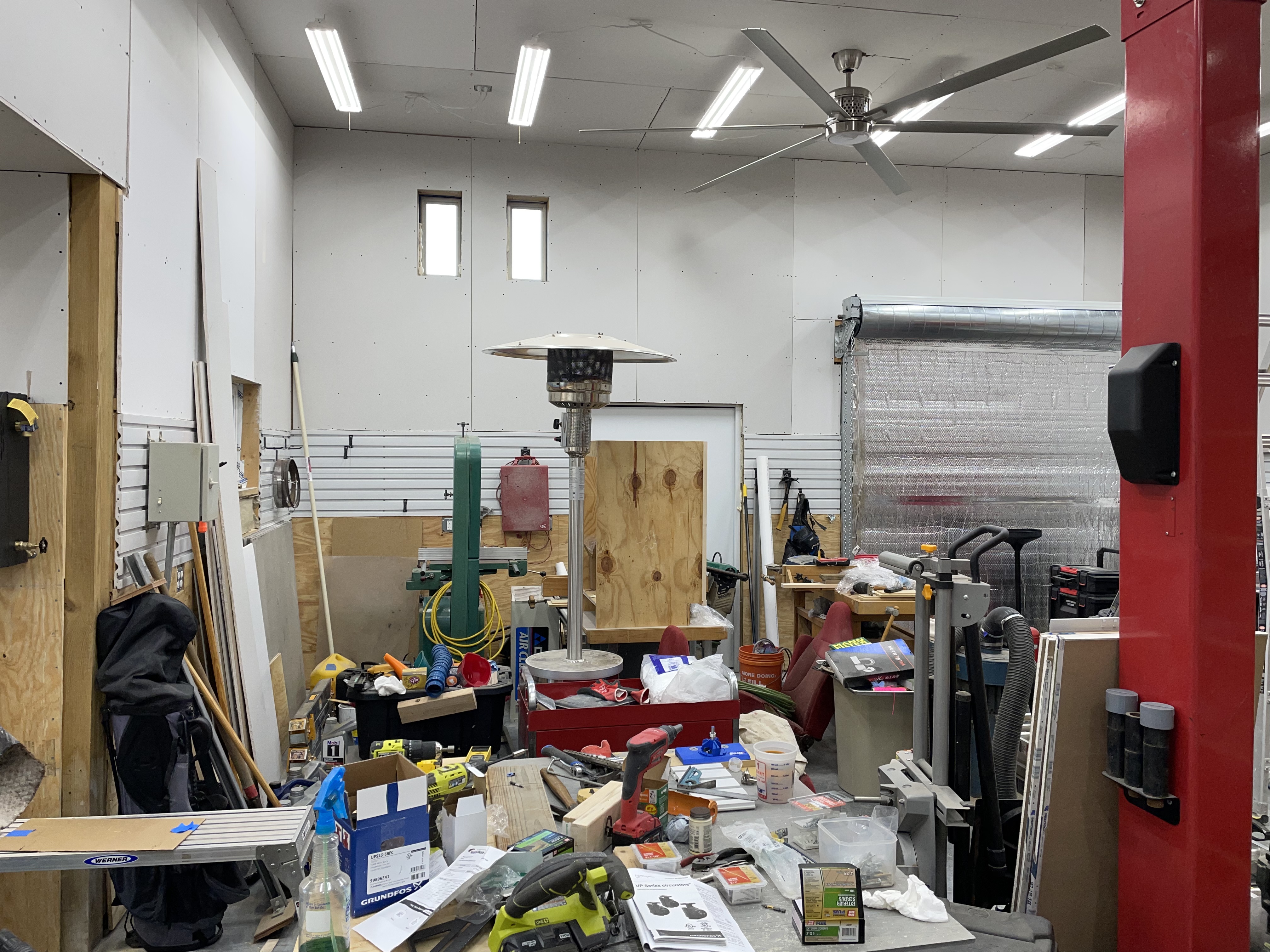

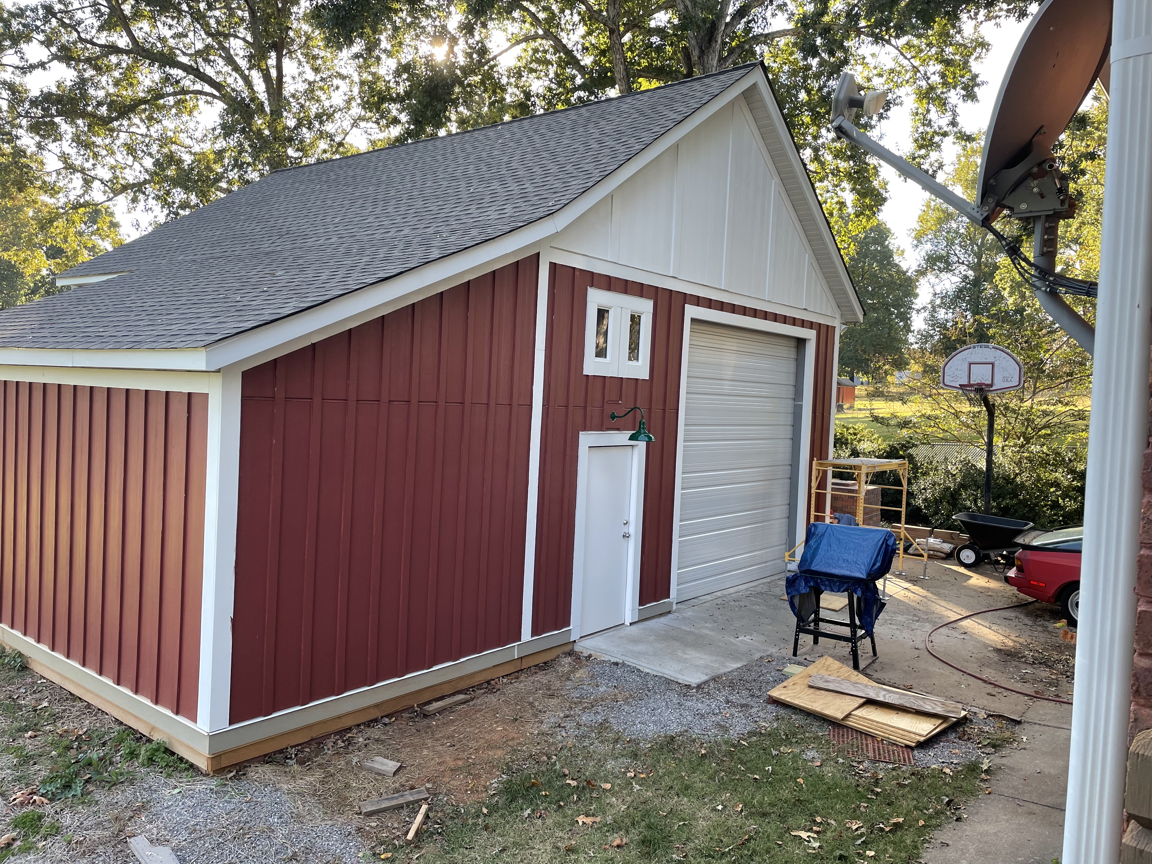

Tom encouraged me to post some pictures and info about the shop I am still in the process of completing. I built it mostly myself, only contracting the concrete slab and putting shingles on the roof. It is about 1000 sq ft and I think I am in all in at $45,000. I am almost done hanging the Sheetrock, still have to do small areas and am 1 part short of having my radiant floor heating running. Once I have heat, I will start the mud and tape work. Attached are recent pictures.
- 7B0C1C05-A717-487F-8806-F83C948A5B17.jpeg (3.48 MiB) Viewed 992 times
- 02A1D3EE-A8A2-4737-A452-2027C41532C4.jpeg (3.66 MiB) Viewed 992 times
- A7DEA206-5484-479F-8946-4739BA9D0BF7.jpeg (3.78 MiB) Viewed 992 times
- 0BF0CAE6-C7A4-4FFC-B2EB-876AE76BFEEA.jpeg (3.5 MiB) Viewed 992 times

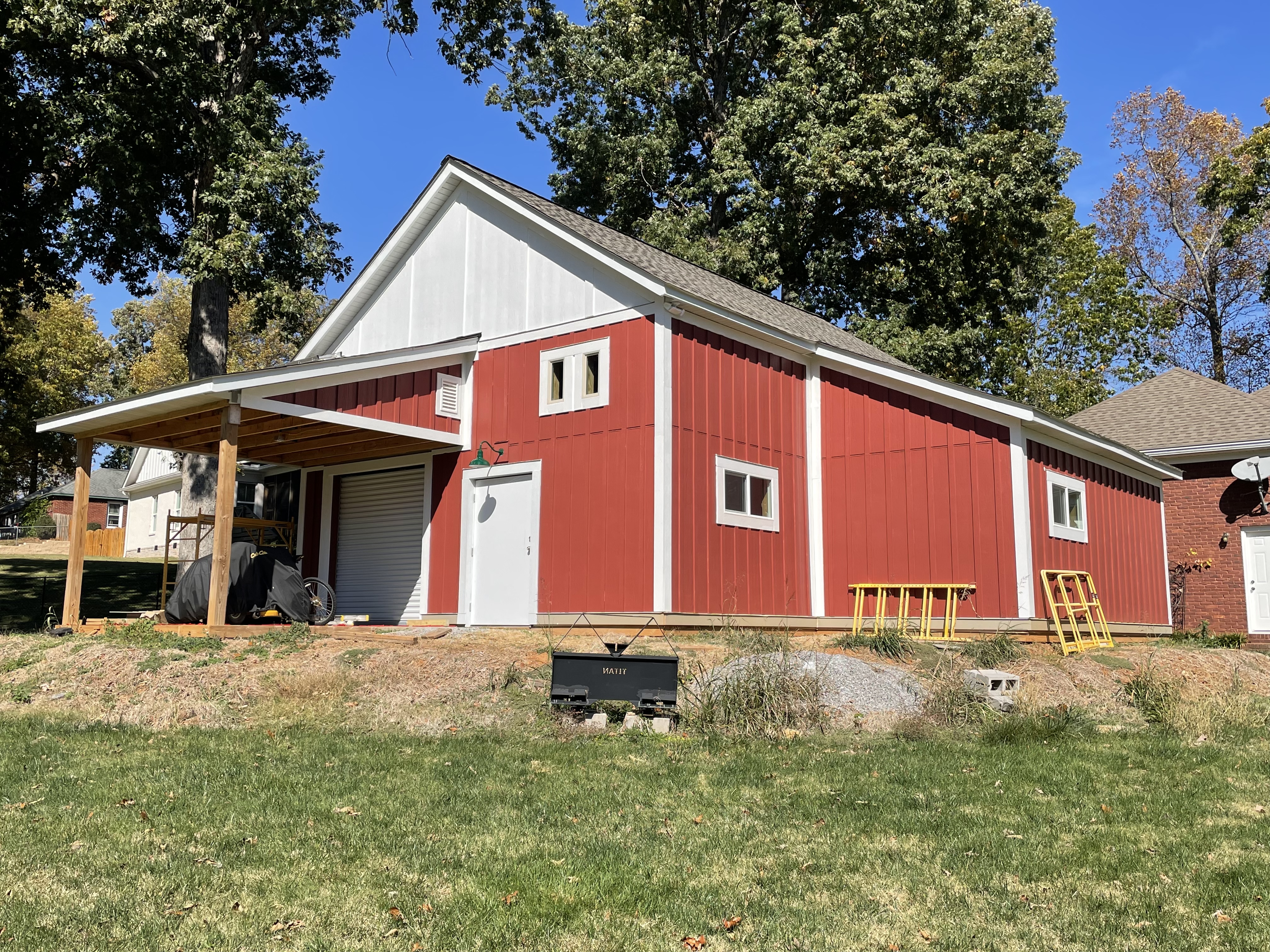

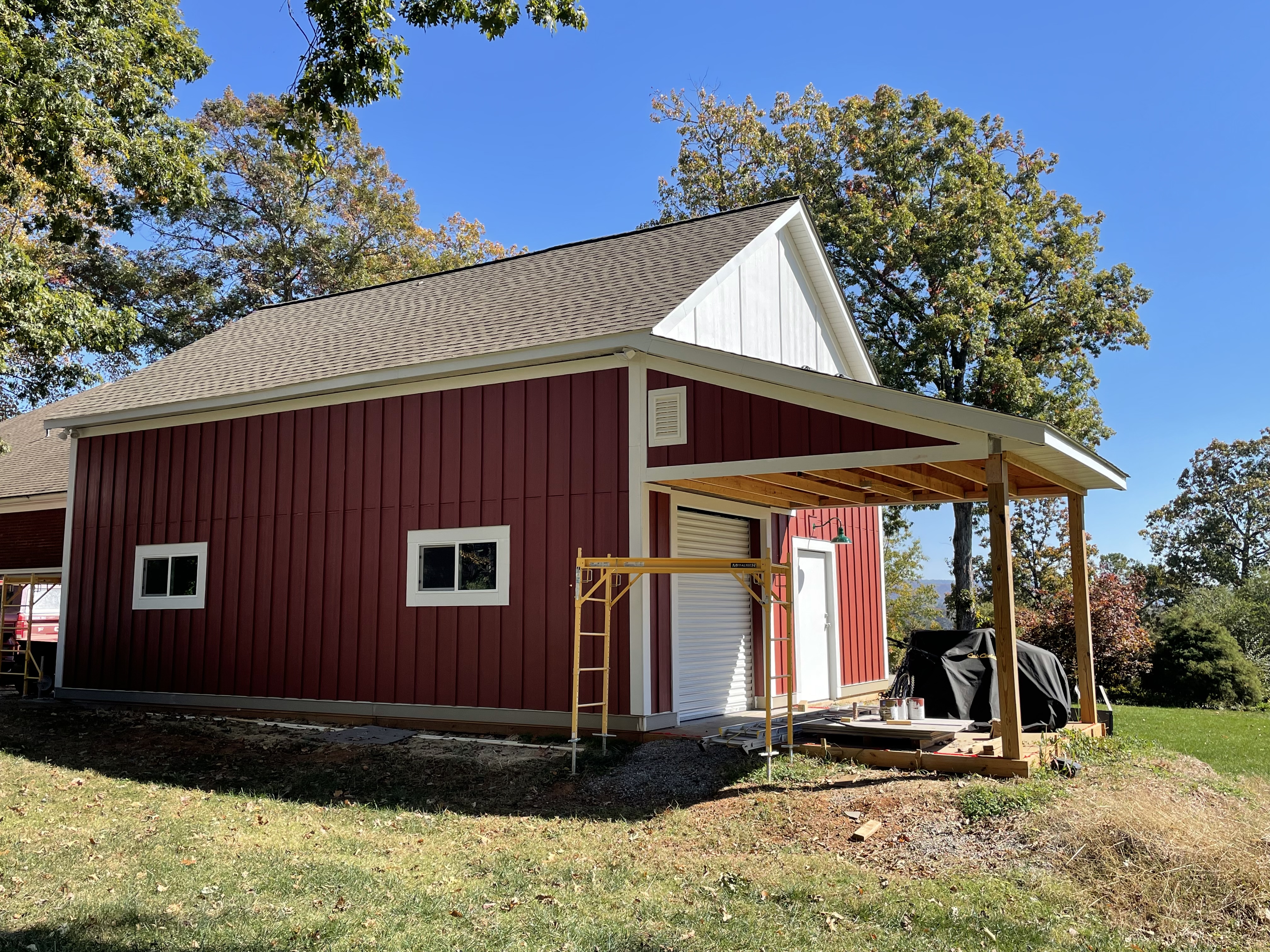

Here are some exterior pictures
- East Side and Rear
- 866C0001-FFD9-4502-B3F3-38637F2D4D3A.jpeg (4.95 MiB) Viewed 990 times
- West Side
- BB11E0F9-D53B-4A50-A04F-F68593DB8BDD.jpeg (5.74 MiB) Viewed 990 times
- Front
- F385A553-5E38-488D-92BC-7FC671EA1BAE.jpeg (5.24 MiB) Viewed 990 times

Now I'm really envious! This looks great!

Looking good! You're going to have a great shop with a lot of room. It looks bigger than 1000 sq ft. Will be great to see it after it's completed and set up.
