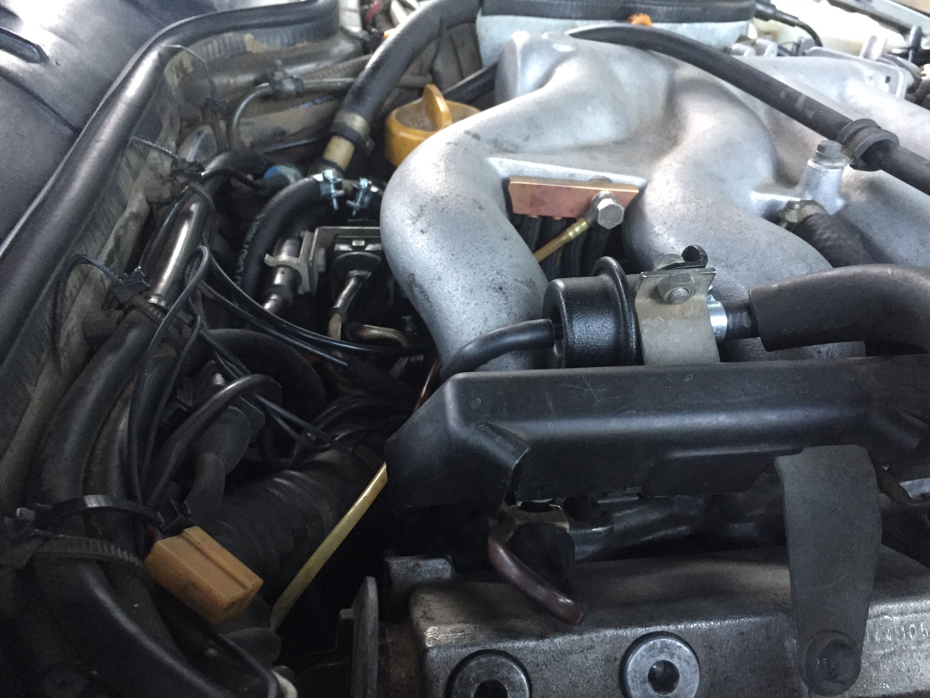

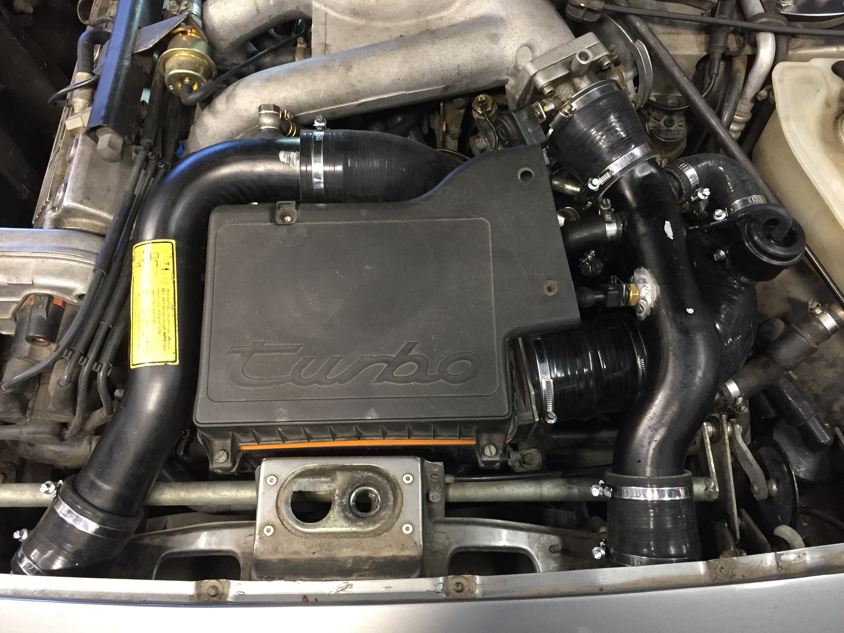

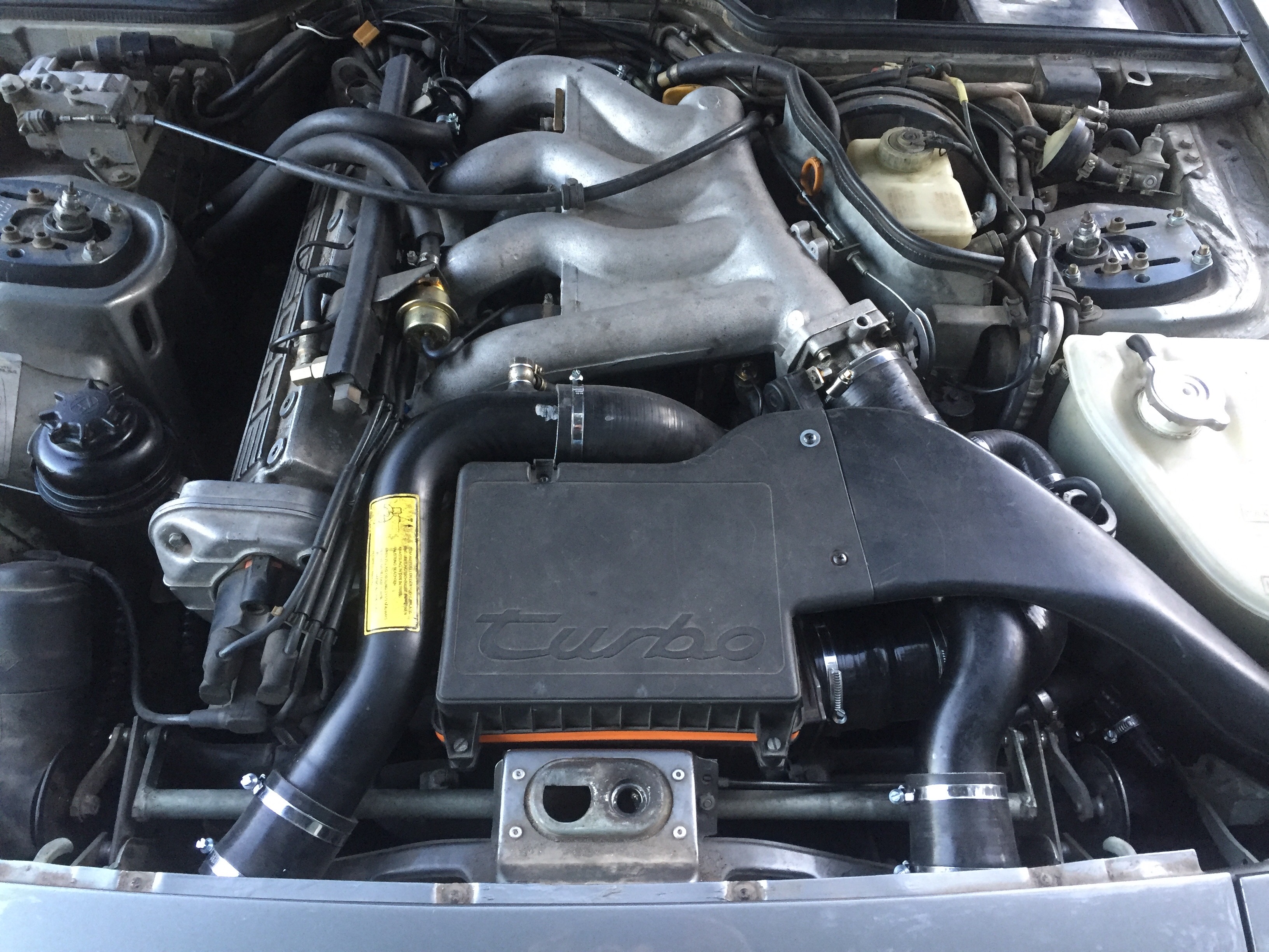

Attached are some pics of my engine bay. A super-knowledgable old-school smog tech would find issues, but most do not know what they are looking at.

Wow, that does look pretty darn stock! It "seems" like most shops have become a bit more lenient on the visual over the years, so something like would pass the visual just about every time I suspect. Back in the 80's, I once had to 'buy' a $20 wingnut from a smog shop for the top of an old V8 air filter lid because the hex nut I used 'didn't pass visual.' The 'test only' centers did away with those kinds of shake downs, which were all too common. But also, because smog testing is their sole source of income, 'test only' centers have incentive not to be known as nit-picky. Thanks to the internet, if a shop failed this car because of the Laust manifold or whatever, it would be all over Yelp and hurt their business. Not to mention most shops give free or half price second tests -- so nit-picking little things just means they doubled their work for no particular reason. Just my two cents....

If you look closely, there is no AFM whatsoever, VEMS uses MAP/speed-density for air mass estimation. I hogged out a factory 1980s BMW AFM adapter tube to 3" ID, and have a black silicone coupler with a sleeve connecting to a Lindsey J-boot. Again, this would not fly if the smog tech is familiar with Bosch L-Jet and/or its successors . . . .Tom wrote: Sat Oct 09, 2021 2:06 pm

Nice work -- looked like a real AFM to me. Is the air flowing through the stock filter box this way? Have any pictures of what you did there?
