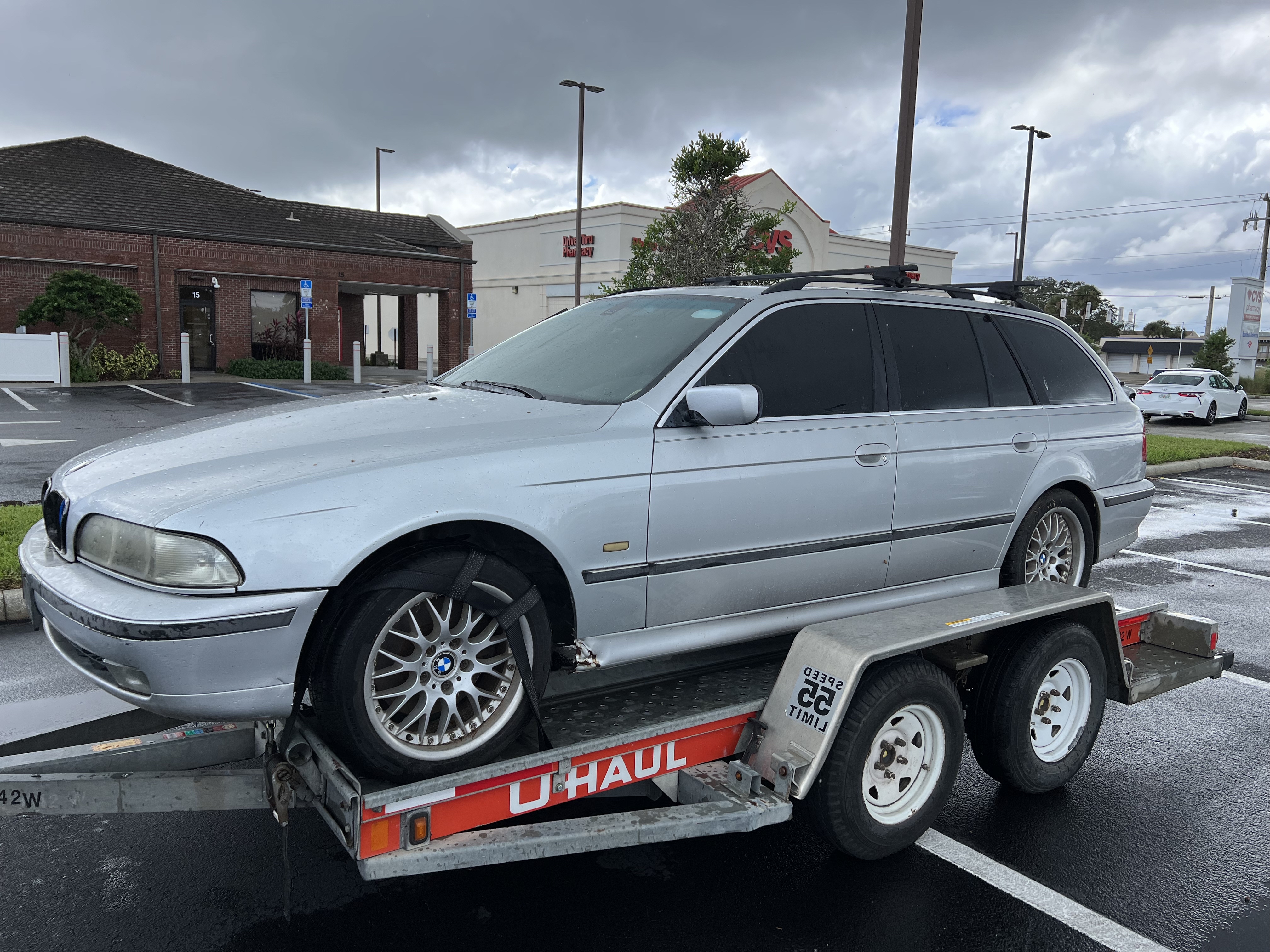

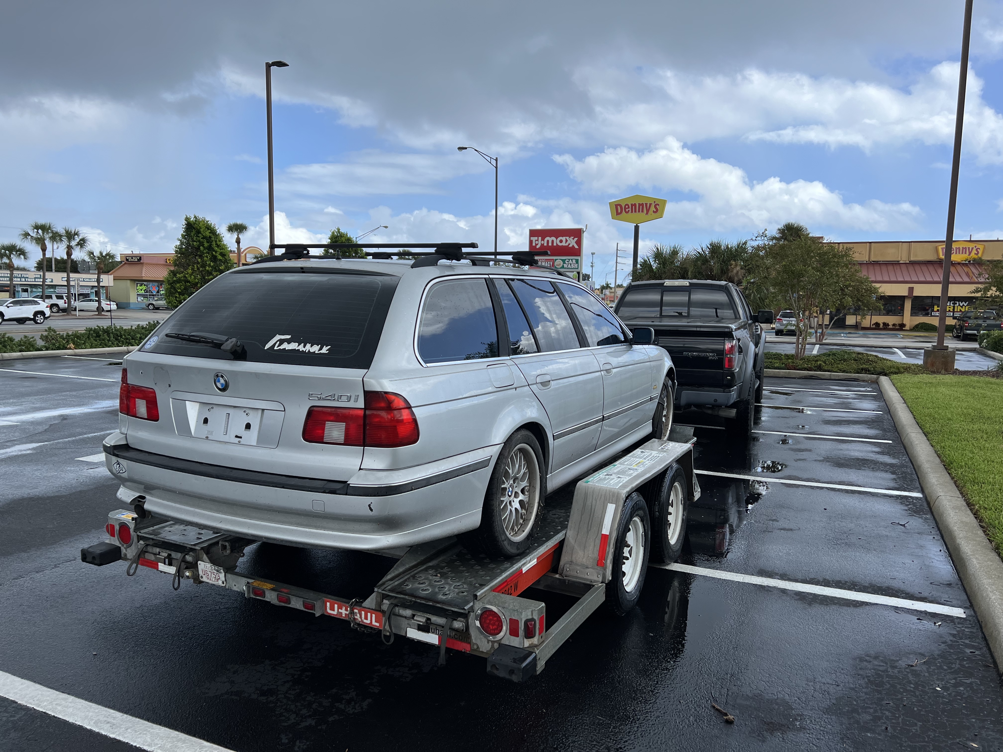

THIS...is a 2000 BMW E39 540i wagon, and I'm going to save it.
I bought this for $600 last Friday on a whim. I've had an E91 since early this year, but it's an AWD auto wagon, and I'm just not in total love with it after having driven it a bunch now. V8 RWD wagon is more up my alley, and has many benefits. One of them is going to be towing 944s around (eventually).
This one I'm just planning to save. It was parked 2 years ago because the harmonic balancer left the chat, and took the serpentine belts with it. When the harmonic balancer gave out it also took out a coolant hose so it was towed back. It had not started in over a year and it amazingly did when I came to look at it -- and moved under it's own power to a better spot for me to check it out. Cleaner chassis than you'd think by looking at pictures, and the engine is better than you'd think. The driver's fender was (said to be) replaced from a tire exploding on the 2nd owner, and that's why the sill is messed up. Some fender alignment work is needed, and new wheel liners. Would love to mess with and fix that sill.
I wanted to leak down check it but couldn't get to turn the crankshaft to get to TDC. Compression test it was, and it was pretty good. Each bank was 30-40 psi of each other, and this is on a dead cold motor. Timing chain guides are going to need to be done, and it came with a new harmonic balancer and crankshaft pulleys.
Not sure what my plans are, I have a 924S to finish, and my E91 to sell before I can really sink into this. One friend of mine has already asked about wanting to buy it when I fix it up. No idea how far I'll take it, mechanical work at the minimum and maybe some interior and exterior work.
