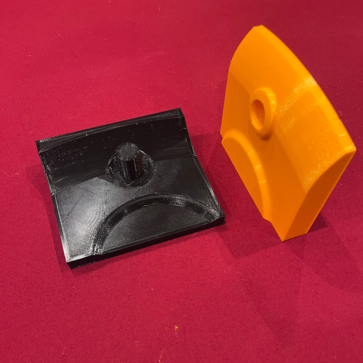

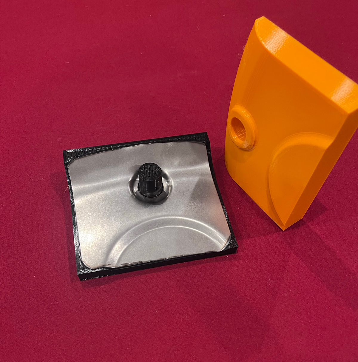

I posted some of this in its own thread, but to keep my 450SL blog complete, here's what I've come up with so far to make a patch panel that won't be obvious. These stamps come right off the 3D printer and are just one more reason I think all shade-tree mechanics should have a printer. :) Now I just need to find time to actually put it in...

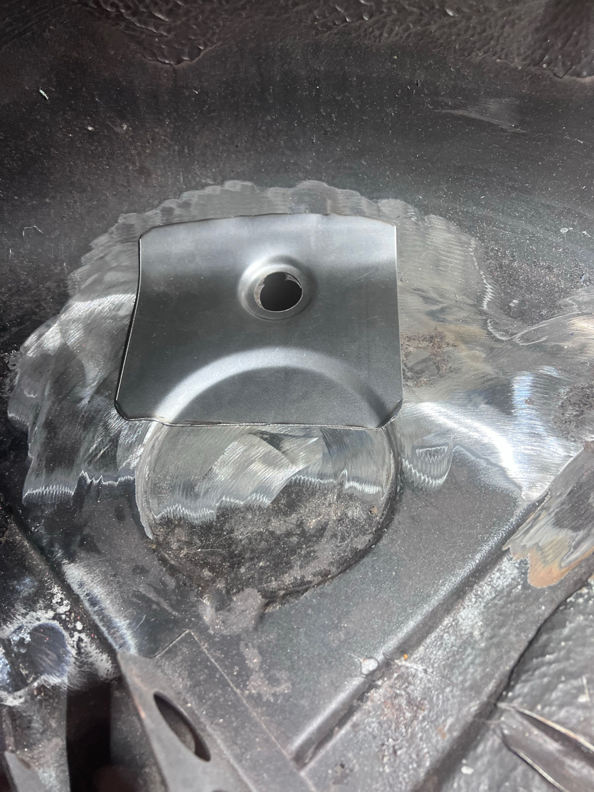

Inspired by some of the recent body work pictures here on Carpokes, I finally got around to making a patch for the trunk and tacking it in. :)

Tom wrote: Sun Jan 22, 2023 5:38 pm Inspired by some of the recent body work pictures here on Carpokes, I finally got around to making a patch for the trunk and tacking it in. :)
Always impressed by the work done by so many of you here. And the 3D stuff with molds, etc is fascinating - I had no idea until I came to Carpokes. Thanks to those willing to share what they're doing!

3D-printed metal stamps and dimple dies started popping up on YouTube and such over the last few years, and people are coming up with all sorts of creative uses. I haven't actually seen anyone else make a custom patch panel like this, but it was a natural extension of what others have been doing. No way I could have come up with the detail in that patch without the printer, unless I got very lucky and found and un-rusted trunk somewhere I could cut up...
