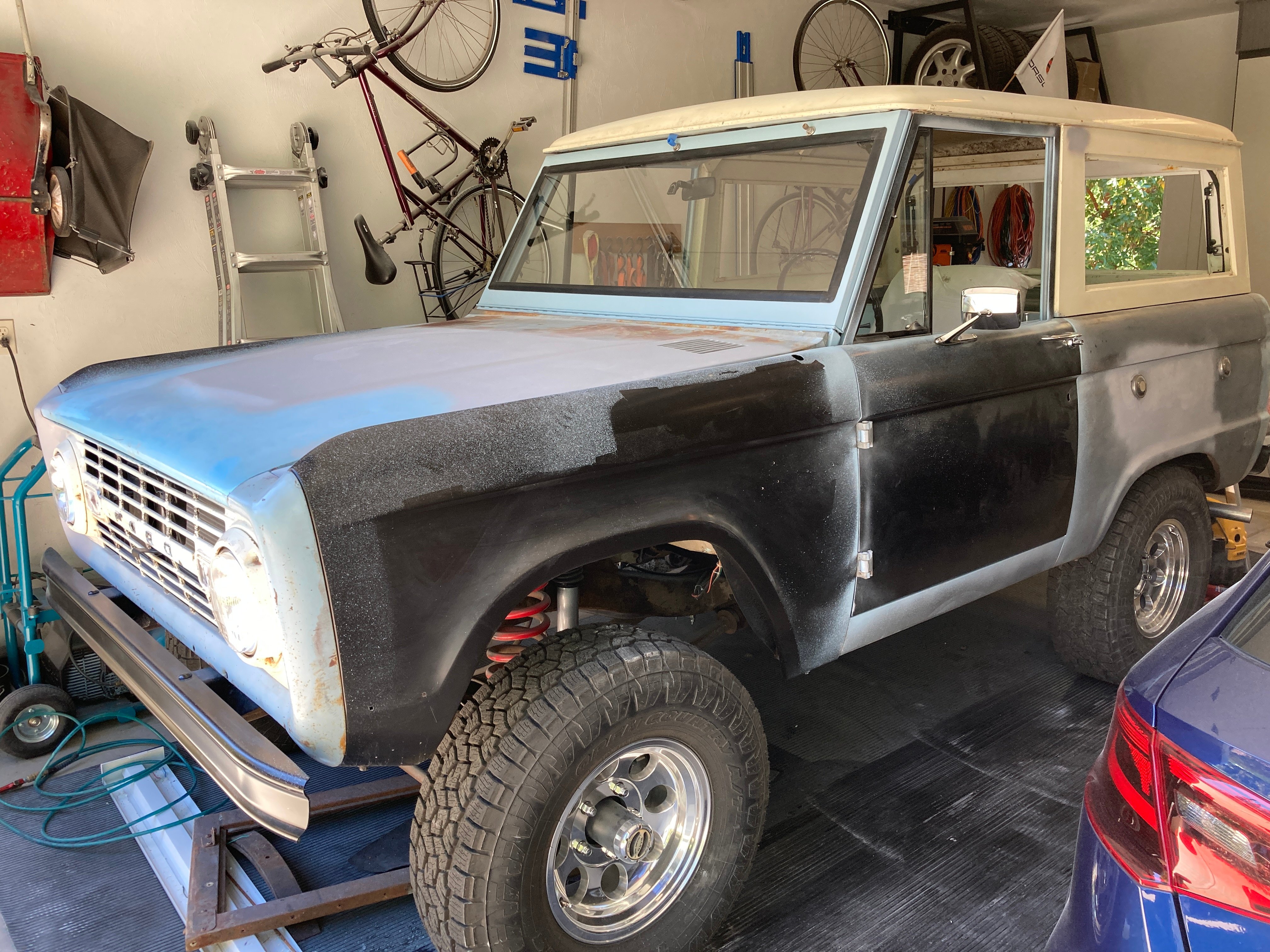

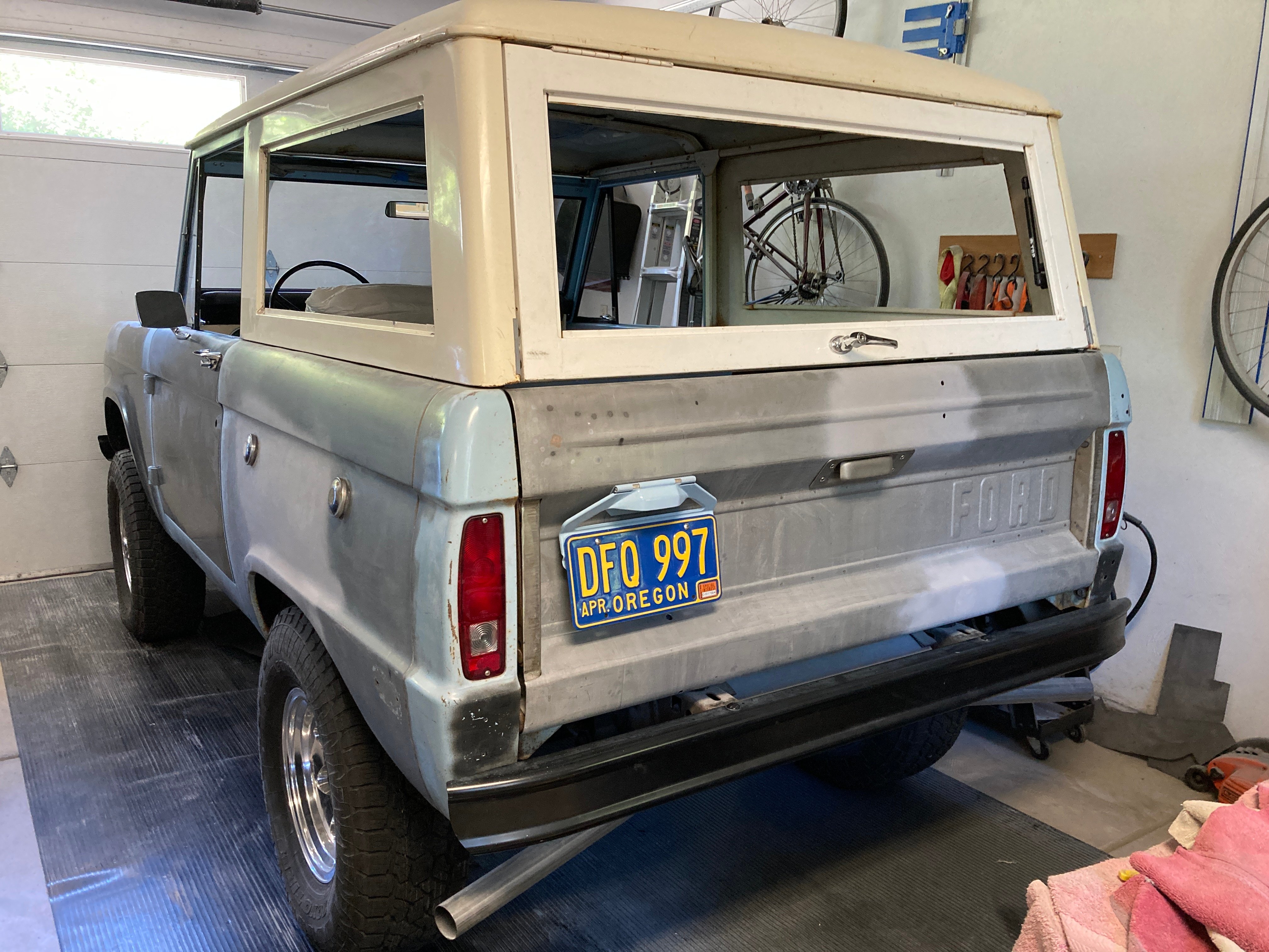

All the odds and ends have been painted, and I think I have finally got the carb dialed in. Yesterday I installed the windshield, cabin bulkhead (freshly painted) and a driver's seat belt. Will start trying to make the hood reasonably straight and presentable next.

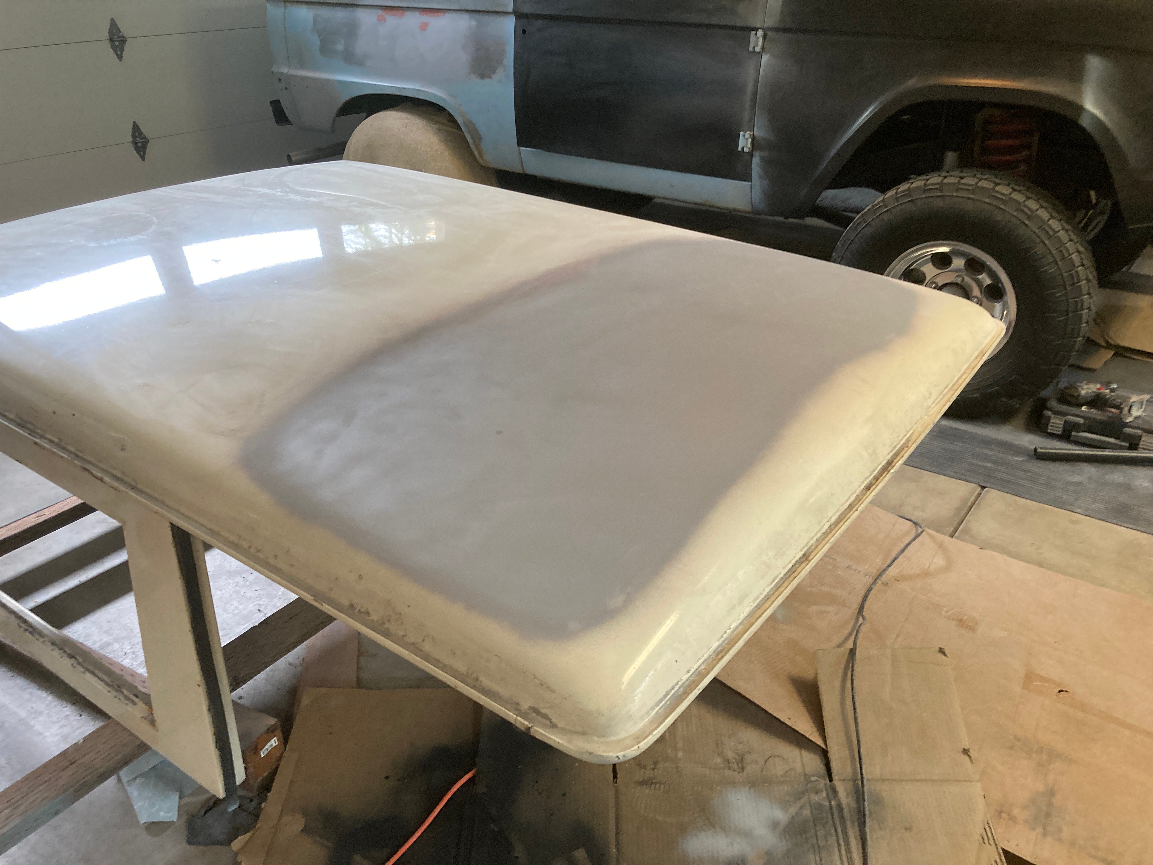

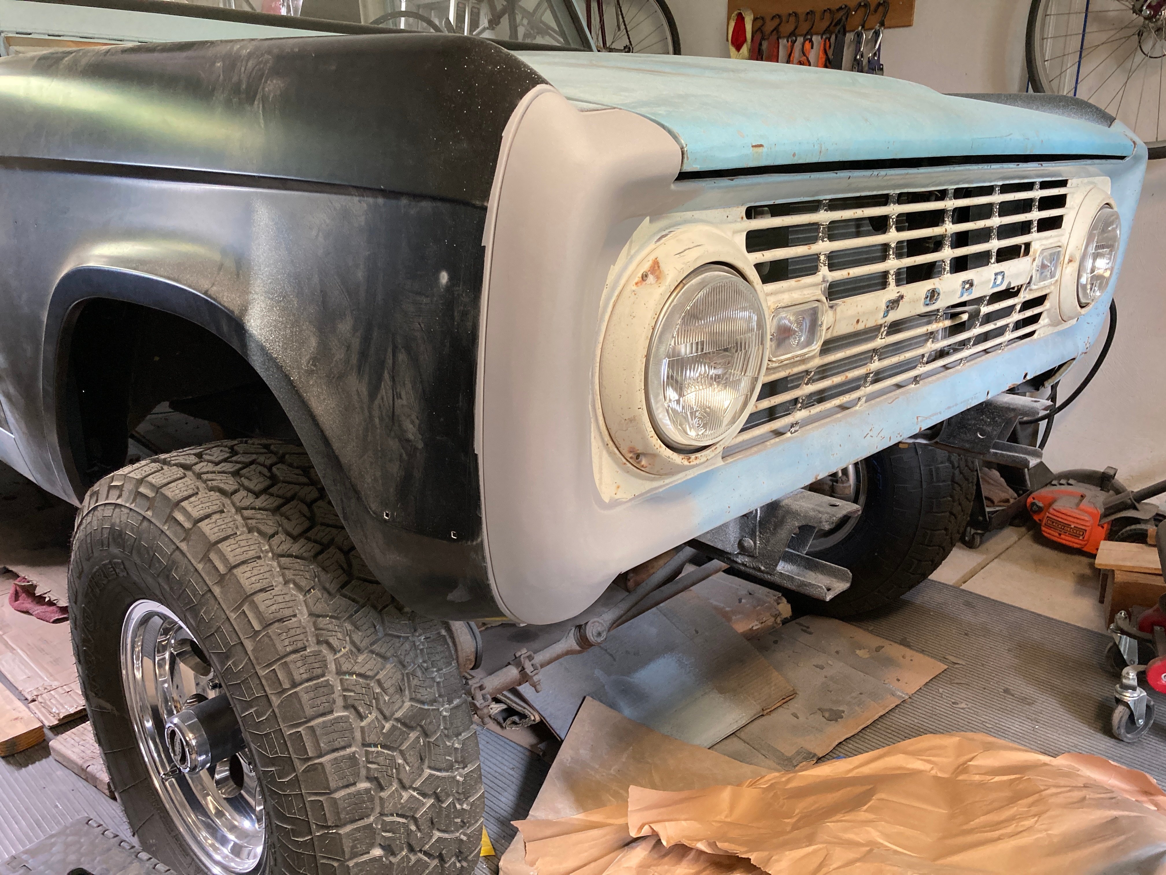

Hood was straightened, reinforced, cracks in edges welded, then installed with hinge shims to adjust the fit. All rear spring bushings replaced. Top removed to ease access to plugging up the hole in the roof from a cheesy, leaking, and broken old sunroof. Final fitting and welding yet to come.

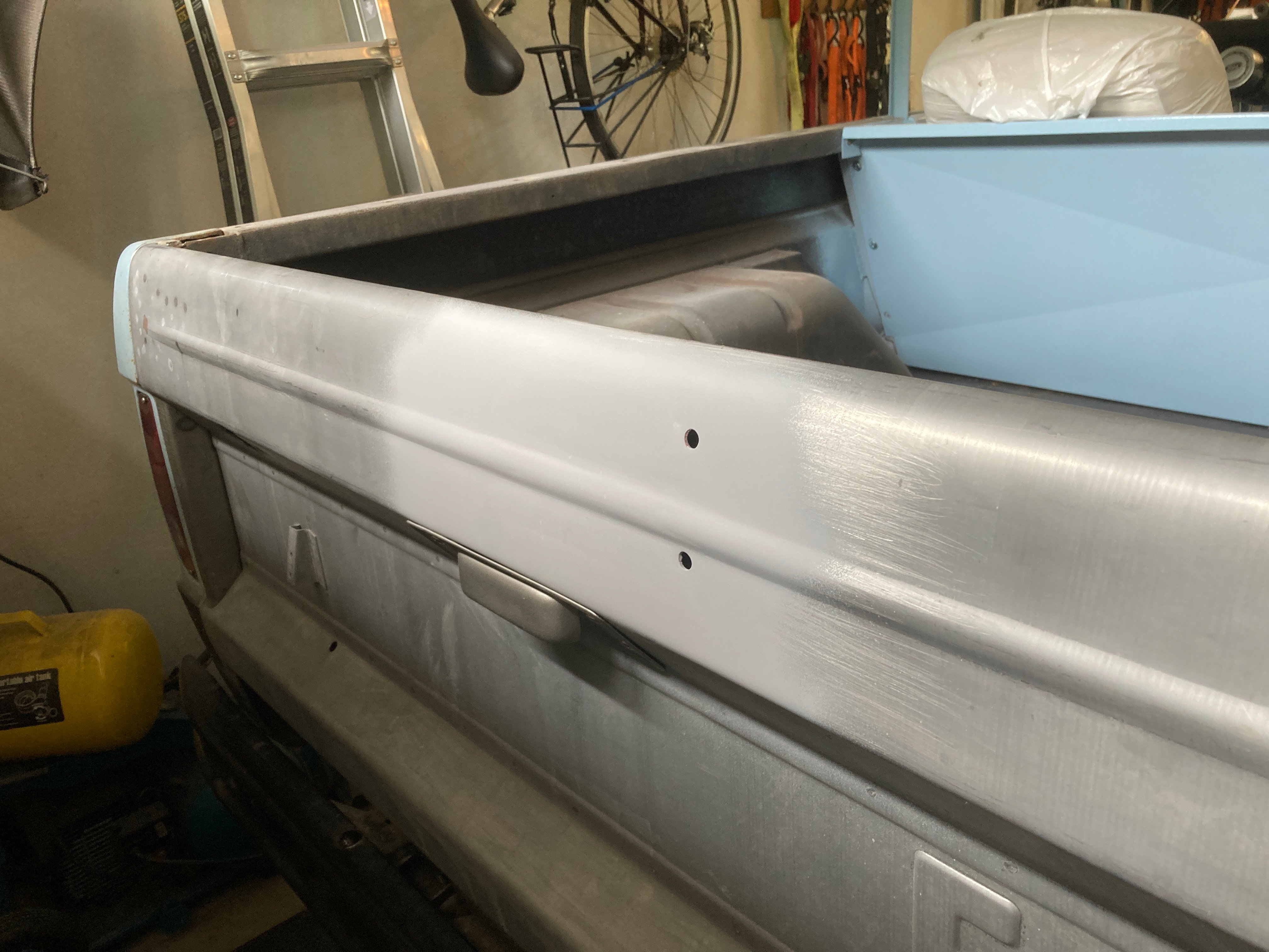

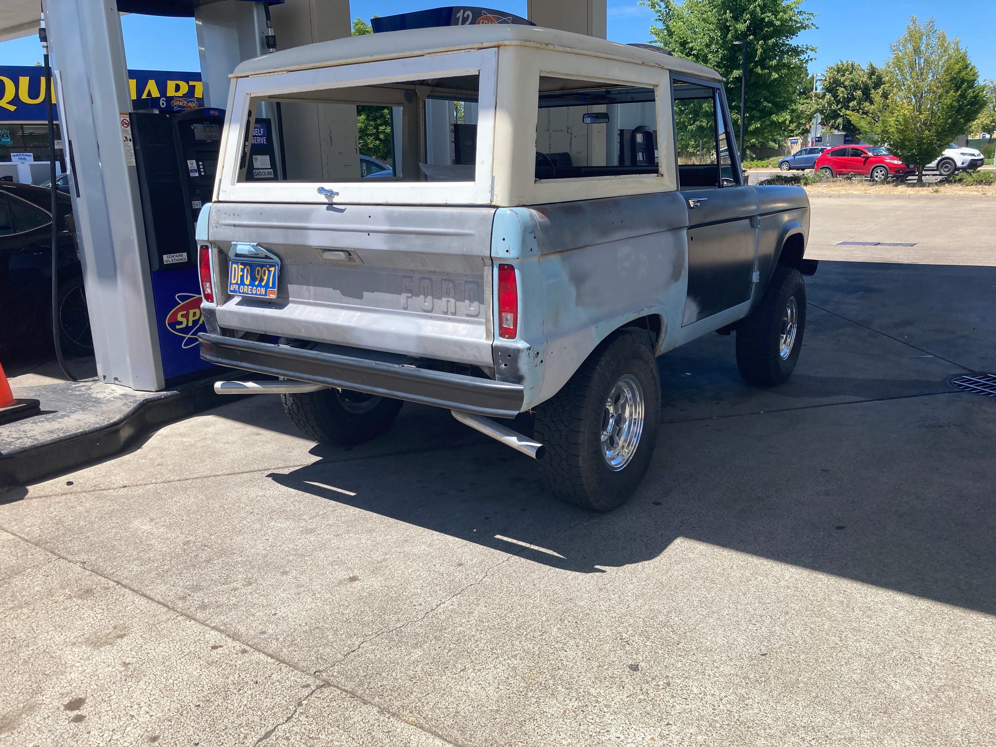

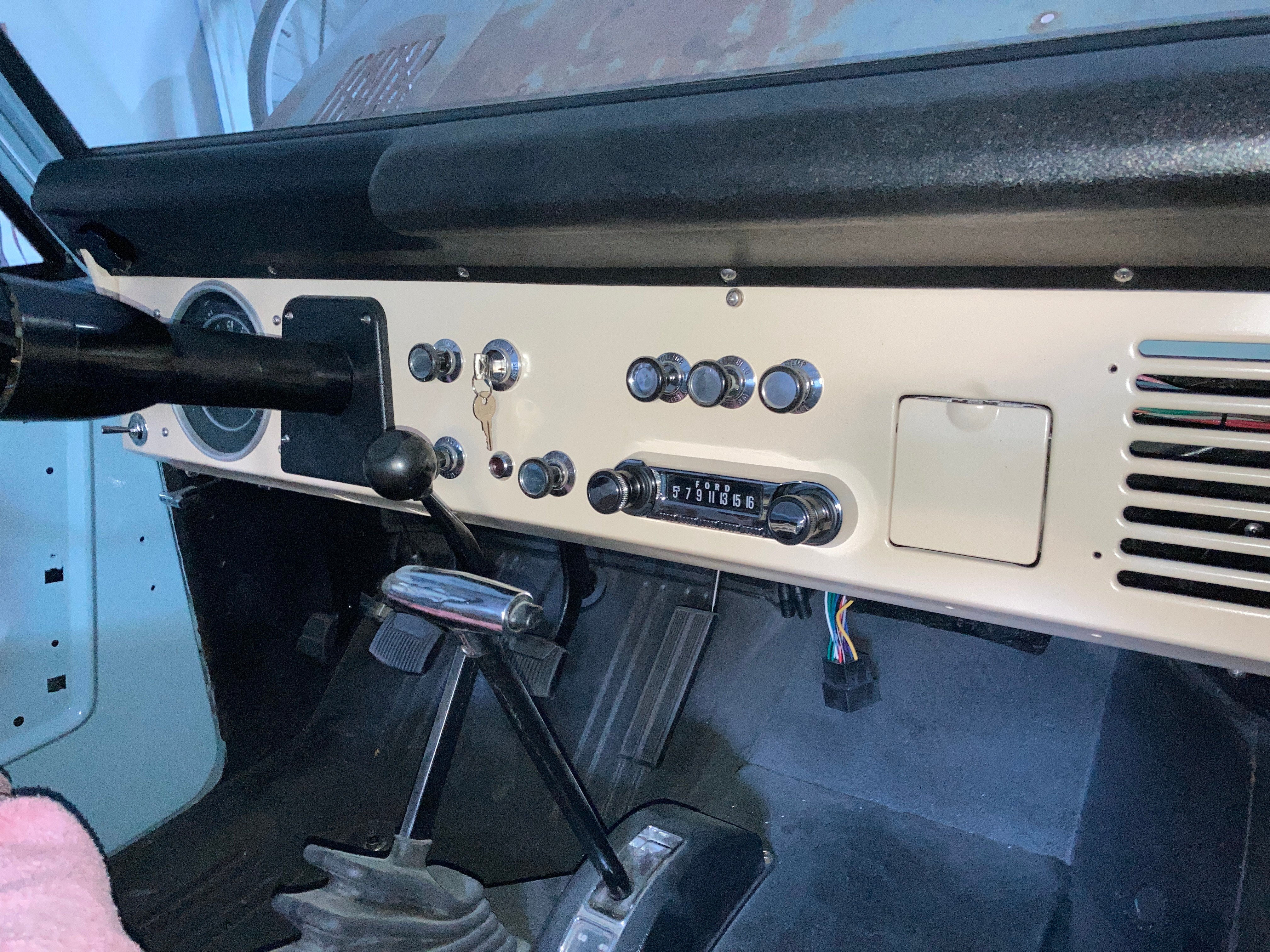

Hi, all. Me again. Thought I'd drop by and update the Bronco progress. Since the last post:
Sunroof hole patch completed.
Other bodywork (simpler repairs than the roof) completed.
Dash completed with a new retro-look bluetooth receiver.
Reassembled for test drives, on classic registration with period plate.
Started driving it, mostly to interview painters.
And today I delivered it to the selected painter. Stay tuned...

Good to hear from you - thanks for the update. I love that simple dash. It's a great reminder of how things were, quite the contrast to where cars/trucks are now.
