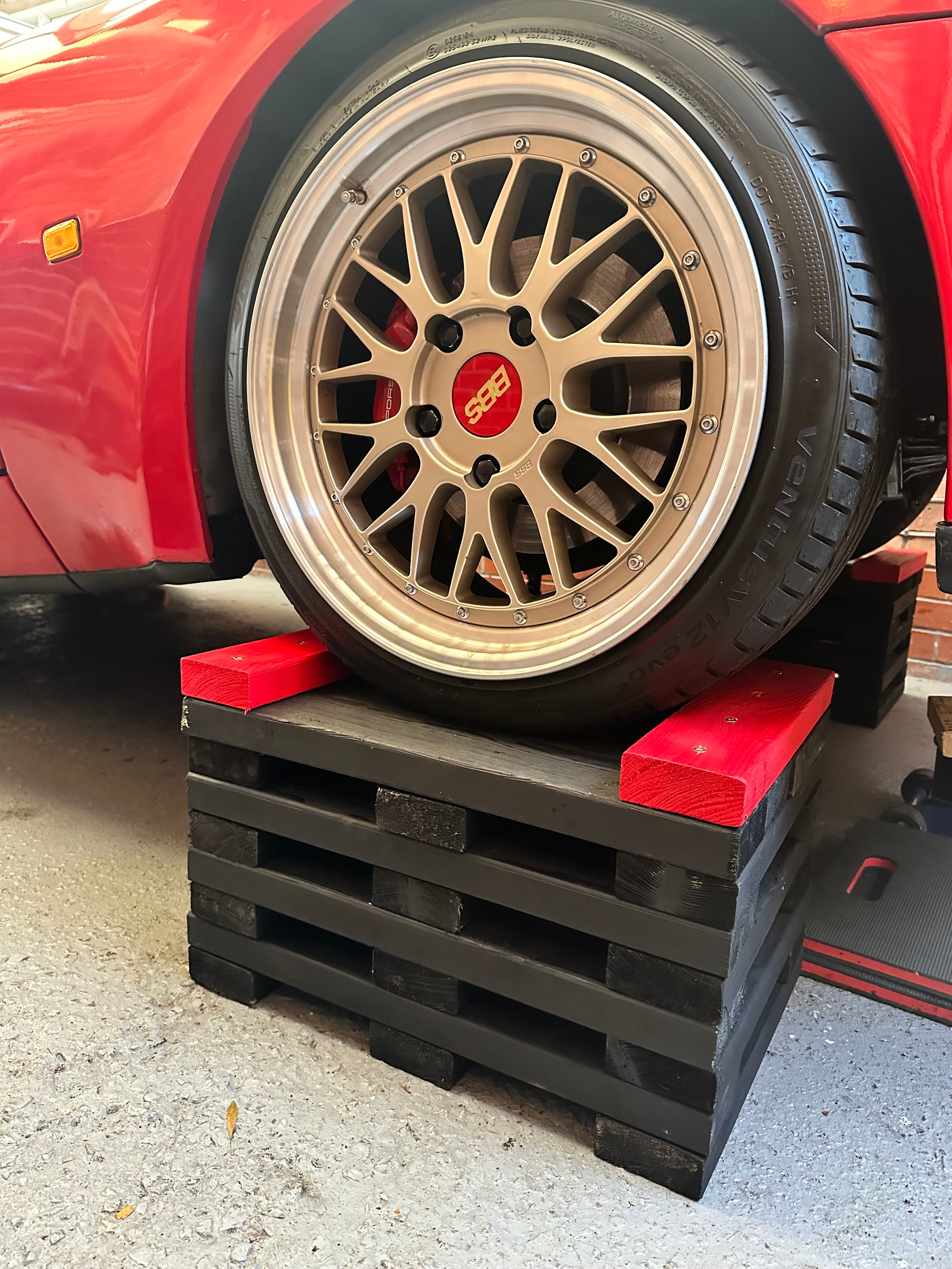

Nice. I like the look and fabrication. Sadly nothing like this in the UK when needed so I made some wooden ones. I'm getting too old to be laying under a car on axel stands.
