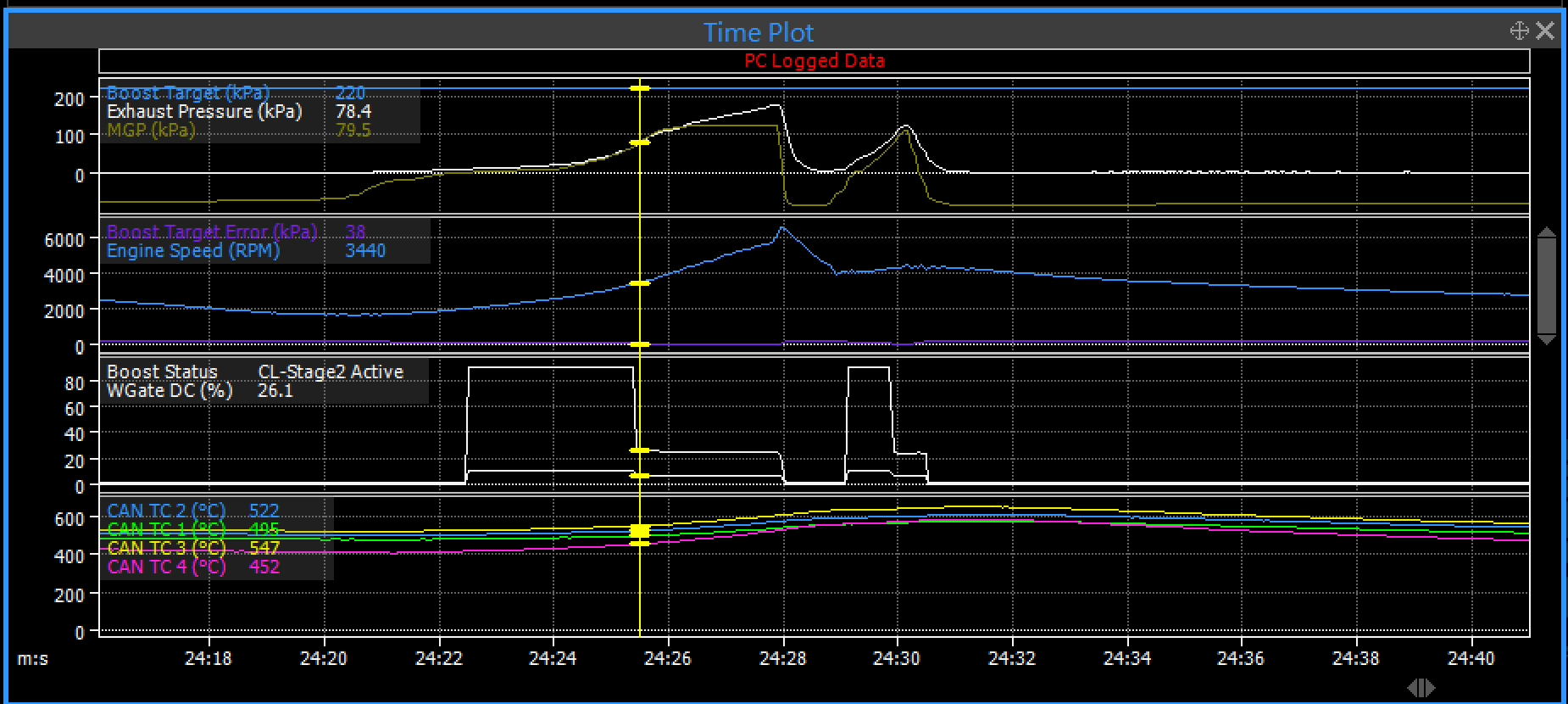

Went upto 1.2bar today, holy cow, you can see my brown moment on the TPS graph :shock: Full boost at 4000, I keep backing off before it hits 6000rpm, I need to find a quieter straight road to really wind it out.

Bergerac wrote: Sat Jun 20, 2026 1:36 am Yeah Im hitting 5.1bar just over 6000rpm.
I think you can fiddle some more on WG duty to spool earlier.
But full beams at 4000 is reasonable

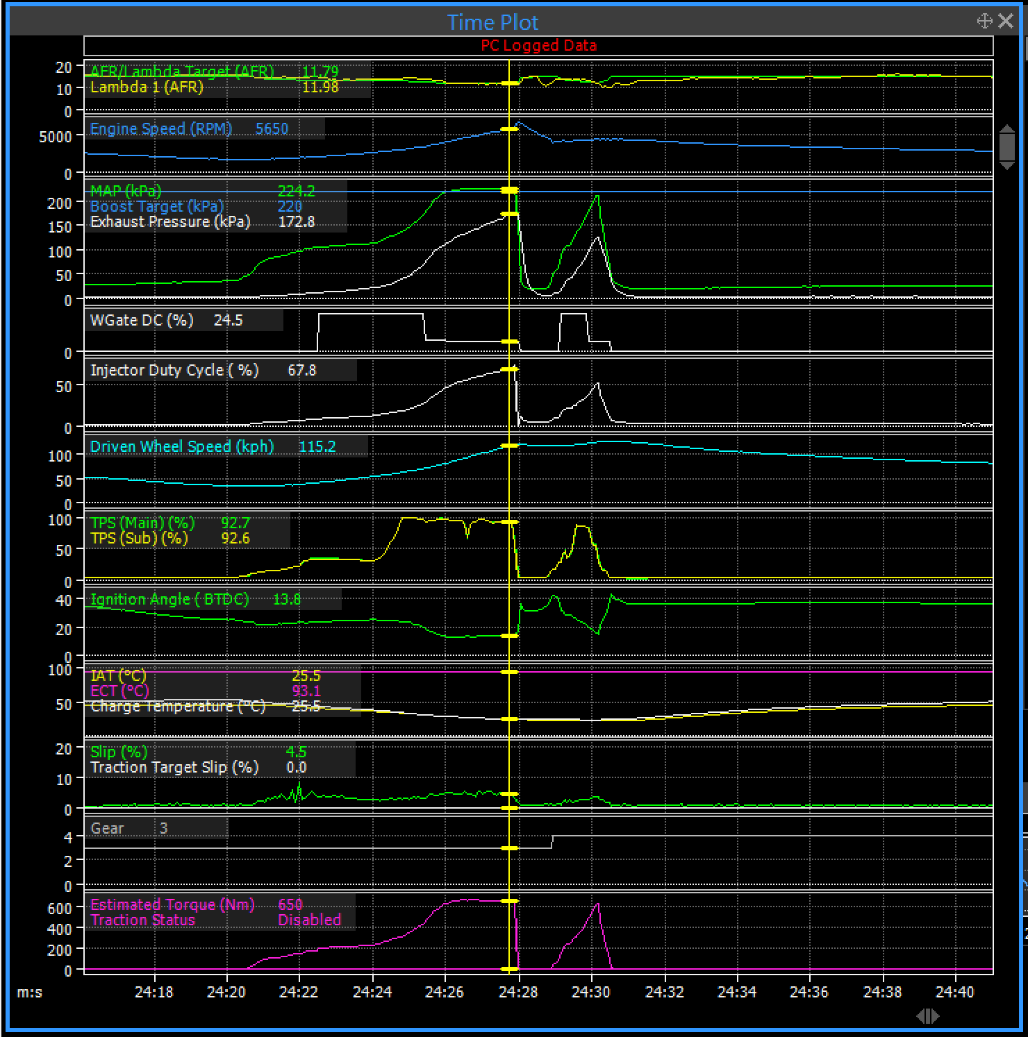

Great logs. Thanks for posting! I'm curious about the 13.8 btdc timing in the second run. Over the years I've dialed my full throttle timing back to almost exactly that (14 if I recall) --to keep the 8v head from blowing off -- and always thought that was below the norm in light of my higher static compression. How did you settle on 13.8?

ealoken wrote: Sat Jun 20, 2026 1:55 am I think you can fiddle some more on WG duty to spool earlier.
There is a tiny bit in it, that was just the first pass to get the base DC right with the closed loop PID zerod out, the boost ratio is pretty much 1:1 right up until the wastegate opens then it drops to just under one for a bit until the turbo catches up again. The boost is super stable so far without much tuning but I might be able to get it down a couple hundred rpm without overshooting. From memory the turbo was originallly built for a 3.2 so it might be slightly on the large size for my engine.
Screenshot 2026-06-21 133303.png (44.22 KiB) Viewed 80 times
Tom wrote: Sat Jun 20, 2026 7:14 am Great logs. Thanks for posting! I'm curious about the 13.8 btdc timing in the second run. Over the years I've dialed my full throttle timing back to almost exactly that (14 if I recall) --to keep the 8v head from blowing off -- and always thought that was below the norm in light of my higher static compression. How did you settle on 13.8?
We started out pretty conservative because were road turning (Im also running 9:1 comp ratio), the plan was to tweak the timing when we had a better idea if there was going to be knock issues but thats proving very hard to do in the higher boost range on the road with the laptop bouncing around all over the place, Im going to have to find a someone to fine tune the timing on a dyno. The other strategy now that I have the knock amplier setup on a spare knock sensor is to confirm the knock detection is working and tune the ignition of the long term knock timing trim tables, the ECU will be much better at detecting it than me.
Bas did share his ignition map for his 968 at one point as well, we had similar numbers but I was running a bit more timing in the cruising cells.
