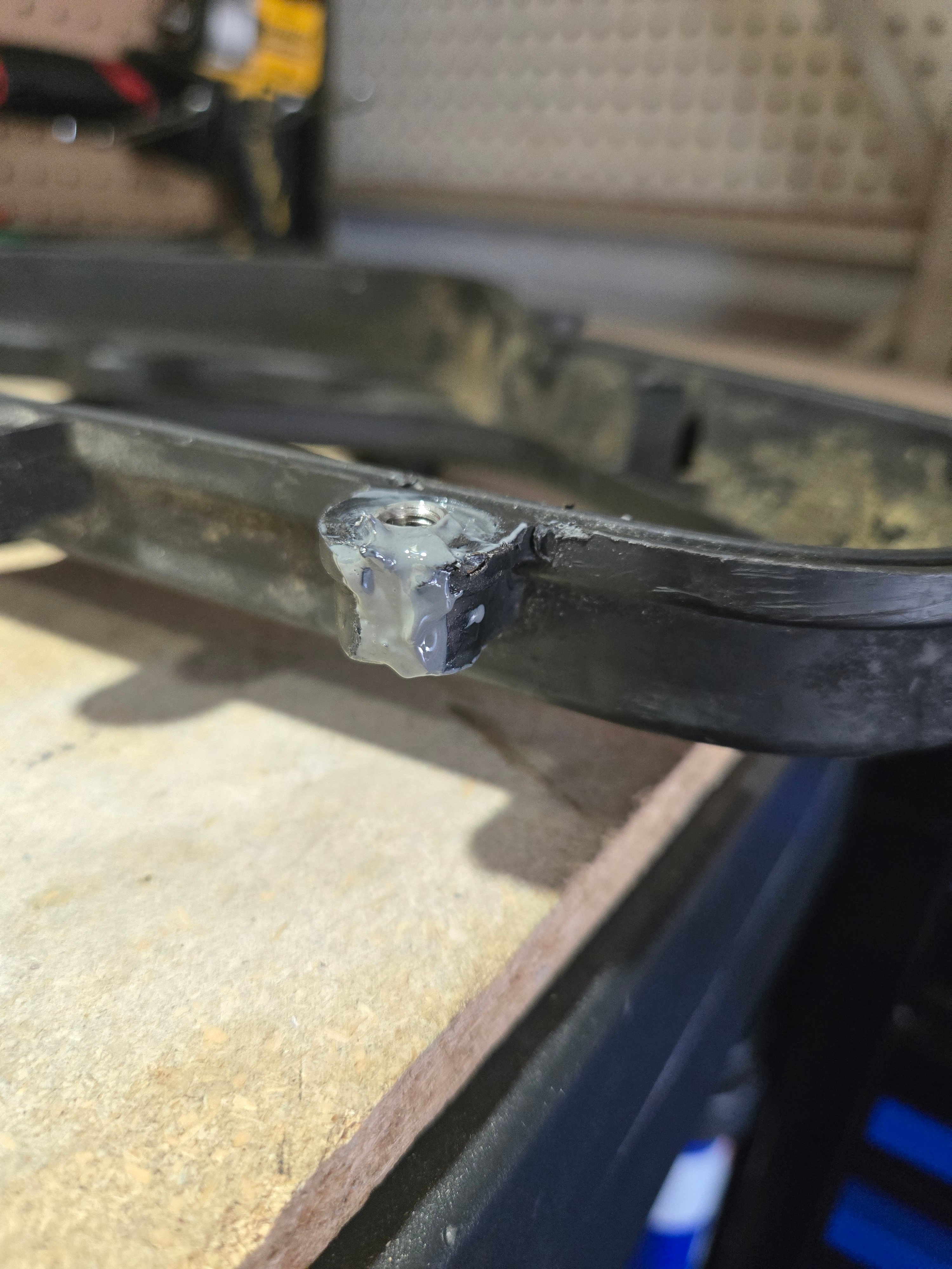

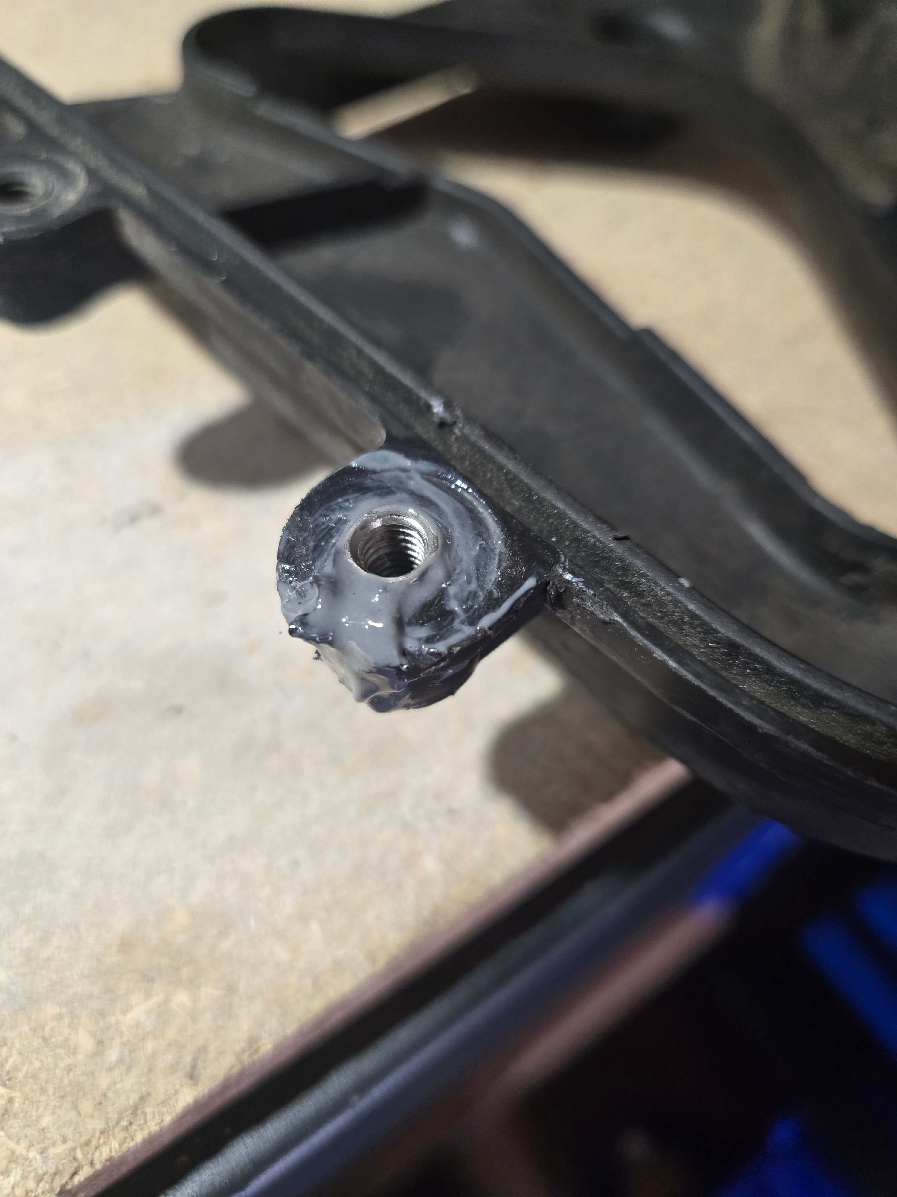

~One (1) of the bolts that secures the front timing belt cover into the rear had a failed threaded insert. I had to cut the bolt to remove the covers; the threaded insert in the rear cover was loose and just spinning.
Going to repair with a heat-set thread insert per Tom in this thread:
viewtopic.php?f=4&p=42096#p42096
Thanks Tom!

Since that part is cracked, I might be inclined to fill the whole thing with jb weld and drop the insert in before it hardens...
#45
Meine44
Posts: 32
Joined: Wed Jan 07, 2026 8:17 am
Been thanked: 6 times
Tom wrote: Wed Jul 15, 2026 6:54 pm Since that part is cracked, I might be inclined to fill the whole thing with jb weld and drop the insert in before it hardens...
To clarify, do you mean JB weld instead of heating the threaded insert?
I do have a plastic welder, but that usually works better with hard plastics. I'm not confident the plastic welder would take well to this softer type of plastic.
There is one other threaded insert that is split like this one but hasn't failed yet. That one will get JB weld / plastic weld treatment as well.

Meine44 wrote: Thu Jul 16, 2026 5:54 am
Yeah, since it is split, I don't think the insert will be secure if you just try to melt it in. I've had luck rebuilding similar tabs with jb weld and those brass inserts. Just the 24 hour version for sure though...

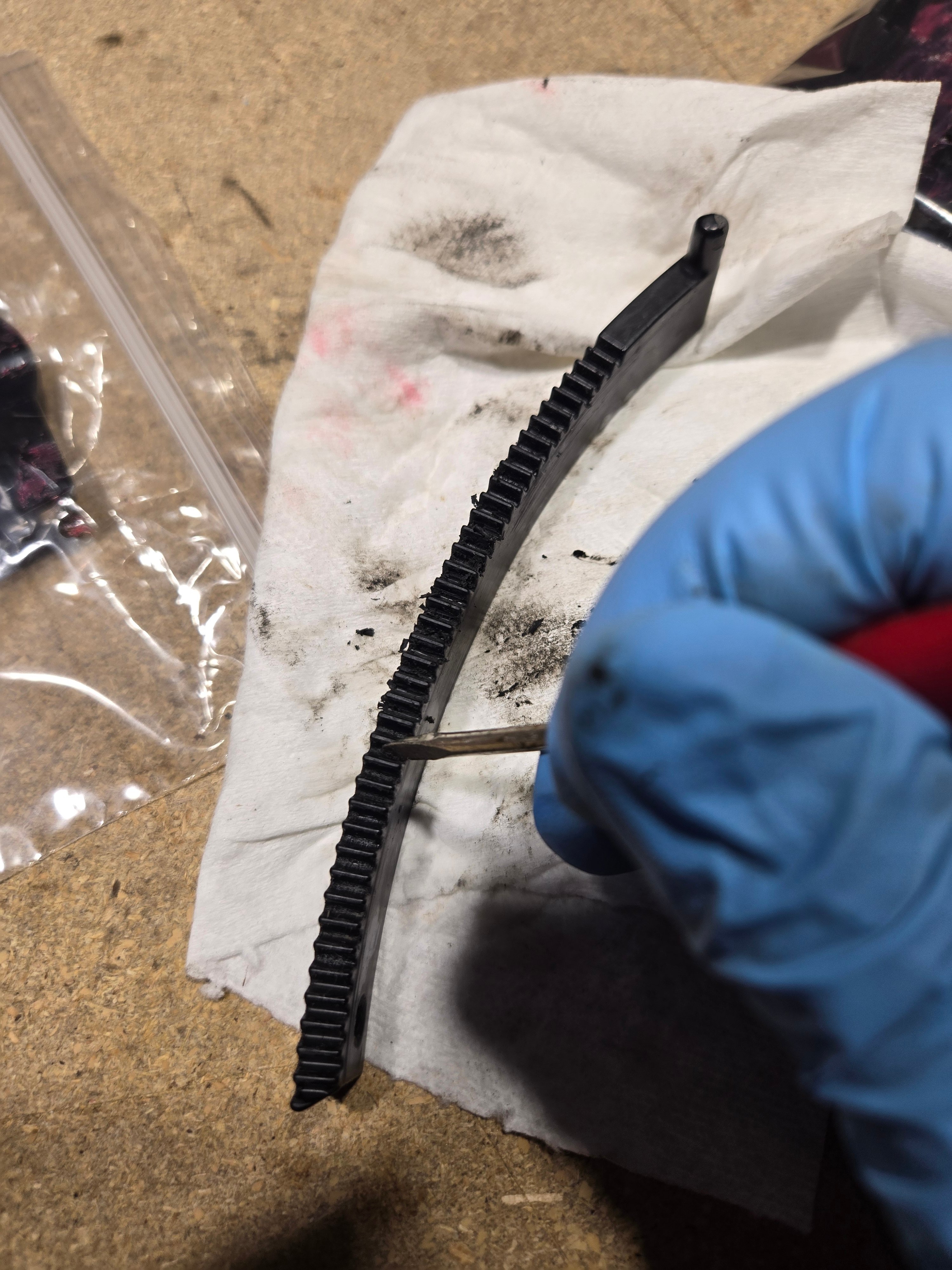

I should have some J-B Weld Original left over from a recent sunroof repair.
There was a threaded insert in the center sunroof tab that looks like it was held in with Gorilla Glue at one point that had failed. The threaded insert had split from the boss on the sunroof; completely pulled out. Repaired with J-B Weld and seems to be holding up OK.

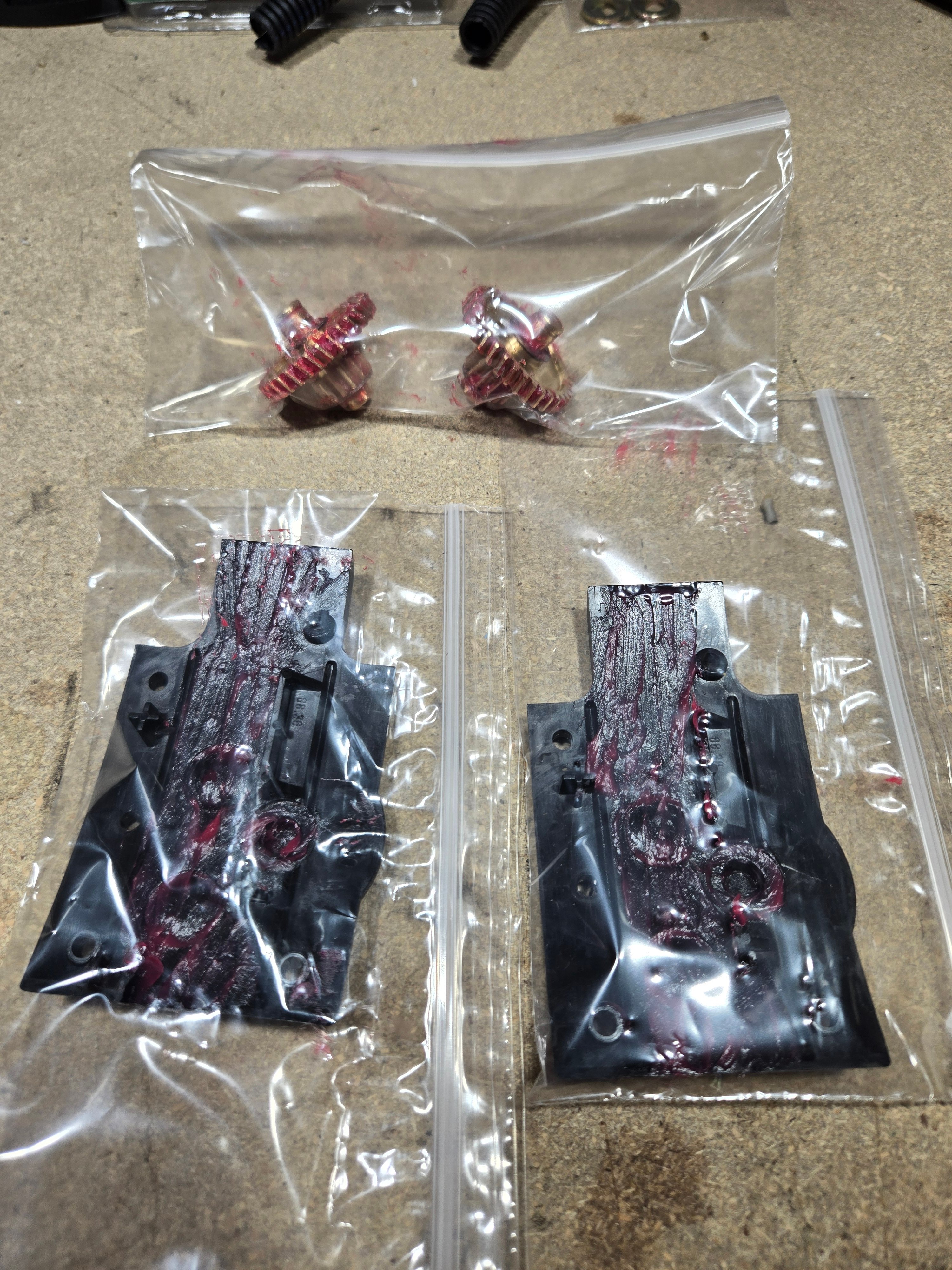

Small progress over the weekend. The rear belt cover has been JB welded, and the sunroof lift mechanisms have been cleaned, greased, and re-installed onto the car.
Next step is to test the sunroof function and clutch adjustment.
Alternator gasket should be in this week so re-assembly of that and the belts can start.

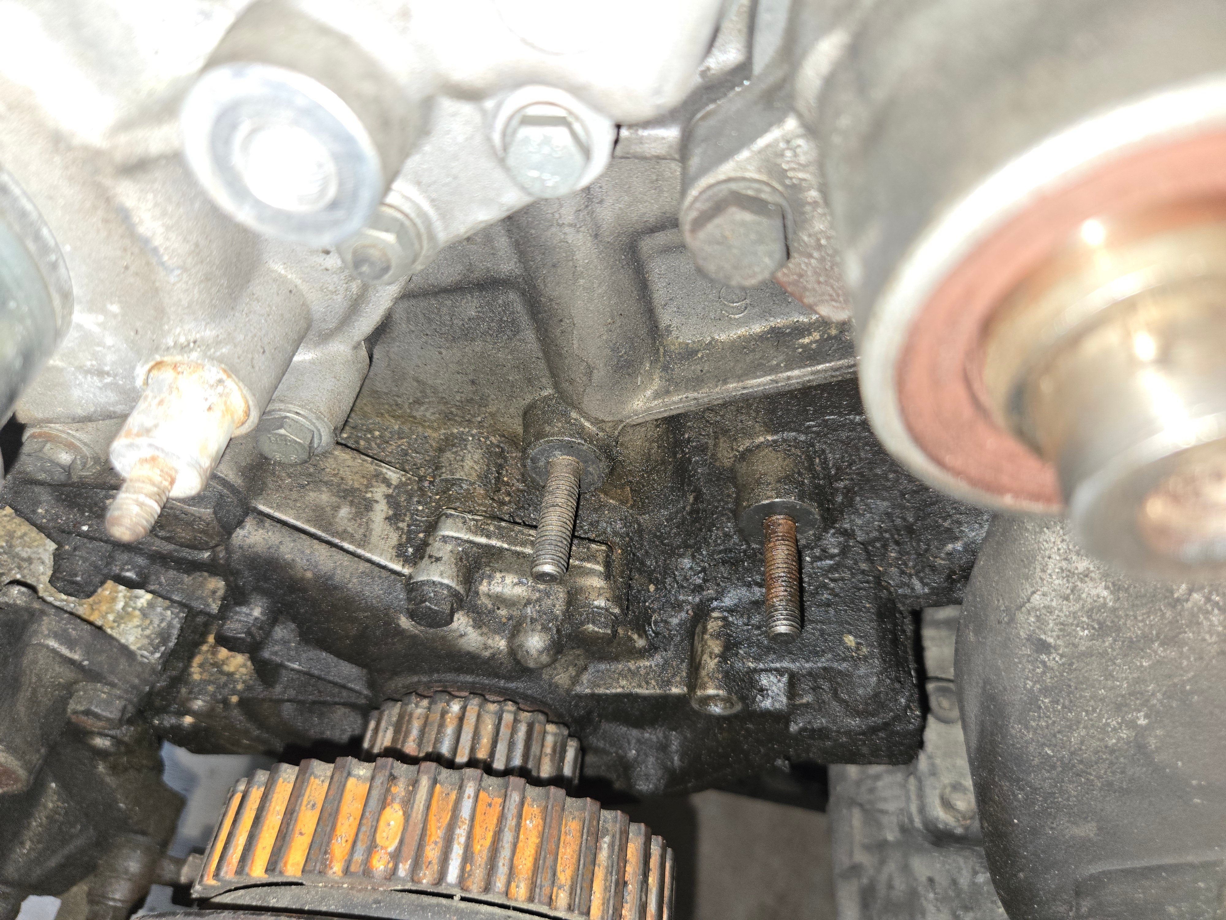

There is significant build-up on the engine near the crankshaft pulley. I knew this engine bay was a filthy mess before this teardown began but underestimated just how bad it was.
I think at this point I should replace all of the front seals while I'm in there rather than clean up the grime and re-assemble to try and find the source of the leak and have to tear down again. Maybe after a thorough scrubbing there will be an obvious source of the leak.
