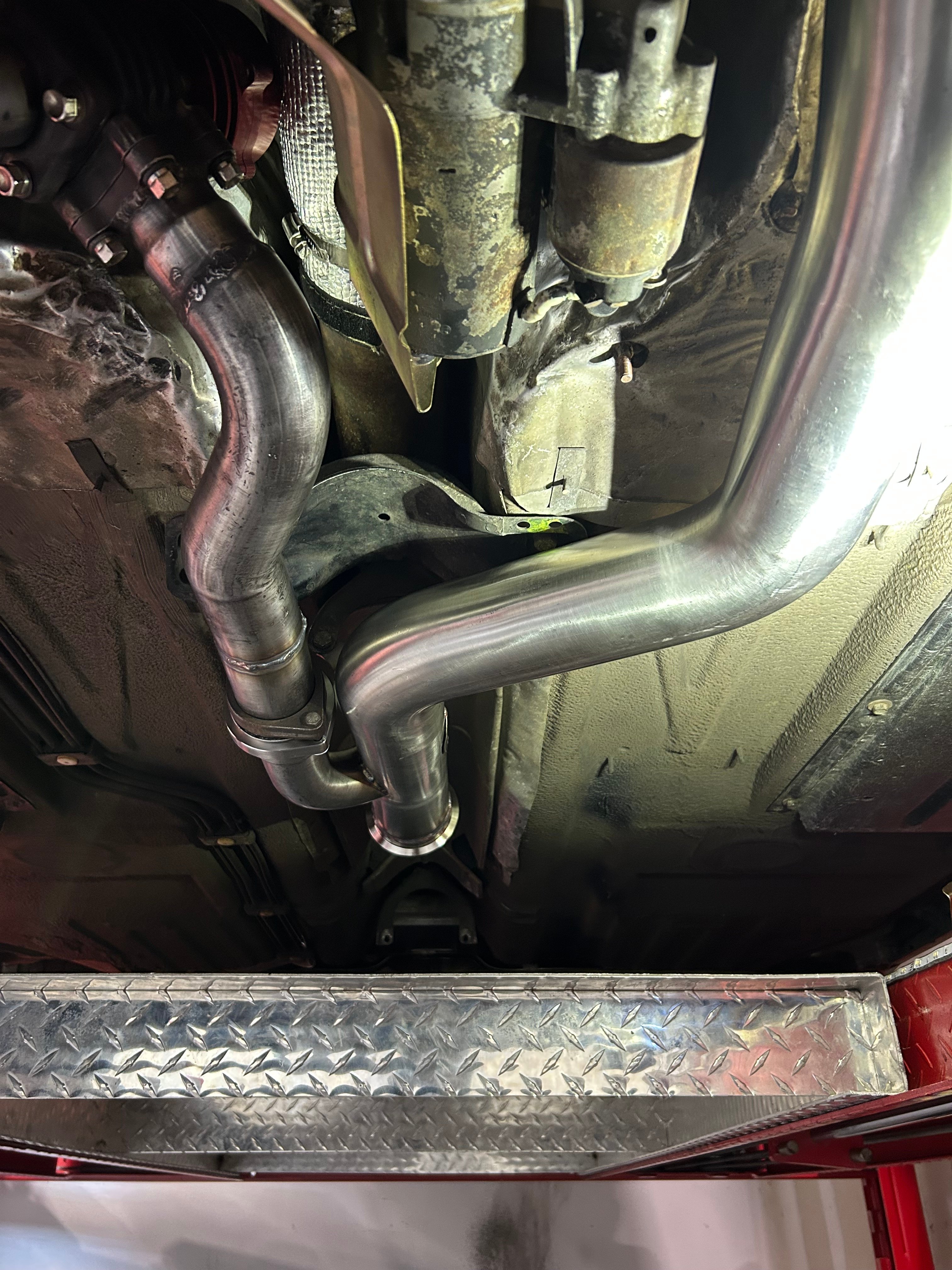

Pictures of my setup below, it seems to be working ok without the brace for now, I could only find a one piece crossover so I had to modify it with a v-band to get the wastegate at the right angle. Generally you go for the spring closest to half the max boost you want to run. Im running 18psi with a 10psi spring

Bergerac wrote: Mon Jul 06, 2026 9:24 pm Pictures of my setup below, it seems to be working ok without the brace for now, I could only find a one piece crossover so I had to modify it with a v-band to get the wastegate at the right angle. Generally you go for the spring closest to half the max boost you want to run. Im running 18psi with a 10psi spring
Thanks, this is really helpful! Factory wastegate and exhaust is out. I will install the TiAL, new exhaust and MBC tomorrow.

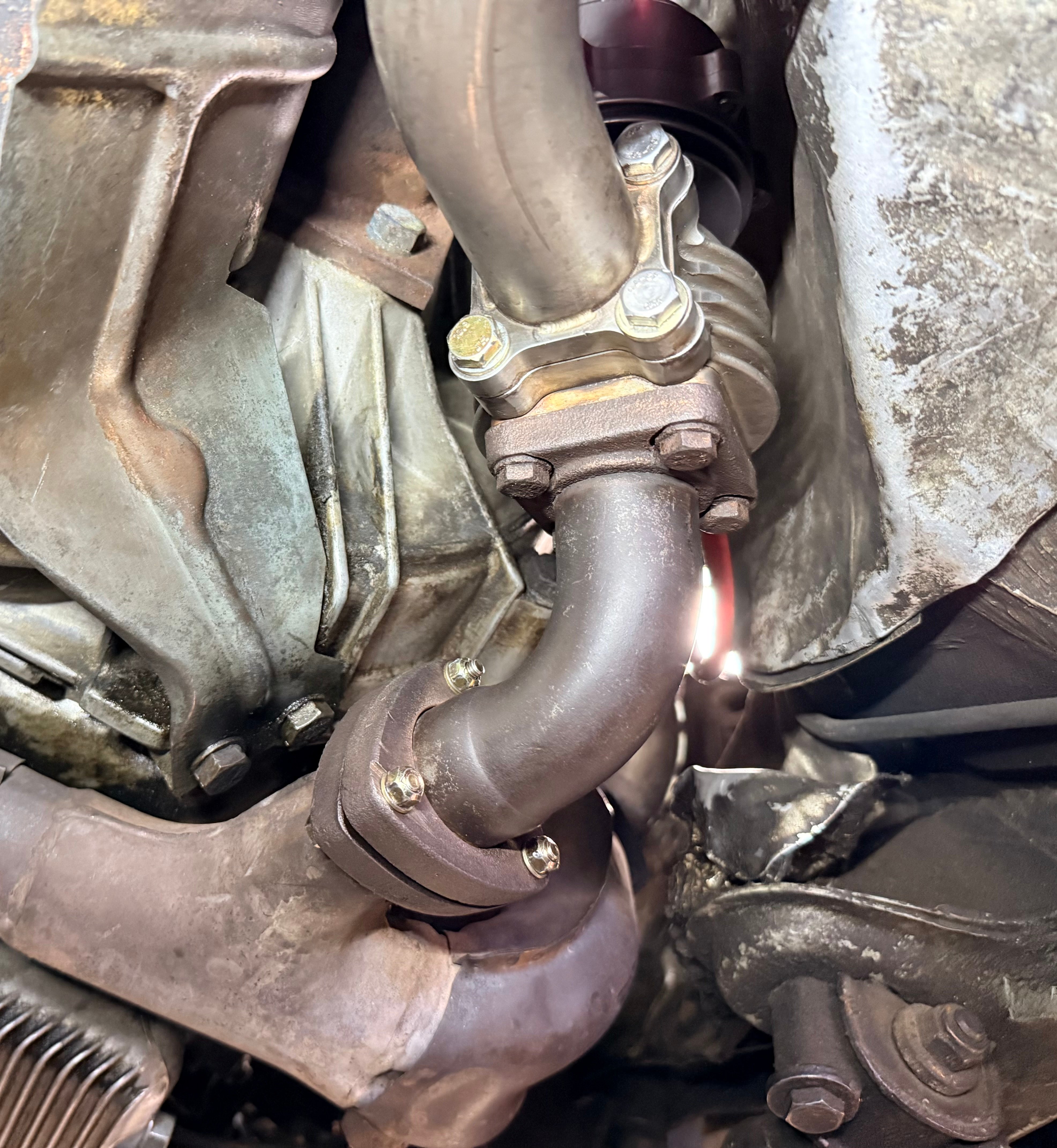

Here is my f46. Been on my car for 15 years and works very well. It is indeed tight but works. The f46 will bolt directly to the stock cross over but requires a custom dump tube.

Black944 turbo wrote: Wed Jul 22, 2026 12:50 pm Here is my f46. Been on my car for 15 years and works very well. It is indeed tight but works. The f46 will bolt directly to the stock cross over but requires a custom dump tube.
Thank you! Meant to update the thread. I got it in and so far so good!
