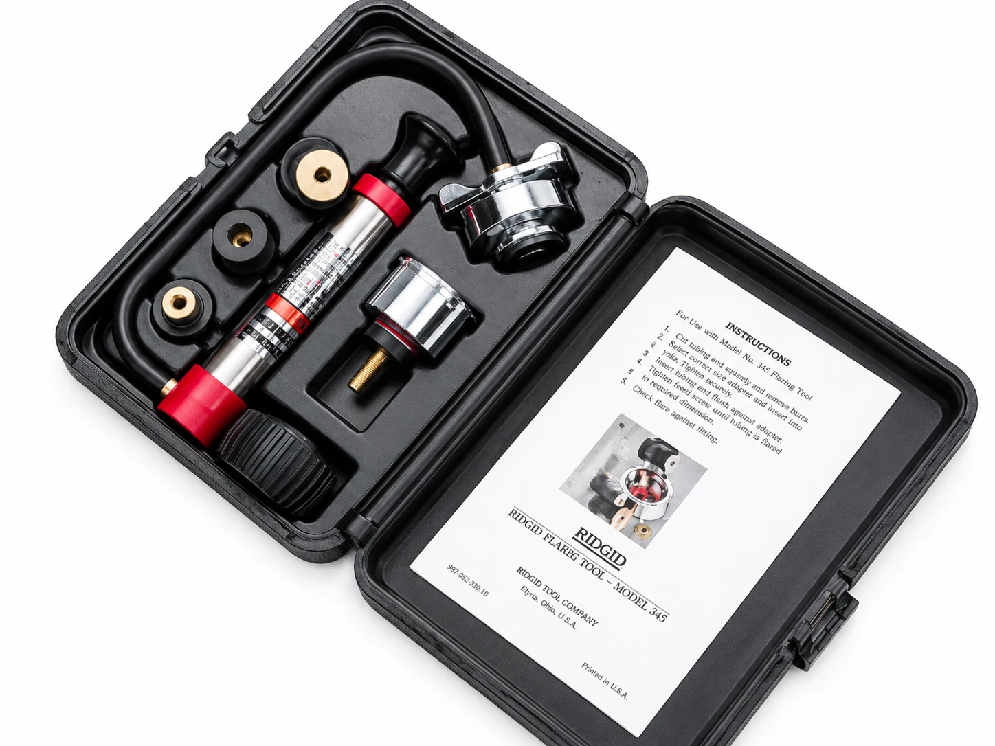

I found this tester on ebay, how does it look?

blade7 wrote: Sun Jul 19, 2026 4:11 am I found this tester on ebay, how does it look?
It looks a lot like mine. I think a lot of those barely-branded tools come from the same design and are made as near-commodities in low-cost manufacturing countries throughout Asia... Impossible to be sure, but I'd say there's a 73.47% chance it'll work on the 944. :angel:
Also, those instructions have nothing to do with that tool, making me wonder if the image is AI generated....
