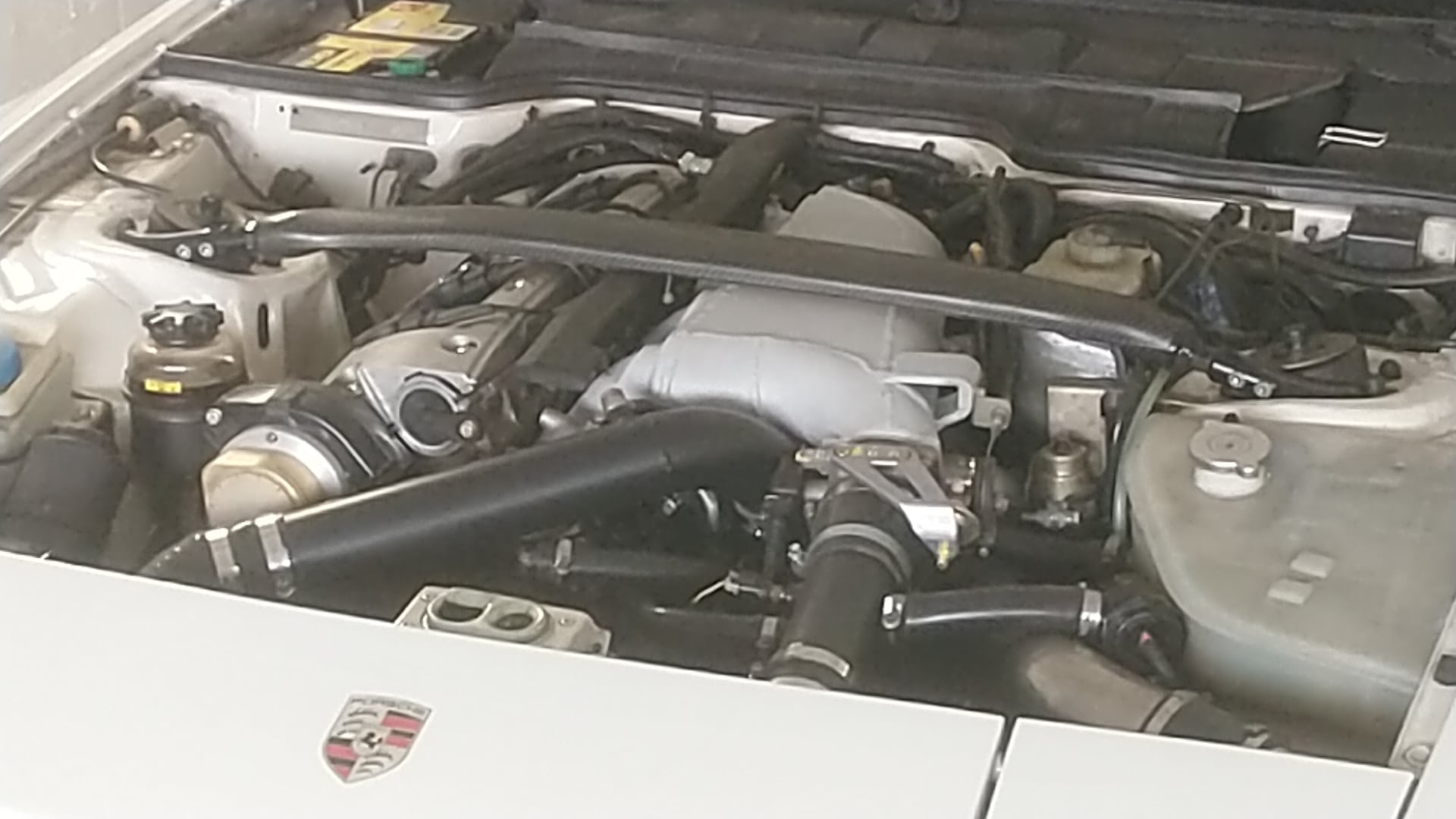

I have finally found a clamp that's strong enough to hold the hose on the intercooler inlet. Man how fast that car is at 24 psi and part throttle only, to the point of not feeling brave enough to floor it.
With the larger turbo and the binary, not progressive clutch disc it is the polar opposite of what it was with the smaller turbo and 930 clutch disc, an apparent relaxed drive that requires composed and fully focused (read SLOW) gear changes yet pushes like a rocket once the torque wave kicks in. The ultimate high speed cruiser. It may seem odd as described and it took a while to get to grips with it but this is a one way ticket to relaxed, unassuming performance heaven. With that much punch delivered in such a relaxed manner topics such as pushing the car beyond 6000 rpm tend to become slightly redundant for road use.
Whilst cleaning the hose between the IC pipe and the intercooler inlet with brake cleaner I was struck to feel far less oil contamination than when the catch can was connected to the compressor inlet. Goes on to show and as experienced earlier that the 16V head flows so much that the compressor pulls way too much oil from the crank case with the stock breather layout.

How did you modify the breather to stop it sucking so much oil?Thom wrote: Sat May 16, 2026 10:35 am I have finally found a clamp that's strong enough to hold the hose on the intercooler inlet. Man how fast that car is at 24 psi and part throttle only, to the point of not feeling brave enough to floor it.

I simply removed the hose between the catch can outlet, fitted now with a hose pointing downwards (and tree huggers will appreciate that it has remained dry ever since), and the compressor inlet.
Only mod is the AOS outlet hole opened up to the size of the hose, a straight carry over from the previous 3L 8V engine.

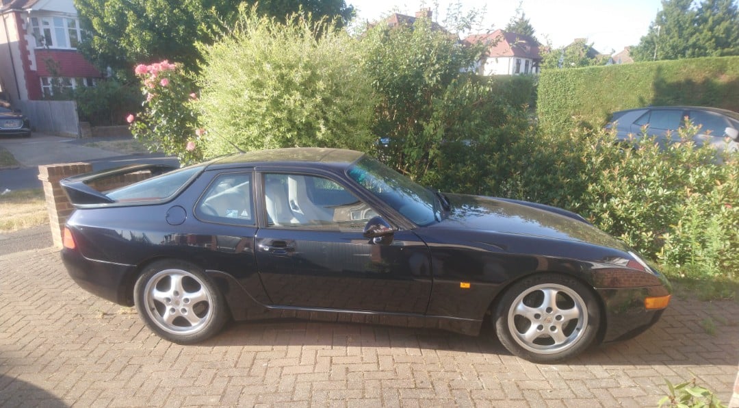

Had the chance to catch up with @nick_968 whilst in the UK who has done a brilliant job smoothening out a few rough edges on his 3L 8V which now runs brilliantly. Quite a task when the short gearing of the 968 gearbox and the limited top end of the 8V head make for a narrow window of turbo choices... With a car that now feels like a factory tune, we can only bowe to you, Sir.

How great is that! There was a time when the three of us had nearly identical motors. I feel like a missed a reunion!
