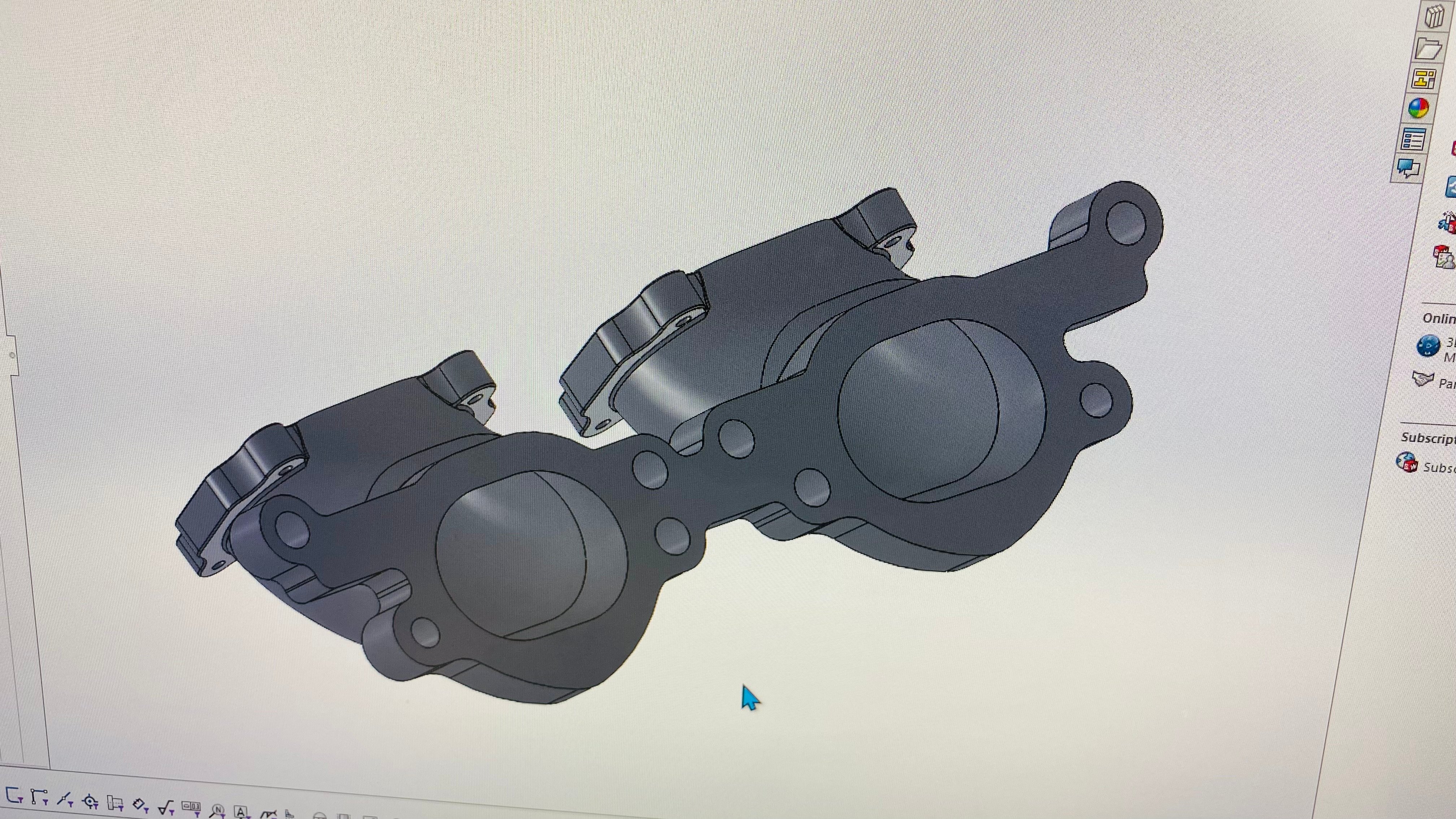

I'd definitely like to see a printed piece. I'm mostly interested in the port shape and size. I could make any changes to the printed piece ports based on past experience and/or flow tests. It could then be scanned for a final design. Here's an issue: At one point I had believed a set of four individual pieces would work with three identical pieces, and one different one. I now realize each mounting needs to be unique due to the bolt spacing and layout, so this needs to be worked out. The manifold could be a total of two pieces with two intake ports on each piece depending on machine capability. A 4V intake gasket shows the bolt layout, although I'd like to change the center 8mm bolt hole.
The 968 has a larger intake port than the S and S2. In the past I had machined all of them for an S/S2 port, and enlarged it for the 968 as needed. Perhaps two different files could be used so that there could be a S/S2 version, and a 968 version (mounting bolts/studs are the same). I supposed this would depend on demand for these manifolds; I don't want to muddy the water. I like the KISS principle.
Once I have a chance to examine the printed piece, I'll assemble questions for Joe and try to make the machining as simple as possible but also ensuring there are no compromises.

Here's an image of the finished piece from long ago. Not sure if I've posted this before.
Gasket is at the shop
Changes being made to drawing
Then 3d print updated version for verification
Pic is original scan
New printed piece will be like gasket
