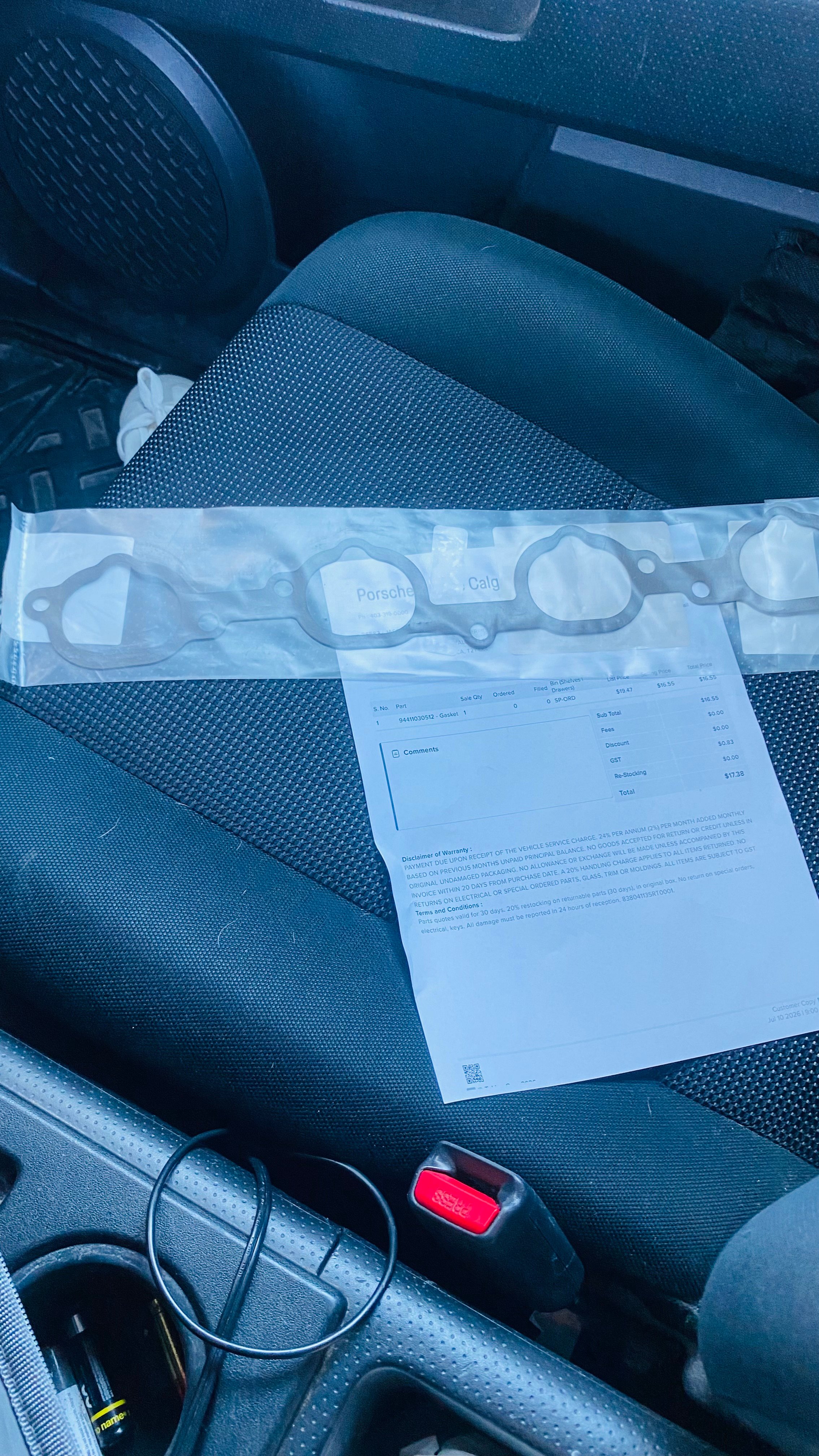

Okay if I get myself a 968 intake gasket that should help. I would need one anyway for a build.
I will call Porsche today.

I just ordered a 968 intake gasket from Porsche
Thanks for the heads up on it being one solid piece
Solves the issue for bolt spacing.
I can’t believe it is a whopping 19$ dollars Canadian
I think that’s the cheapest Porsche part I have ever purchased.
That’s like 5 cents US these days

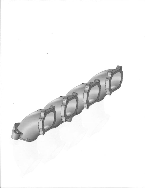

michaelmount123
- Posts: 305
- Has thanked: 26 times
- Been thanked: 180 times
Here's an image of the finished piece from long ago. Not sure if I've posted this before.
