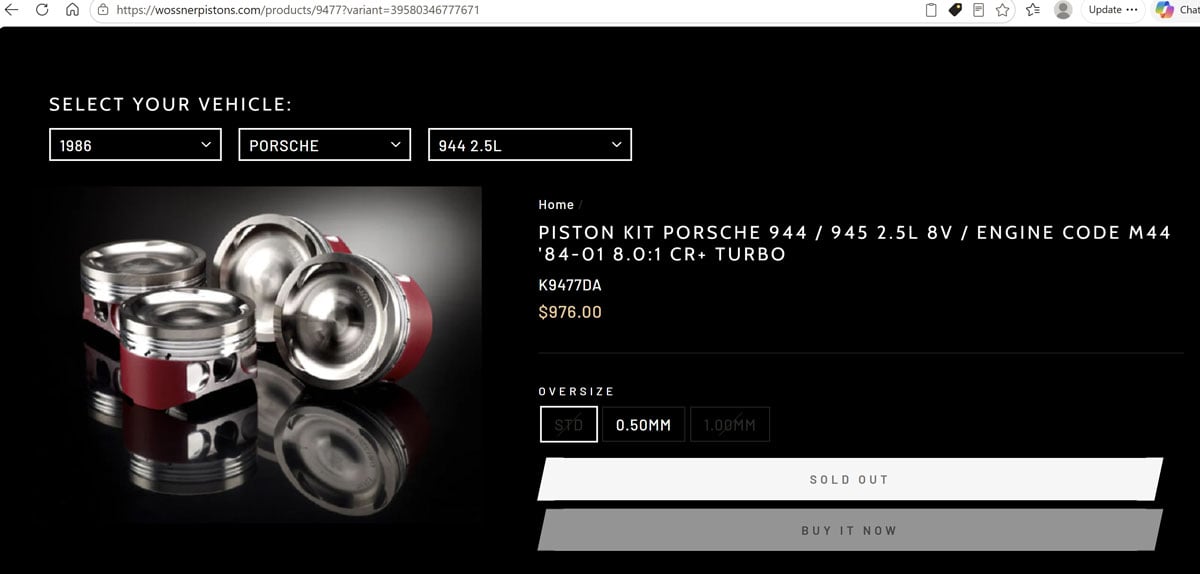

Anyone know what the latest news/ situation is with Wossner Pistons and stock Alusil bores…..Brand new block from Porsche
Mahle only have 100.5mm and 101mm unless anyone knows differently
Thanks
Posts: 9019
Has thanked: 949 times
Been thanked: 4048 times
Putting aside whether they (or anyone else) can make a gall-free piston for Alusil these days, I don't think there is much of a market for standard size pistons unfortunately. They list .5mm overs, but STD say sold out. Love the block though. Maybe custom order from Mahle?

It seems that unless you get something custom you may need to get that brand new block enlarged for the 1st oversize. As i recall @four0four who is also a WA resident, had his done down in Oregon. It sure does look pretty though.
