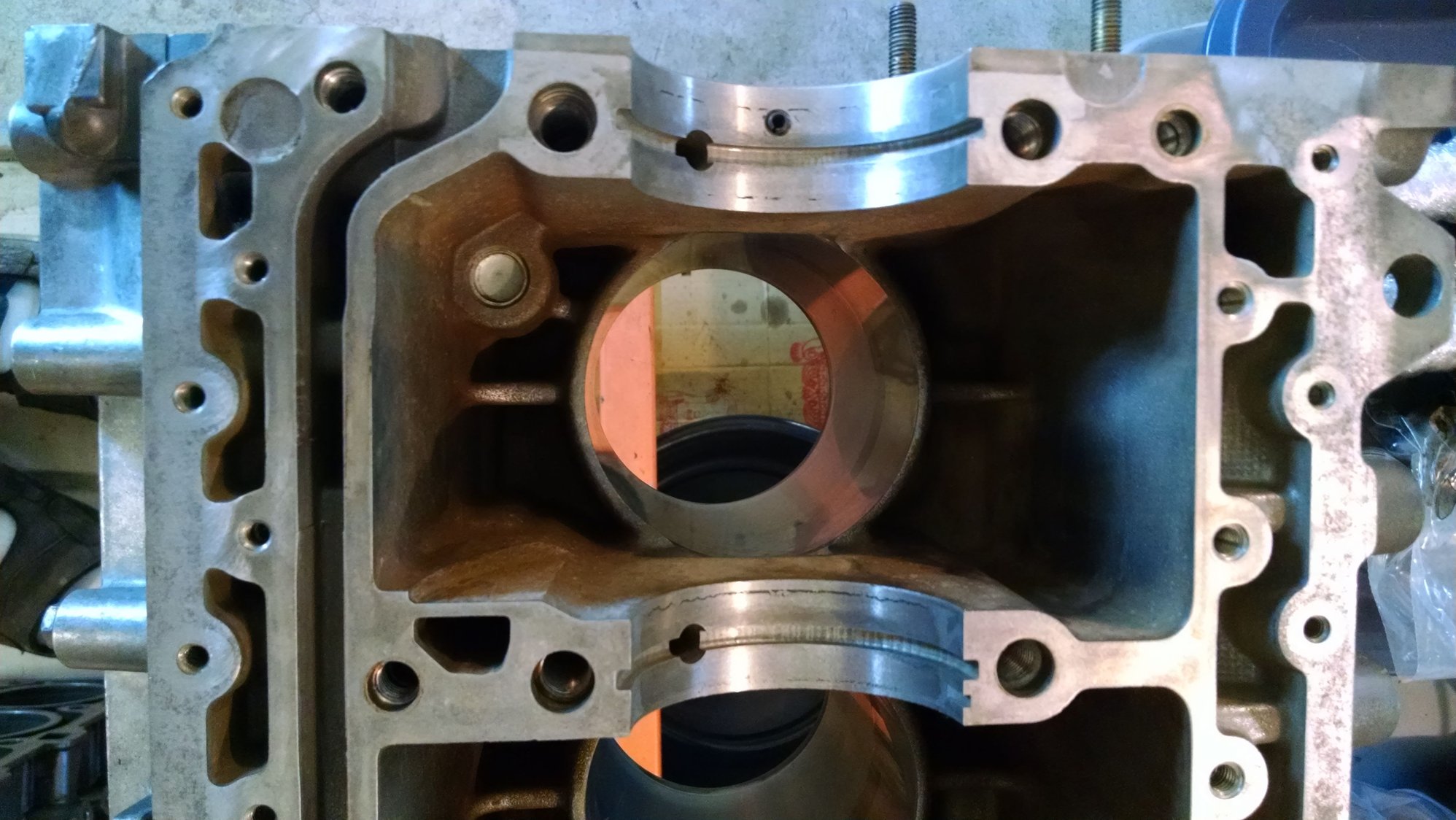

I had a similar problem with a freshly rebuilt motor but in my case, I built pressure for a second and then it dropped and never came back. My issue wound up being a blown freeze plug - specifically the one at the bottom of a cylinder. It must have worked its way loose while the block was getting hot tanked or while it was being machined. The oil pump was just dumping the oil right back into the sump.
Image borrowed from another forum
Other issues could be the pickup tube being cracked, the wrong pickup tube seal, or the girdle having been installed without sealant but I doubt it - LN is pretty experienced.
