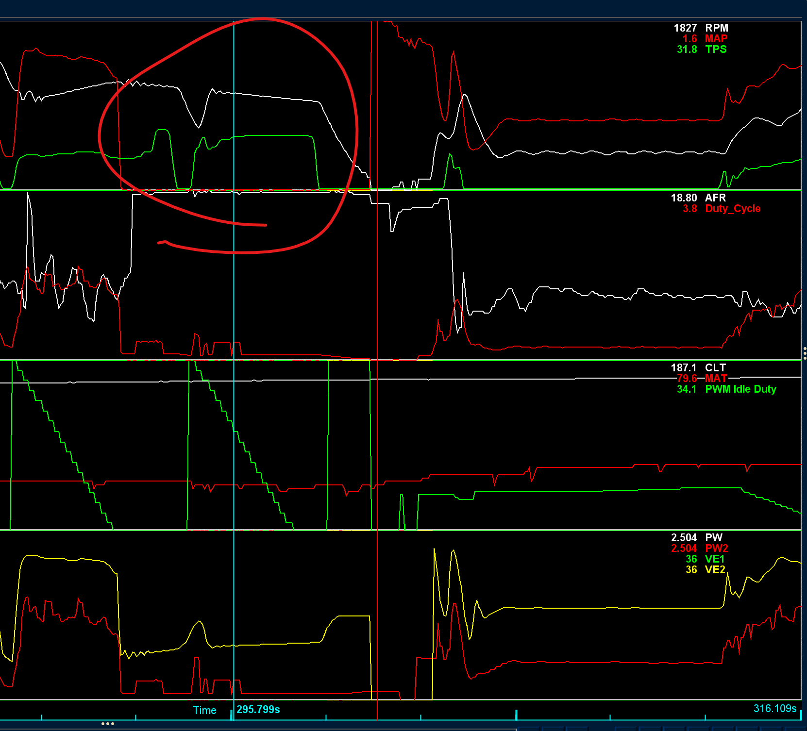

Can someone with a little more tuning experience than me help me with a couple of issues related to my latest tuning log?
About 300 seconds into this, the car stalls while driving. I am not sure what is causing it as things just kind of go crazy at that point in the log.
The car has been doing this lately about once or twice per drive. As I am coasting, I can restart the car and everything will be fine.
Im not sure if it is a voltage issue causing MS to crash, a fuel problem, or what. This entire drive was on the way home from work today and there is another stall a bit later with the same result. So just trying to piece this story together.

A response to my cross post indicates a reset each time of the MS controller. I’ve got to do some investigating. I have lately been messing with accel enrichment, but have always seen a voltage drop at the gauge when the cooling fans kick on. I don’t think the reset is happening at the exact same time but will have to check that.
I’ll keep this thread updated but please let me know if you see anything odd. I don’t think I have AE set quite right yet so would appreciate any comments there as well.

Seems to be quite a few occassions where you MAP sensor is dropping to basically 0 which is dropping you off the bottom of your fuel map. (Injectors duty cycle goes through the floor). No way that should be happening at 2000rpm. Why is your Idle valve cycling like that?
