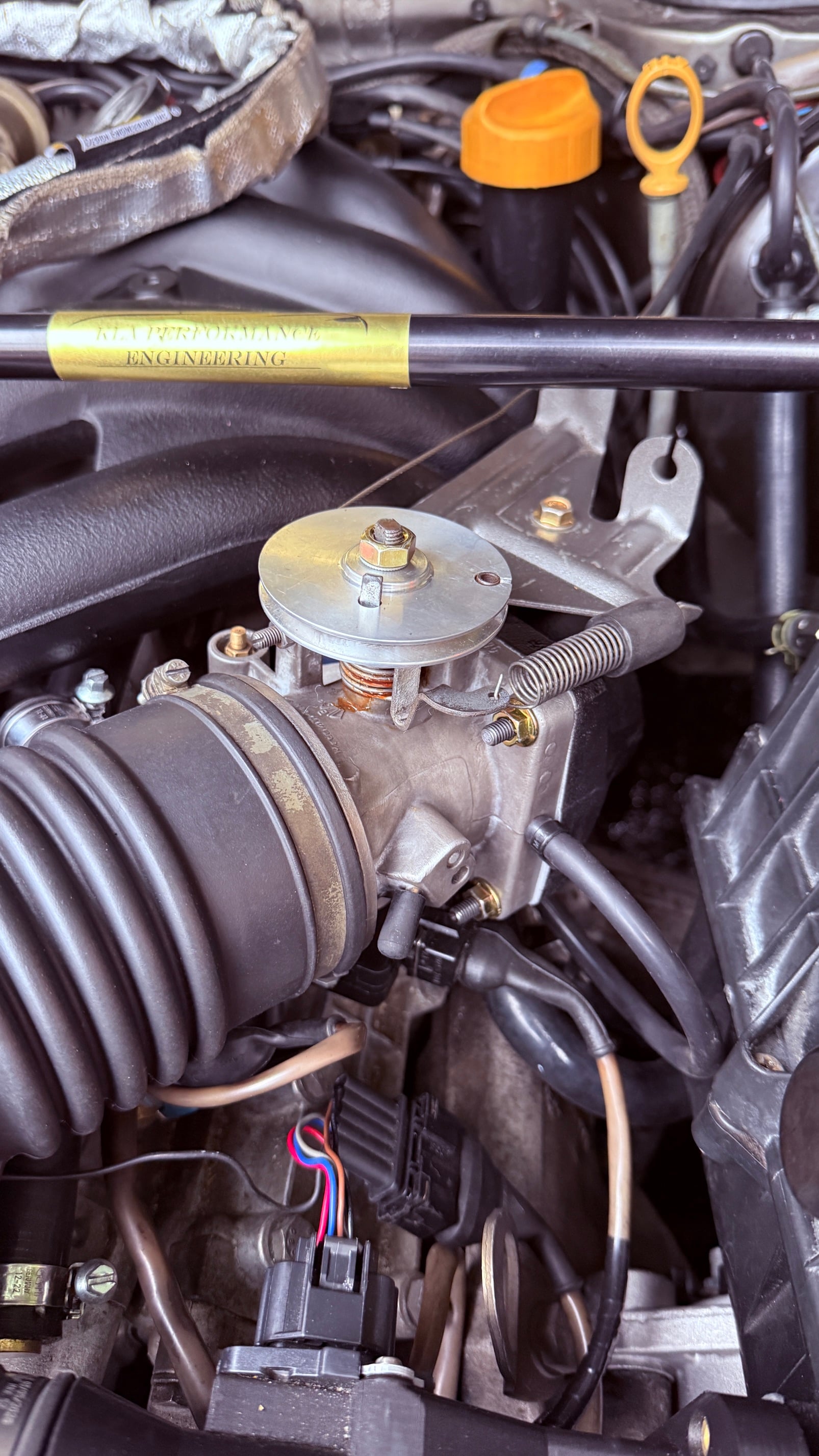

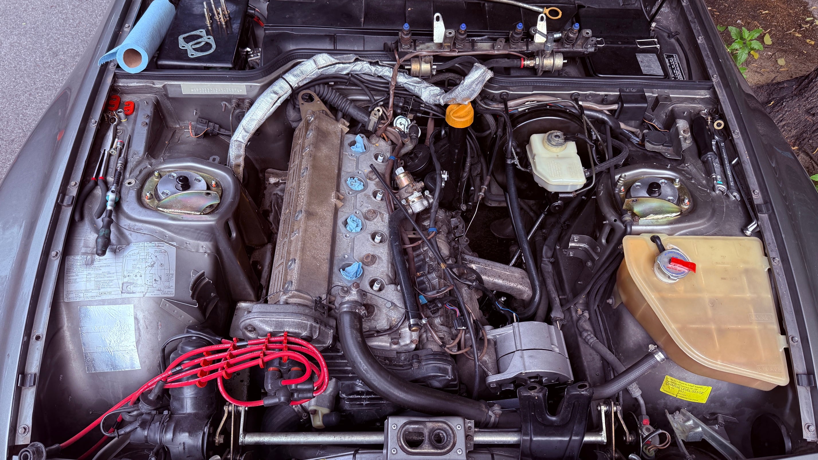

Welllll, after a year of testing and fighting my idle, it was my "aftermarket" Idle Stabilizer after all... Im not sure why I had not come across this advice before last week, but I guess you can test the 3 pins for resistance and they should be relatively close, +/- 2 ohm. So I tested the unit in the car, which I installed last summer, 300/21, eek. I ordered a used original Bosch unit from Plyhammer, 20/22, interesting! Installed it today, the car idles perfectly. I can even adjust the idle bypass.

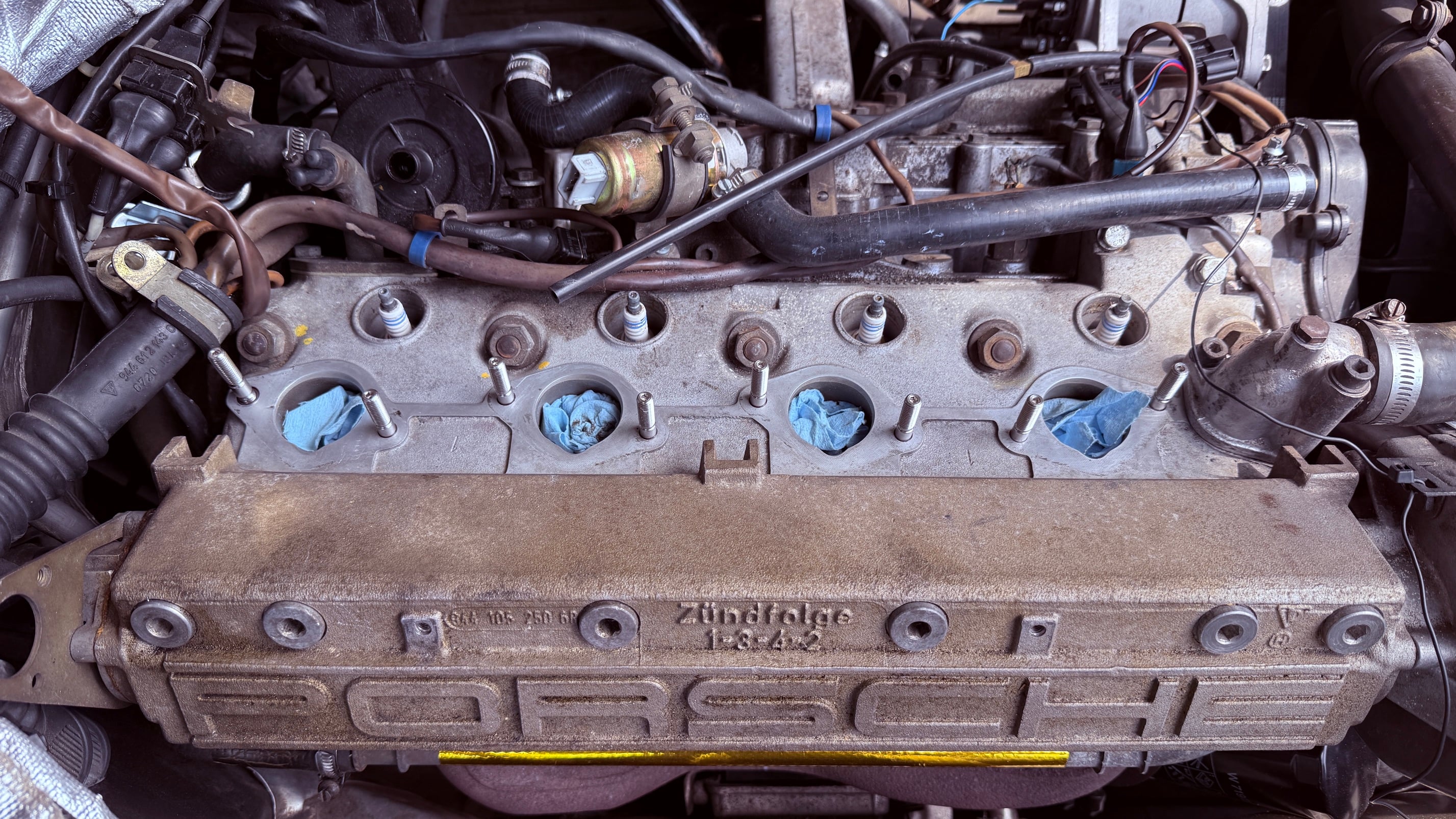

While I was in there, I took the time to finally replace my AOS, which was disintegrating and had me venting it to atmosphere to avoid the vacuum leak. I reinstalled the hose to the jboot. I also installed the manifold stud kit from 944online because last time I pulled my manifold, I stripped one of the holes. Went all out today, chased the threads with a thread cleaner, red locktite, new gaskets.
Finally, a rebuilt throttle body, also with studs.
Curtesy of @rheidtman (Sorry Rick, didnt know your username on here) Thanks for all the help along the way, very appreciative of the Carpoke community and knowledge!
